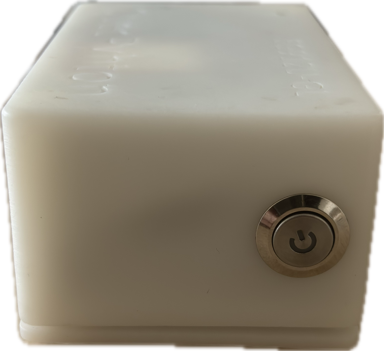

Method 1: Press the power button on the side of the device.

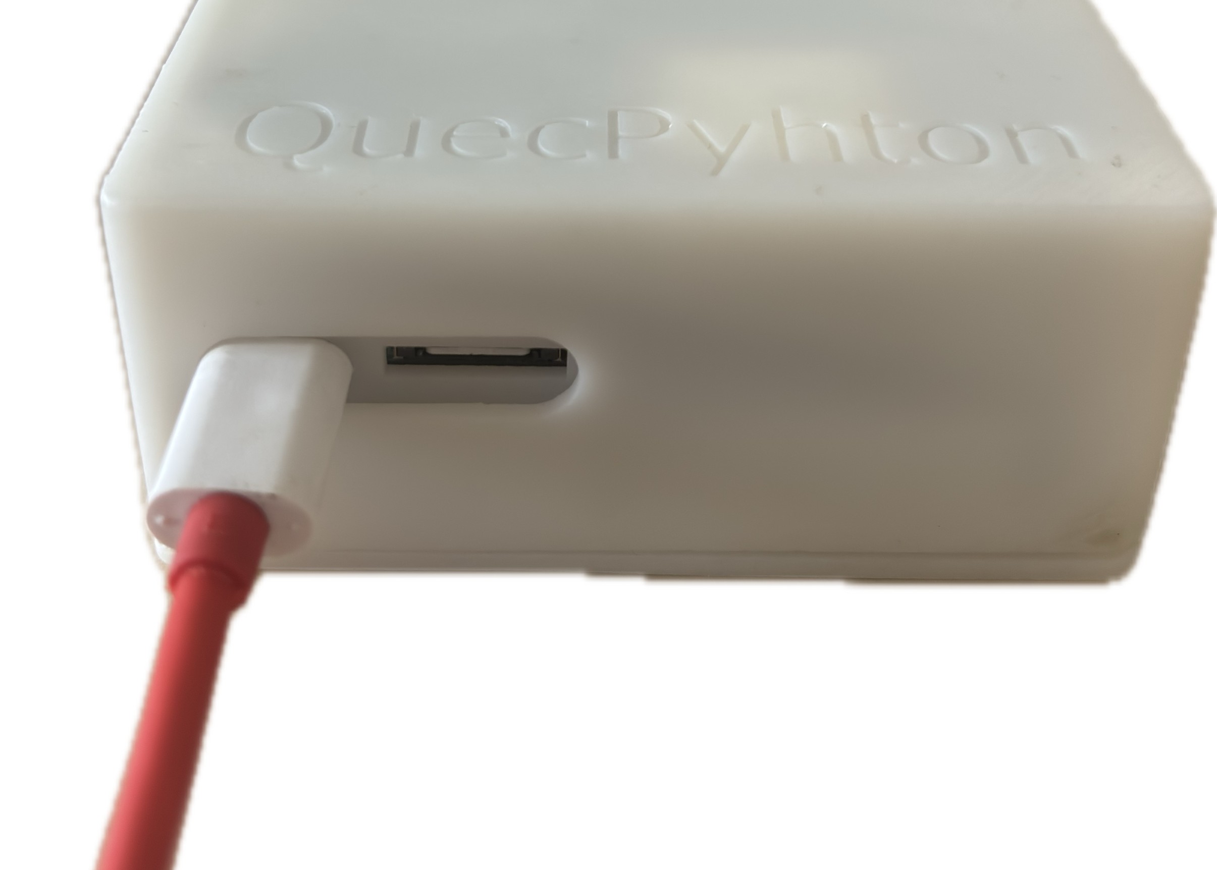

Method 2: Connect the smart tracker to a laptop or power bank using the included USB-C cable, and the device will automatically turn on.

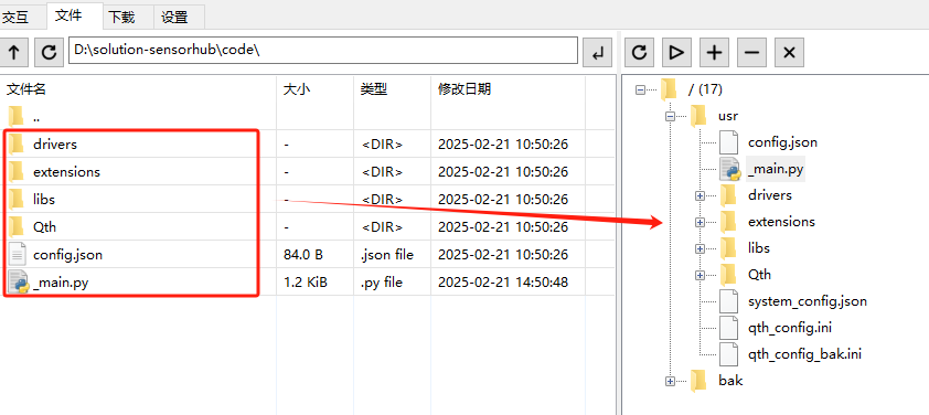

Script import and run
1.Refer to this section to import all files in the code folder under the source code directory into the module file system according to the original directory structure, as shown in the figure below.
2.Refer to this chapter and execute the main program file _main.py.

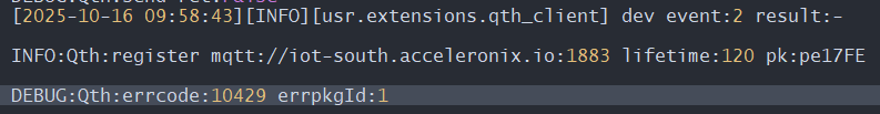

After executing the _main.py script, the program starts running and prints dialing information, including dialing status, IP Address, DNS server address, device number, etc.

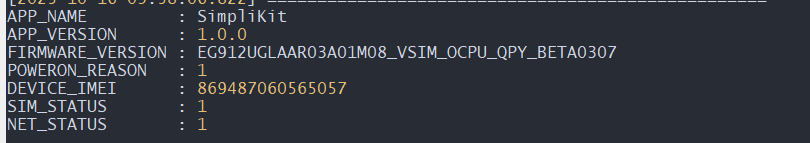

After starting to run, startup information will be printed.

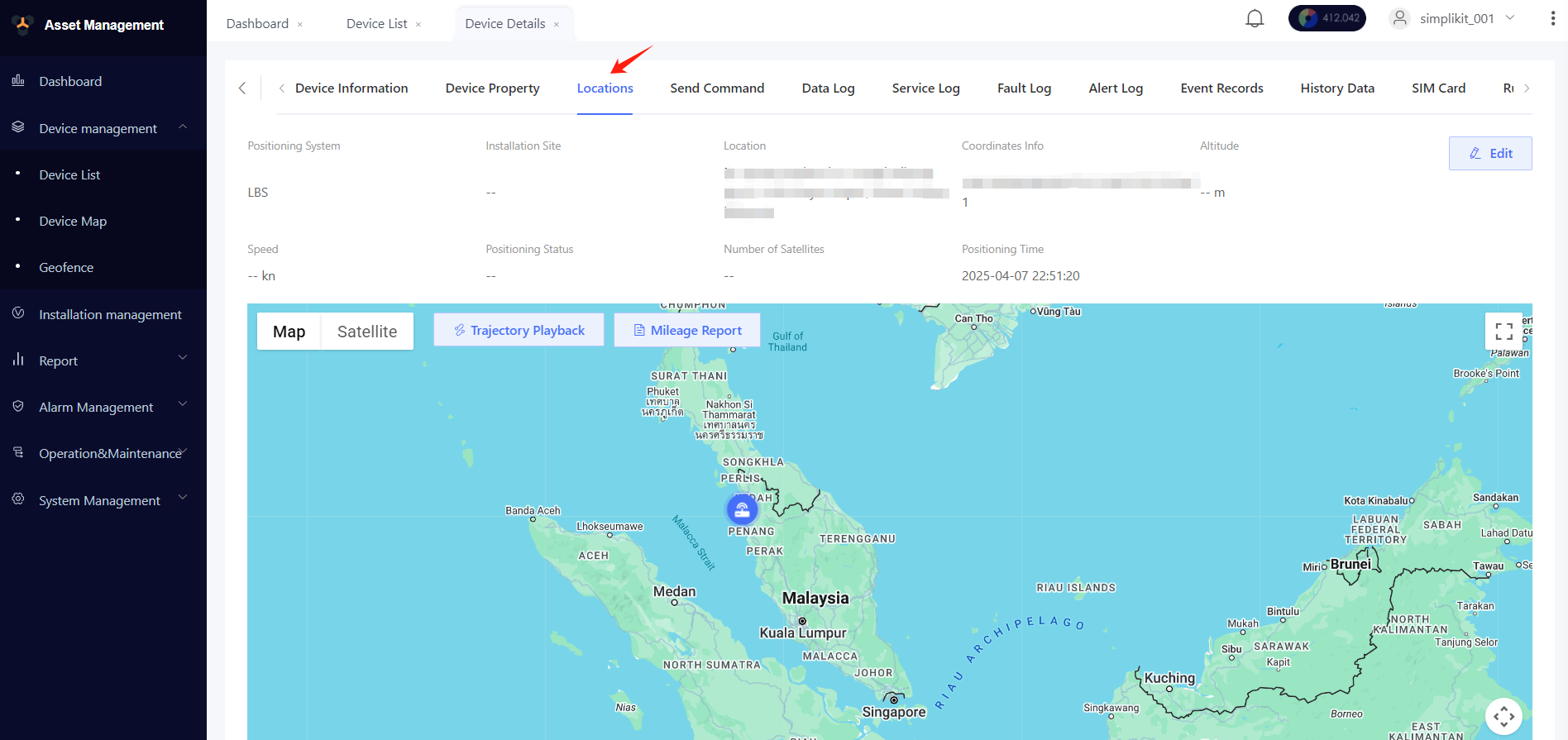

View device location (LBS)
- Click "Details" in the device list to open the device details page.
- Go to the Location tab to view LBS location data.
Note: The location is updated every 30 minutes. If you need to manually refresh it, please click the refresh button in the application control panel, then reload the page to view the updated location.

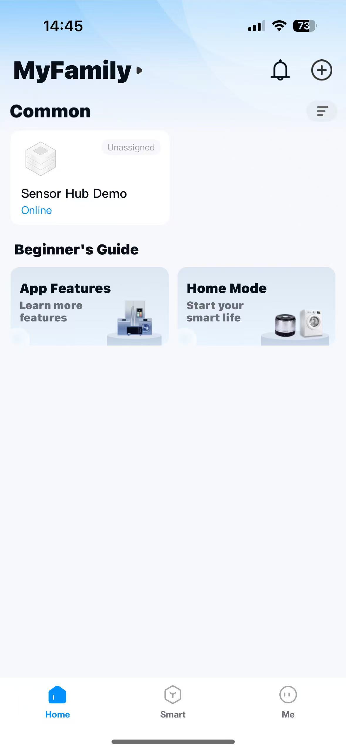

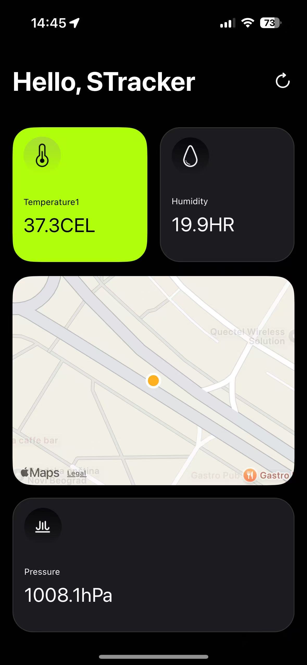

View and manage sensor data
- When the device is online, click on the device in the Wonderfree app to enter the control panel.
- View the real-time sensor data and LBS location data of the smart tracker.
- If you need to update the sensor data or LBS location, click the refresh button in the upper right corner of the control panel.
