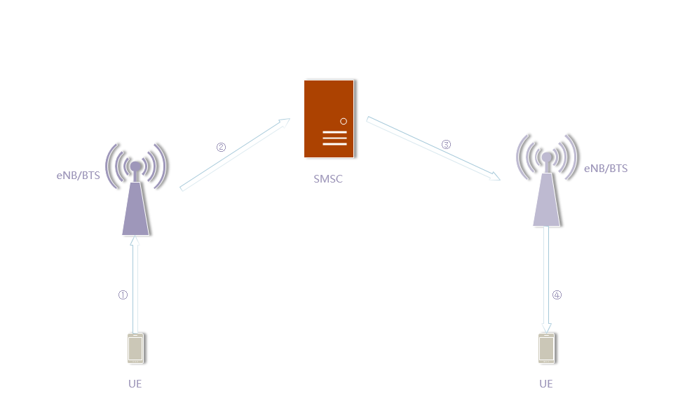

The data flow framework of SMS is shown in the following diagram.
Explanation of data flow:
The sender edits the SMS and sends the message content to the base station through a wireless signal.
The base station receives the message content and forwards it to the operator's SMS service center through a series of network elements.
The operator's SMS service center forwards the data to the base station near the receiving device through a series of network elements.
The base station near the receiving device sends the SMS content to the receiving device.

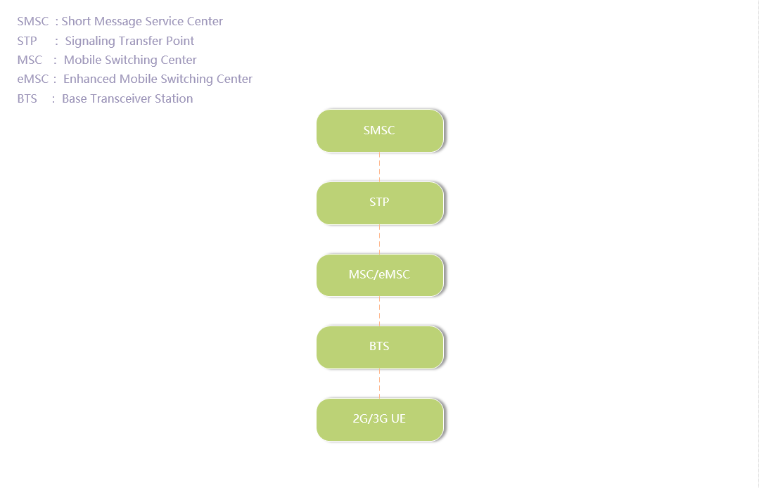

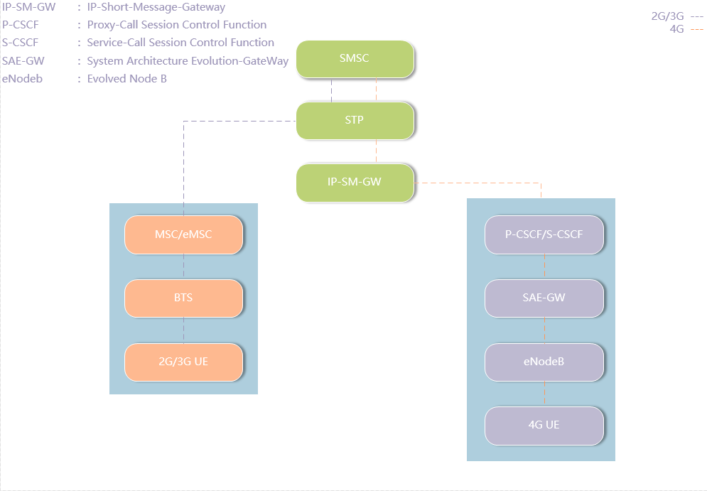

2G/3G Network Architecture
As shown in the figure 2-1 below, in the 2G/3G era, the UE device sends and receives data through a SMS receiver and sender, and the data is ultimately sent to the SMSC to complete the SMS communication.
4G SMS Network Architecture
The current 4G SMS network framework is shown in the figure 2-2 below. The UE sends the SMS data to the eNodeB, and the eNodeB sends the SMS data to the SMSC, which then sends the data to the receiving end. The difference between the two is that the 2G/3G and 4G network elements and network structures are different. The 4G network elements and network structures are more diverse in this aspect, and SMS sending and receiving functions are implemented through the newly added IP-SM-GW network element.

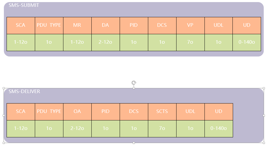

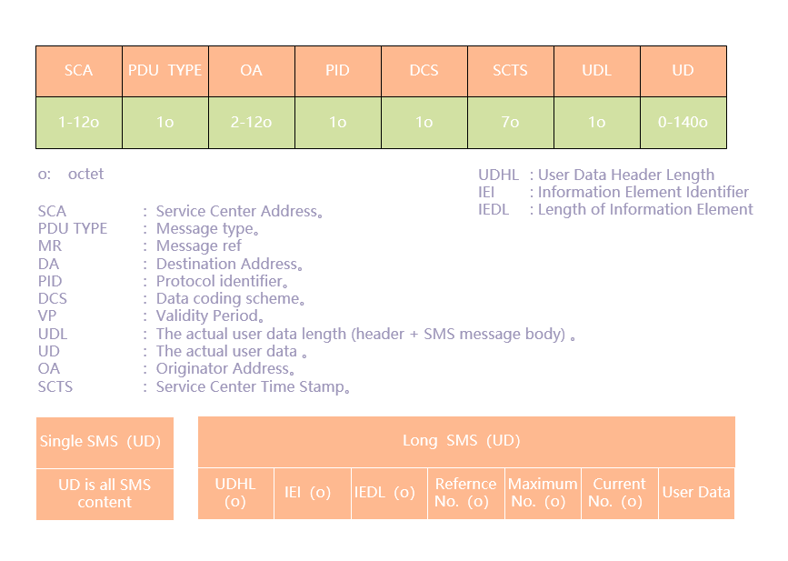

For the Mobile Terminal Device, the focus is on SMS-SUBMIT and SMS-DELIVER. Their structures are as follows:
The common parts of the SMS-SUBMIT and SMS-DELIVER PDU string formats are introduced in 3GPP TS 03.40 Chapter 9. The important DCS (Data Coding Scheme) involves SMS compression, SMS types (four types in total, specifying the strategies for handling each type of SMS by the ME), SMS encoding types (GSM/UCS2), etc. For more information, please refer to Chapter 4 of GSM 03.38.
The following is a brief introduction to the SMS-SUBMIT and SMS-DELIVER types. For detailed content, please refer to the 3GPP TS 03.40 protocol document.

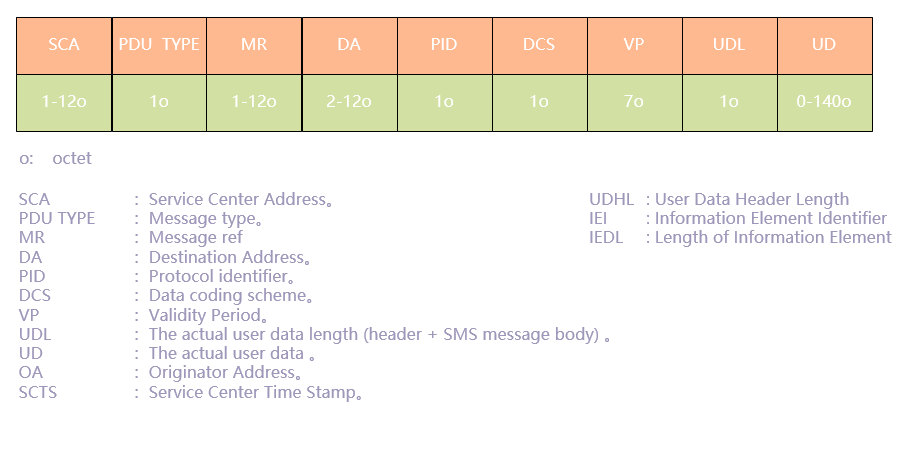

SUBMIT-PDU
The following figure shows the format of the PDU data for sending, and the data can be assembled in the following format. The meanings of the field values can be found in the 3GPP TS 03.40 protocol document. For the issue of user data packets in long SMS UD, please refer to Long SMS (UD) in Figure 2-7. This is already handled at the QuecPython underlying level and does not need to be concerned about.

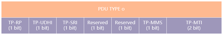

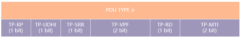

PDU TYPE
For SMS-SUBMIT, the structure diagram of the PDU type is as follows:
- TP-MTI, 2 bits
- Indicates the SMS PDU type, such as SMS-SUBMIT, SMS-DELIVER, etc.
- TP-RD, 1 bit
- Indicates whether the SMS center should accept or reject the SMS-SUBMIT data when TP-MR and TP-DA are the same.
- TP-VPF, 2 bits
- Validity period format
- TP-RP, 1 bit
- Indicates whether the reply path is set
- TP-UDHI, 1 bit
- Indicates whether the UD contains a header. For UD, a long SMS contains a header, while a single SMS only contains user data.
- TP-SRR, 1 bit
- Indicates whether a status report is required

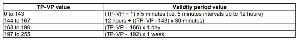

VP
VP represents the validity period of the SMS in the SMS center.
DELIVER-PDU
The following figure shows the format of the received PDU data, and the data can be parsed in the following format. The meanings of the field values can be found in the 3GPP TS 03.40 protocol document.
PDU TYPE
For SMS-DELIVER, the structure diagram of the PDU type is as follows:
- TP-MTI, 2 bits
- Same as above
- TP-MMS, 1 bit
- Indicates whether more SMS messages are waiting
- TP-RP, 1 bit
- Same as above
- TP-UDHI, 1 bit
- Same as above
- TP-SRI, 1 bit
- Indicates whether the SMS status should be replied.
SCTS
- SMS center timestamp, the content format can be found in the 3GPP TS 03.40 protocol document.

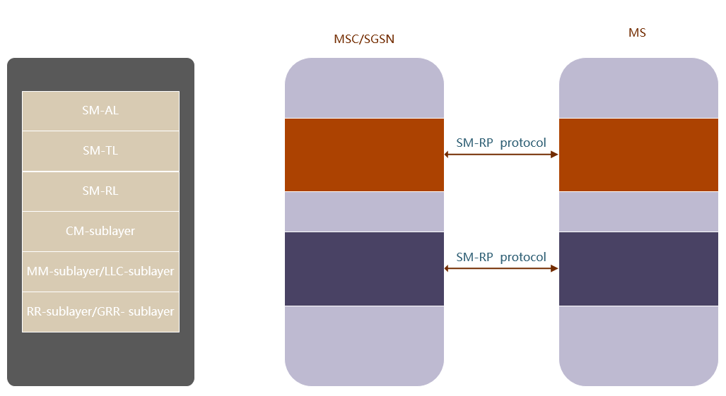

SMS Network Protocol Framework
The SMS network protocol framework is shown in the following figure:
| SM-AL | Short Message Application Layer |
| SM-TL | Short Message Transfer Layer |
| SM-RL | Short Message Relay Layer |
| SM-RP SMR CM-sub | Short Message Relay Protocol Short Message Relay (entity) Connection Management sublayer |
| SM-CP SMC MM-sub | Short Message Control Protocol Short Message Control (entity) Mobility Management sublayer |
| RR-sub | Radio Resource Management sublayer |
| LLC-sub | Logical Link Control sublayer |
| GRR-sub | GPRS Radio Resource sublayer |

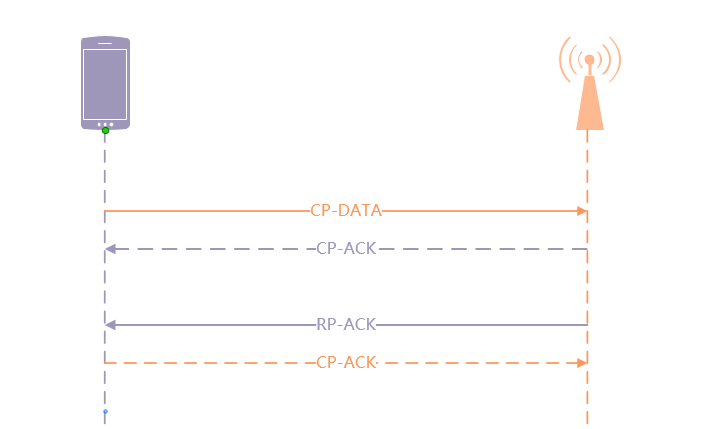

SMS Sending Process
After the user finishes editing the SMS, the SMS data is actively sent by the mobile terminal device, and the network layer replies with CP-ACK, followed by RP-ACK, and finally the mobile terminal device replies with CP-ACK.
As shown in the following figure:

def sms_decode_pdu_message(self):
return self.sms.decodePdu(self.message,self.sms.getPduLength(self.message))
def sms_get_message_info(self,index):
:param index :SMS index value
:tyoe index :integer
:return :tuple type
Tuple content:
(message_ref,message_total_num,message_seq,sub_message_data,pdu_tye,sub_message_len)
:message_ref :SMS reference identifier, the same identifier indicates the same SMS
:message_total_num :The total number of long messages for this SMS
:message_seq :The sequence number of this message in the long message
:sub_message_data :The content of this message
:pdu_tye :PDU type, bit 6 indicates whether the user message header is included, required for long messages
:sub_message_len :The length of the content of this message
message0=self.sms.searchPduMsg(index)
self.message = message0
sca_num = int(message0[0:2],16) - 1
data_len = 2
addr_type= message0[data_len:data_len+1*2]
data_len = data_len+1*2
sca = message0[data_len:data_len+sca_num*2]
# The high and low bits of the phone number need to be converted.
sca = self.sms_deal_phone_number(sca)
if sca_num % 2 == 1:
print("Get SCA phone {}".format(sca[:-1]))
else:
print("Get SCA phone {}".format(sca))
data_len = data_len+sca_num*2
pdu_tye = int(message0[data_len:data_len+1*2],16)
oa_num = int(message0[data_len:data_len+1*2],16)
oa_addr_type = message0[data_len:data_len+1*2]
if oa_num % 2 == 1:
oa_num_t = int((oa_num + 1)/2)
else:
oa_num_t = int((oa_num )/2)
oa = message0[data_len:data_len+oa_num_t*2]
oa = self.sms_deal_phone_number(oa)
if oa_num % 2 == 1:
print("Get OA phone {}".format(oa[:-1]))
else:
print("get OA phone {}".format(oa))
data_len = data_len+oa_num_t*2
pid = message0[data_len:data_len+1*2]
dcs = message0[data_len:data_len+1*2]
scts = message0[data_len:data_len+7*2]
data_len = data_len+7*2
sub_message_len = int(message0[data_len:data_len+1*2],16)
#Long SMS
if ((pdu_tye & 0x40 ) >> 6) == 1:
sub_message_head = message0[data_len:data_len+6*2]
data_len = data_len+6*2
# Long SMS user data
sub_message_data = message0[data_len:data_len+sub_message_len*2]
# Long SMS, process the header of the long SMS user message, get IEI to determine the type of SMS, refer to 3GPP TS 03.40 TP-user-data
sub_head_iei = int(sub_message_head[2:4],16)
if sub_head_iei == 00:
# Long SMS
message_ref = int(sub_message_head[6:8],16)
message_total_num = int(sub_message_head[8:10],16)
message_seq = int(sub_message_head[10:12],16)
return message_ref,message_total_num,message_seq,pdu_tye,sub_message_len,sub_message_data
else:
# Other types of SMS
return 0,0,1,pdu_tye,sub_message_len,sub_message_data
else:
# Short SMS
return 0,1,1,pdu_tye,sub_message_len,sub_message_data
