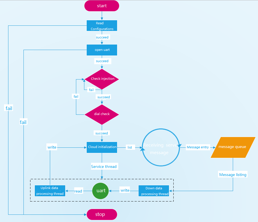

Generally, when one wants to understand a program code, one usually starts from the initial part. Here, we also adopt this approach and first look for the starting point of the program. In this routine, the general program startup sequence is as shown in the following figure:
The overall business can be summarized as the following process:
  1. After the DTU object is initialized, the system configuration is read
  2. Example Initialize serial port peripherals
  3. Checking network status
  4. Initialize the cloud configuration and message queue
  5. Start the data uplink, downlink and downlink service threads
💡 Basic principle: This DTU uses multithreading + message queue to realize upstream and downstream forwarding of serial port and cloud data. The Uplink data thread reads data from the serial port and sends it to the cloud. The Downlink data thread reads cloud data in the message queue and forwards it through the serial port. Message queues are used to cache downlink data from the cloud.
