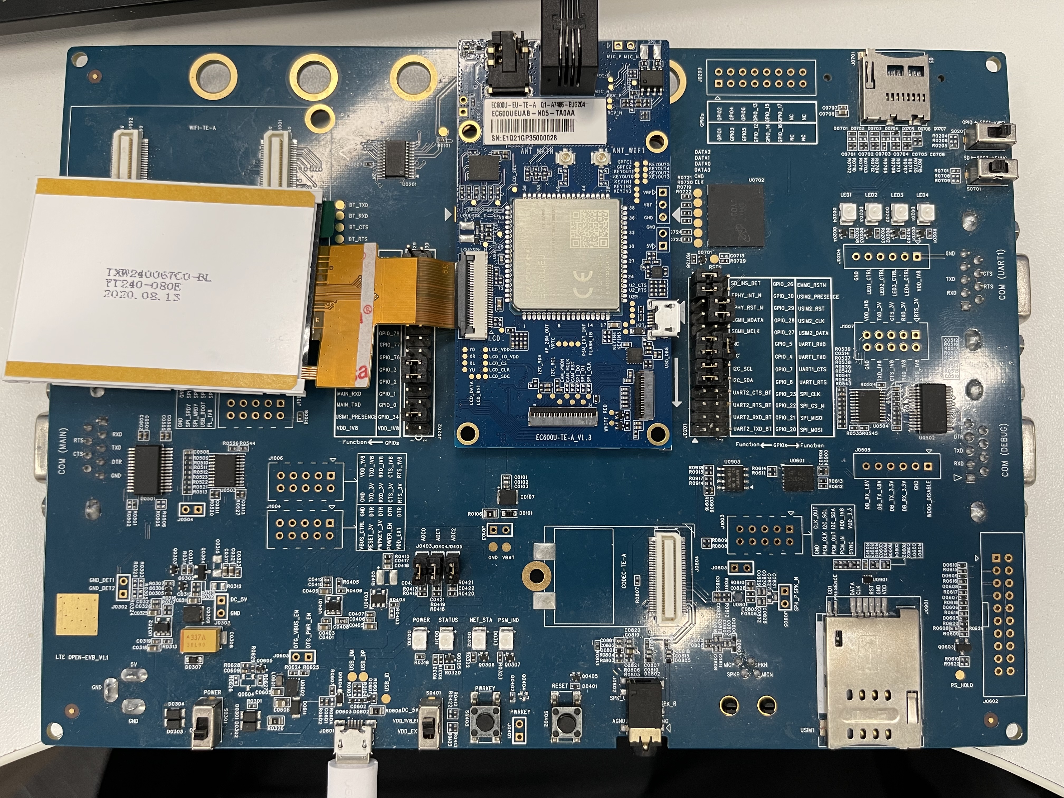

Hardware Preparation
EVB: LTE OPEN-EVB_V1.1 and EC600U-EU_AB TE-A
LCD: ST7789 240*320

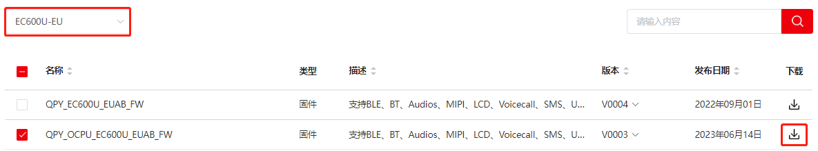

Download Firmware
Please go to QuecPython-Download to download the official firmware for EC600U-EU_AB.
Hardware Connection
Connect the LCD to the LCD interface of the EVB, and connect the EVB to the computer via a USB cable. Long press the "PWRKEY" to power on the EVB, as shown in the following figure.

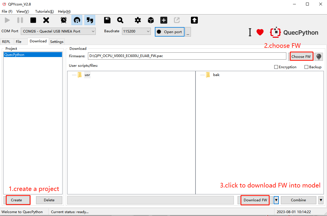

Flash Firmware
Flash the firmware by using QPYcom (Click here to download QPYcom).

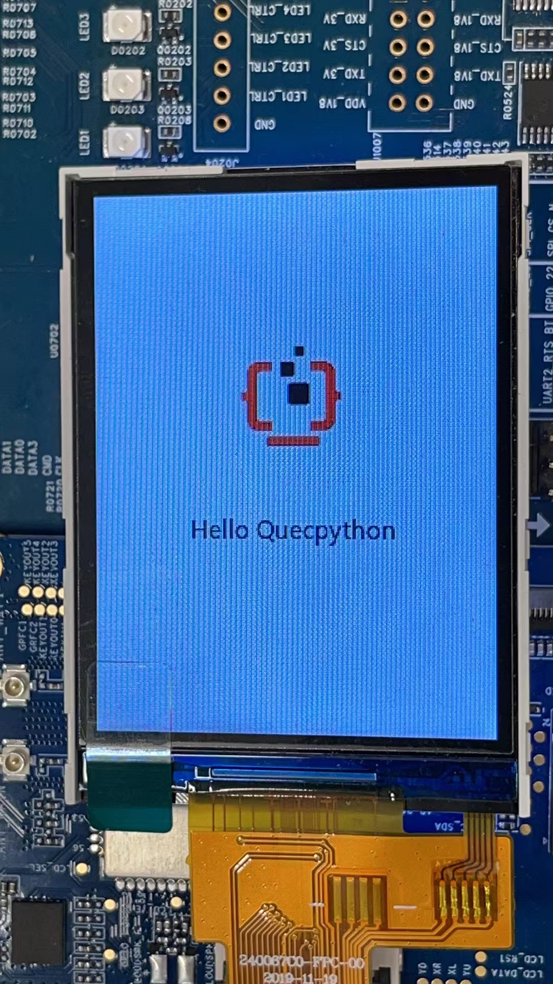

Load Screen
lv.scr_load(screen)
Verification
Download the script to the module and run it. You will see the display interface of the LCD, as shown in the following figure.
