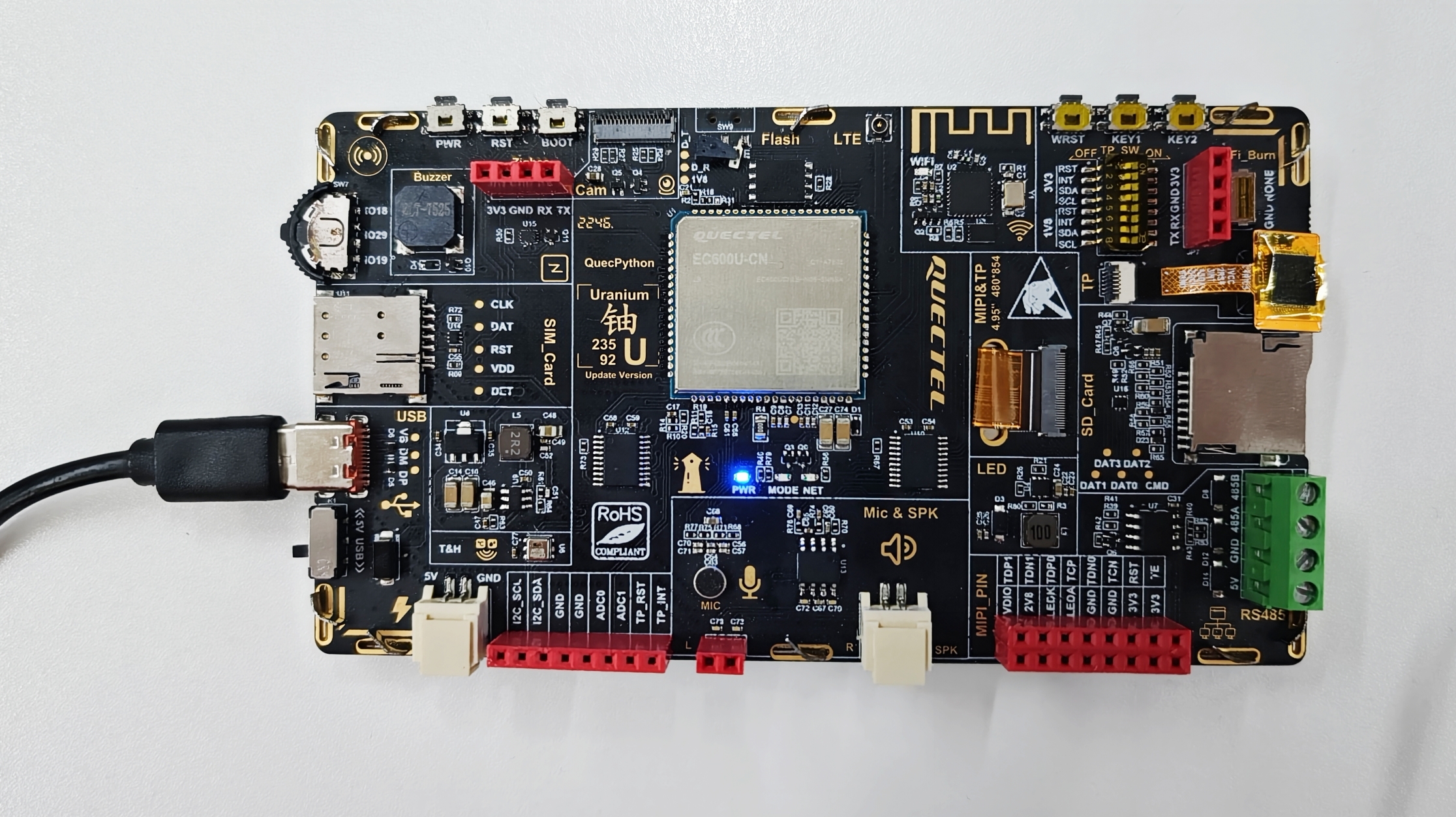

Hardware connection
Connect the hardware according to the following diagram:
Connect the development board and computer using a Type-C data cable.
Equipment development
Power on
After completing the hardware connection, long press the button labeled 'PWR' on the development board until the network light 'net' flashes or a COM port containing the words' Quectel USB 'appears in the port list of the computer device manager, indicating successful boot.

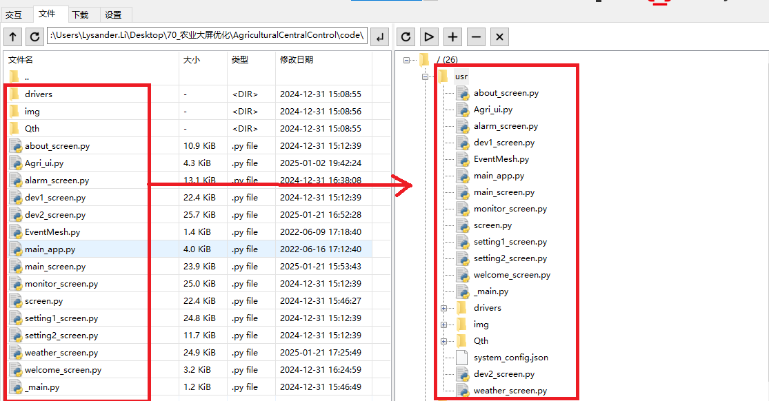

Script import and execution
Refer to this chapter To transfer files between modules, import all files from the
codefolder in the source code directory into the module file system, as shown in the following figure:
·Refer to this chapter Execute the script file and execute the main program file

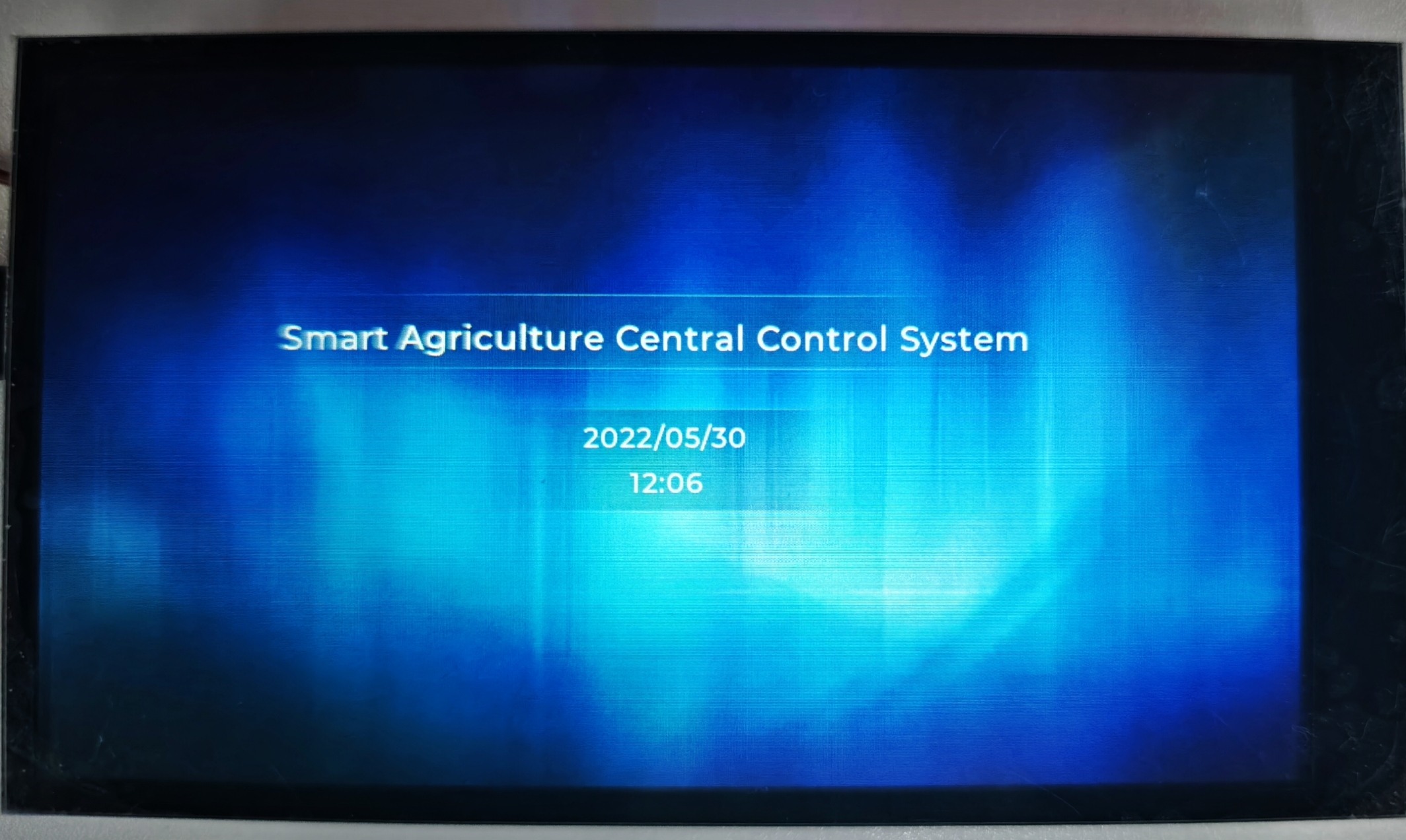

Program startup
After executing main.py, if the program starts successfully, it will enter the welcomescreen interface. After waiting for 2 seconds, it will enter the main_screen screen.

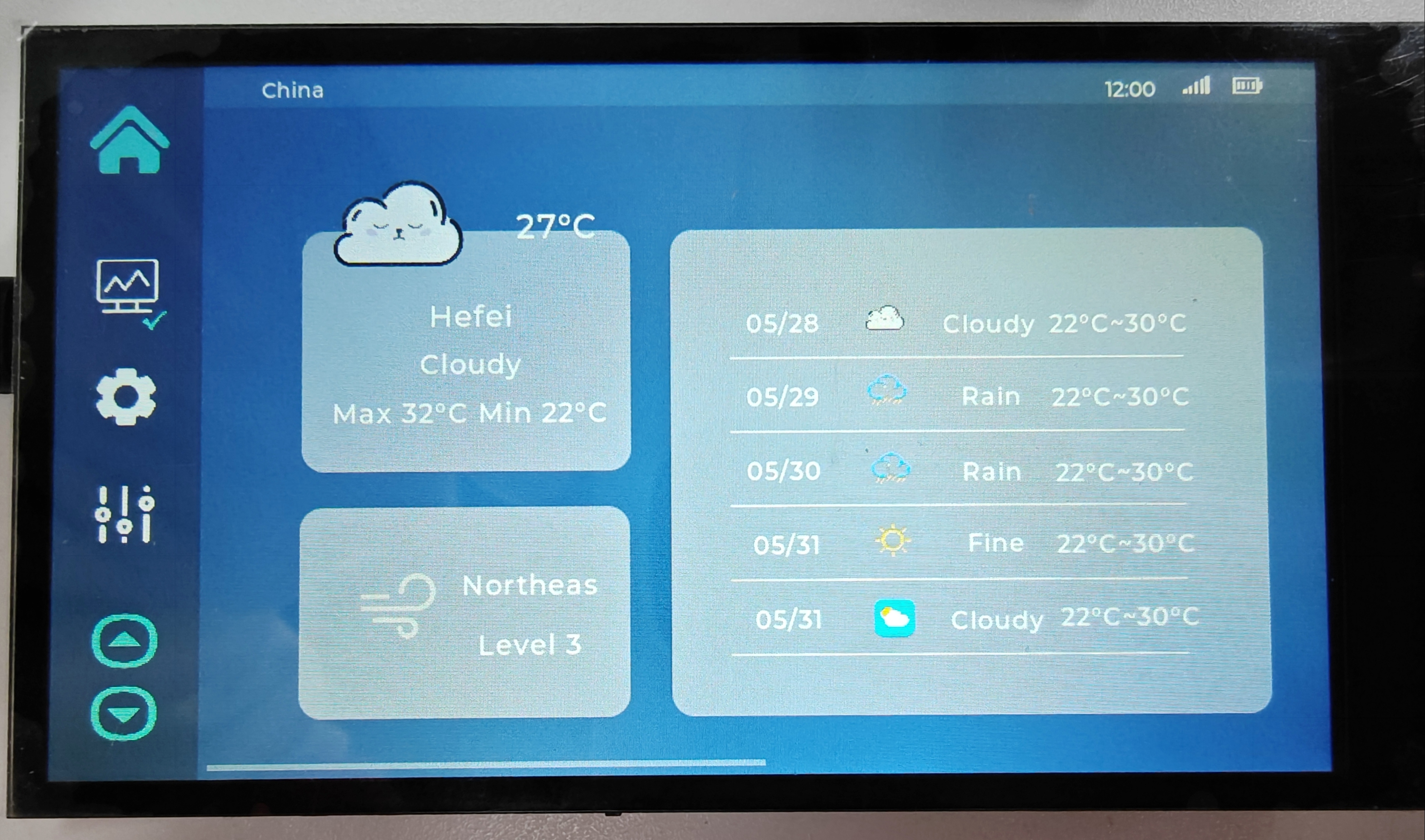

Weather Screen
Click on weather on the main interface to enter the detailed weather Screen
Intuitively display the current temperature, highest temperature, lowest temperature, wind speed and direction of the city, as well as detailed information on the weather for the next five days

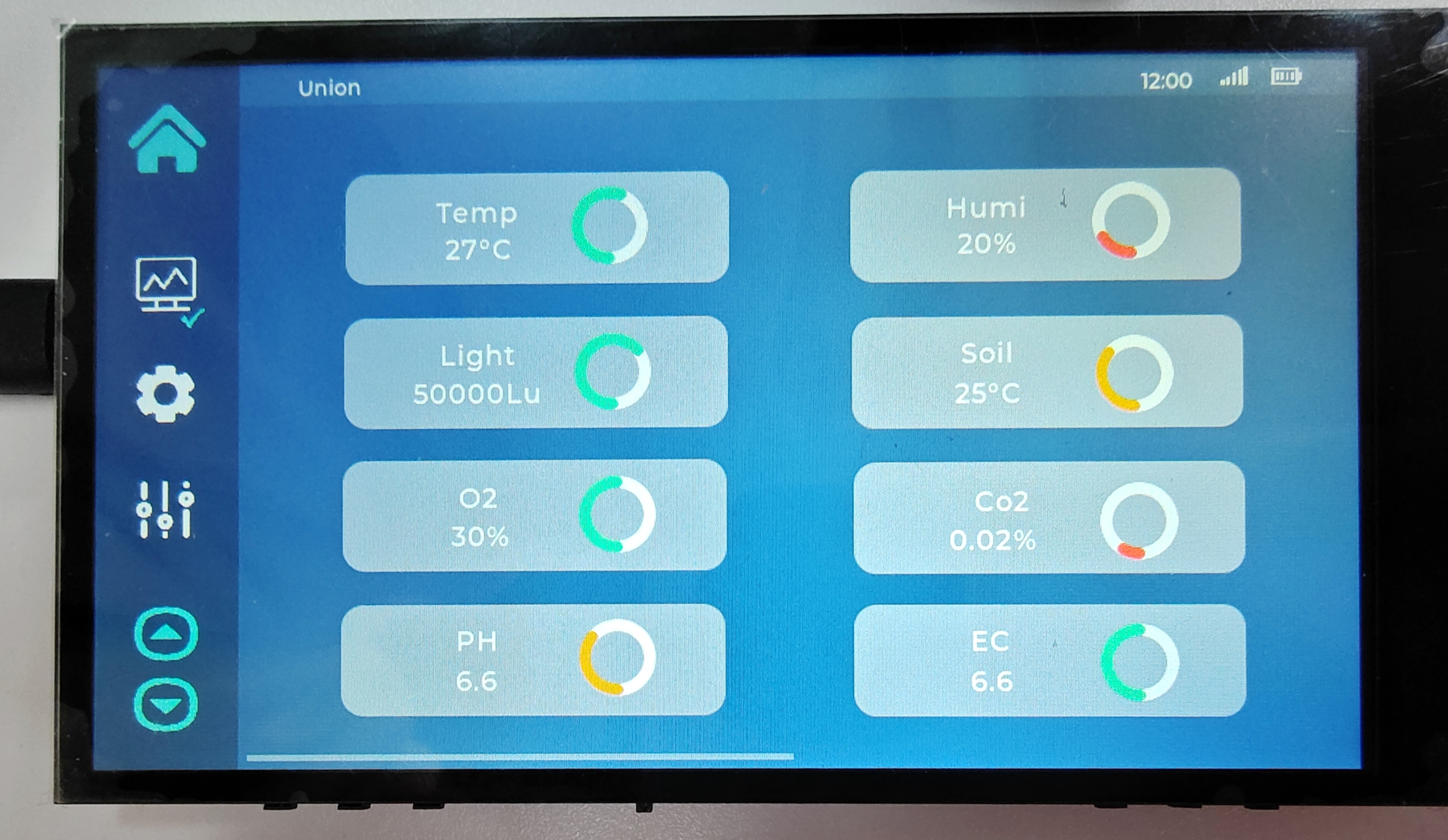

Environmental data display screen
The device status display interface is used to monitor and display the operating status of various devices and sensors, in order to quickly identify any potential problems and take corresponding measures to ensure smooth and efficient agricultural operations. Through such a central control panel, agricultural managers can effectively monitor and maintain key equipment and sensors on the farm, improving overall productivity and reliability.
This interface includes the status of common environmental sensors in agriculture. Including temperature and humidity, care, soil pH value, soil EC, carbon dioxide concentration, oxygen concentration, wind speed and direction, and soil temperature and humidity.

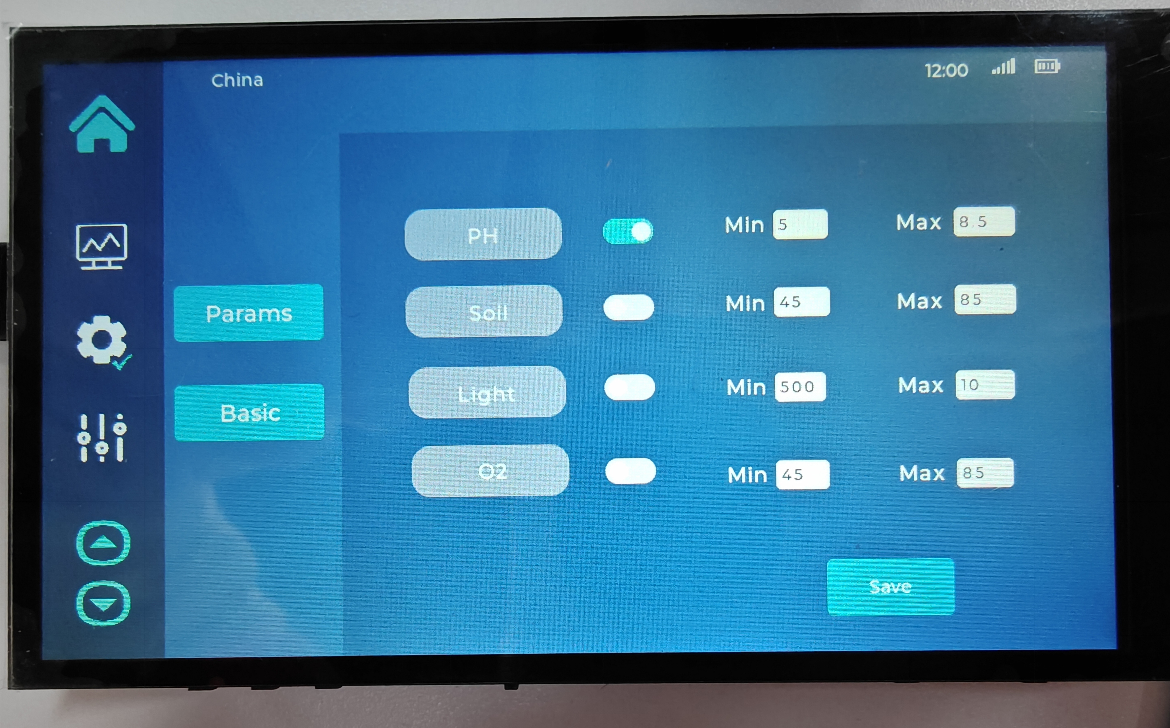

Threshold setting screen
The threshold setting screen allows users to customize and adjust various environmental and device operating parameters. These settings help ensure that the agricultural production environment matches the needs of crops, thereby optimizing growth conditions and improving production efficiency.
Users can set thresholds for various environmental parameters, such as temperature, humidity, light intensity, soil moisture, carbon dioxide concentration, etc. When these parameters reach or exceed the set thresholds, the system can automatically adjust device operation or send alerts.
Through this screen, users can finely adjust various aspects of agricultural operations according to specific situations and needs, ensuring efficient system operation and optimal crop growth conditions. This high degree of customizability is a major advantage of smart agriculture systems, allowing agricultural producers to flexibly adjust their operational strategies based on changing environments and market demands.

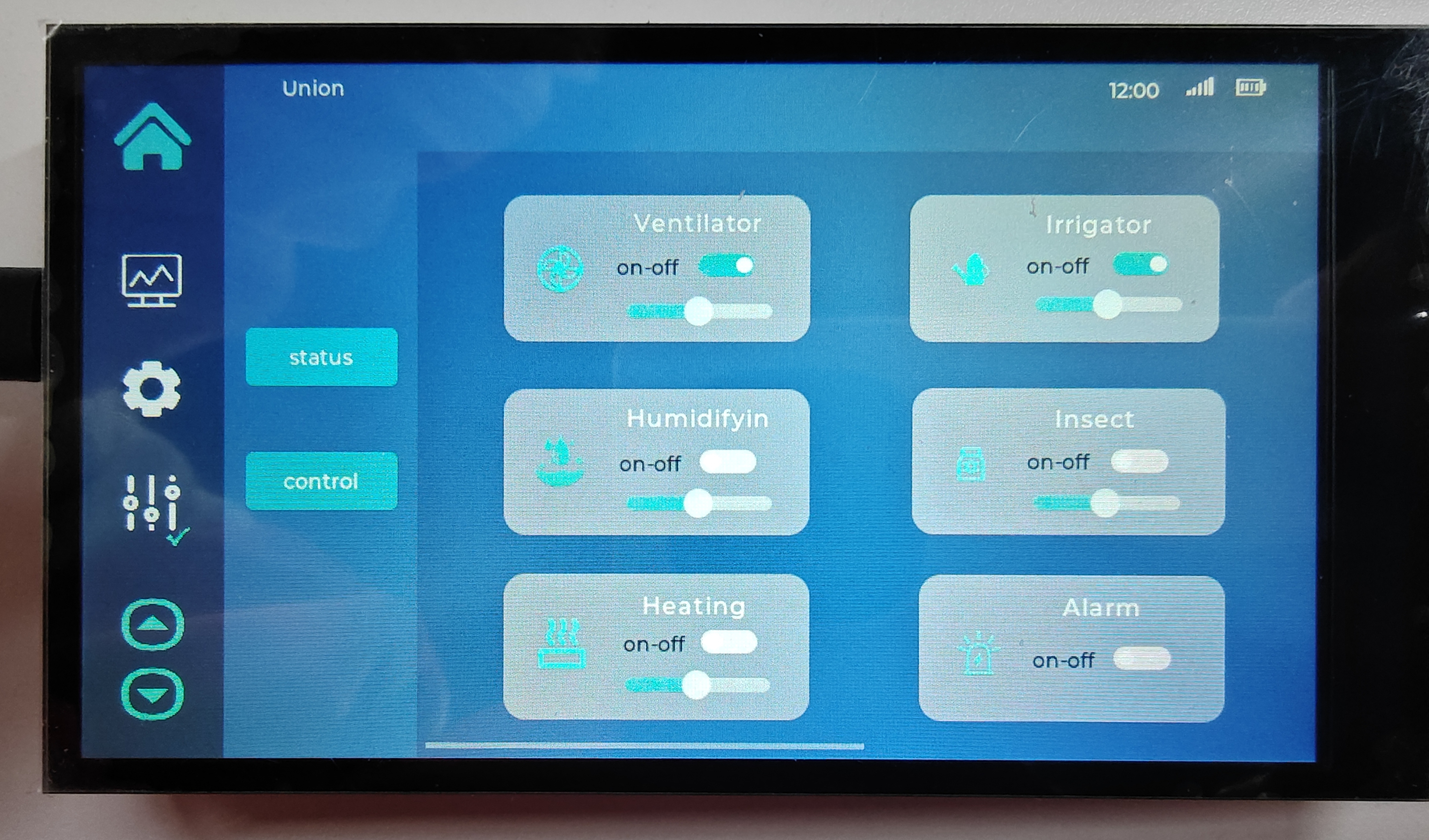

Equipment control screen
The device control interface is a critical component used for managing and operating various equipment on the farm. It provides intuitive control options and real-time feedback, ensuring that users can easily and effectively manage key equipment on the farm. Through this intelligent device control, farm managers can optimize production conditions, improve efficiency, and reduce resource waste.
This screen includes common equipment controls in agriculture. Including ventilation equipment, irrigation equipment, humidification equipment, deworming equipment, heating equipment, and alarm equipment.

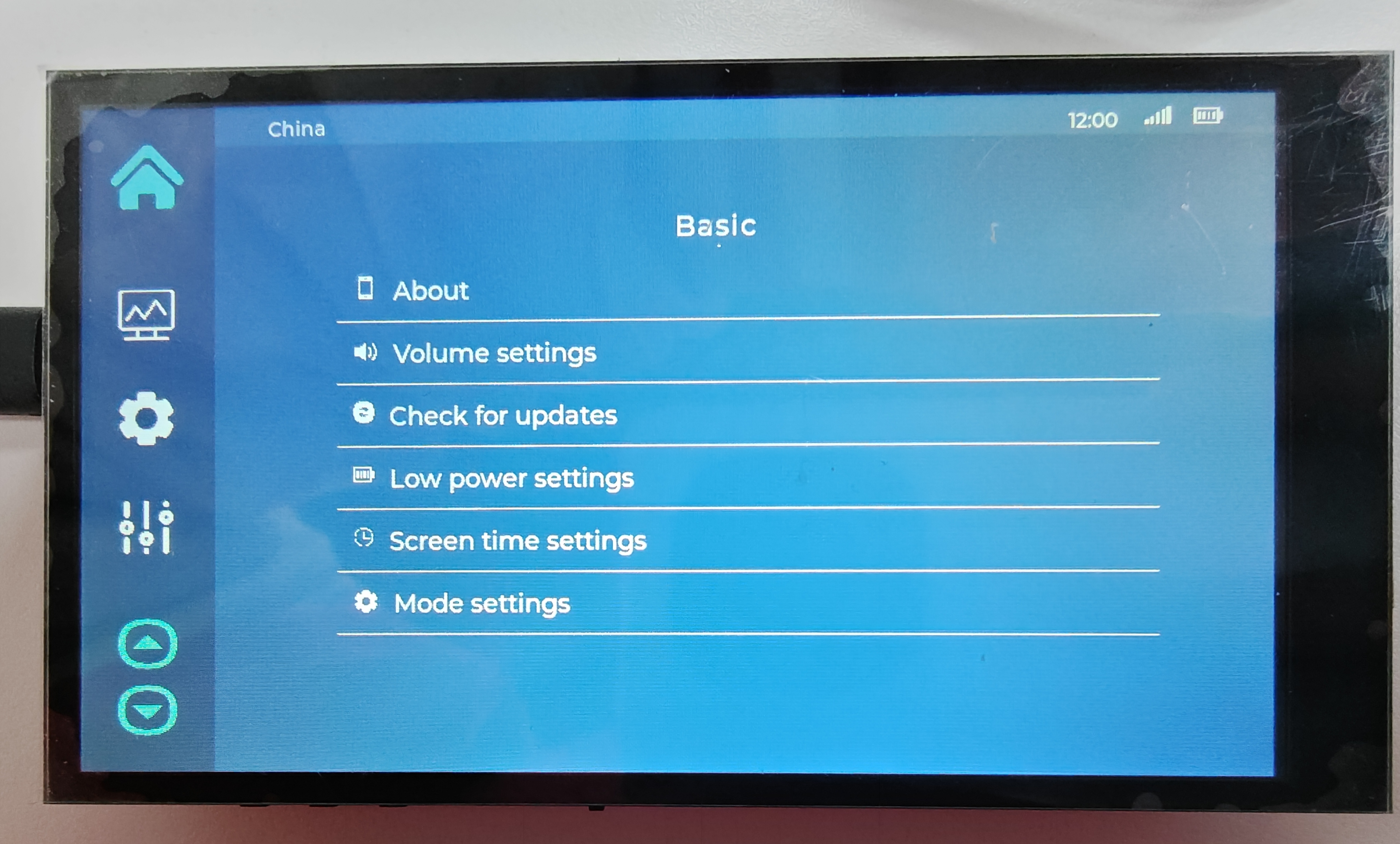

System settings screen
The system settings screen is a key component for users to configure and personalize their agricultural management system, allowing them to adjust various system parameters to meet specific needs and preferences. Through these settings, users can ensure the efficient operation of the system while meeting their personal preferences and operating habits.
This screen includes the following functions:
- About this machine
- Provide basic information about the system, such as manufacturer, model, and operating system version.
- Display the hardware configuration of the system, such as processor type, memory size, storage space, etc.
- Volume setting
- Allow users to adjust the volume of the system, including alarm sounds, notification sounds, etc.
- Silent mode can be set, especially in environments that require reduced interference.
- Check for updates
- Used to check system software updates and ensure that all features are at the latest version.
- This may include an option for automatic updates, allowing the system to automatically download and install new versions when they become available.
- Low power mode
- This option can reduce the energy consumption of the system, especially useful in environments with limited power sources.
- Low power mode may limit certain functions or reduce system performance.
- Screen rest time setting
- Allowing users to set the time for the screen to automatically turn off when there is no operation helps save energy.
- Users can set different time intervals as needed.
- Mode selection
- Users can choose different operating modes, such as daily mode, energy-saving mode, night mode, etc.
- Each mode may adjust settings such as screen brightness, volume, energy usage, etc.
Equipment status screen
The device status display screen is used to monitor and display the operating status of various devices and sensors, in order to quickly identify any potential problems and take corresponding measures to ensure smooth and efficient agricultural operations. Through such a central control panel, agricultural managers can effectively monitor and maintain key equipment and sensors on the farm, improving overall productivity and reliability.
This screen includes the status of common environmental sensors in agriculture. Including temperature and humidity, care, soil pH value, soil EC, carbon dioxide concentration, oxygen concentration, wind speed and direction, and soil temperature and humidity.
