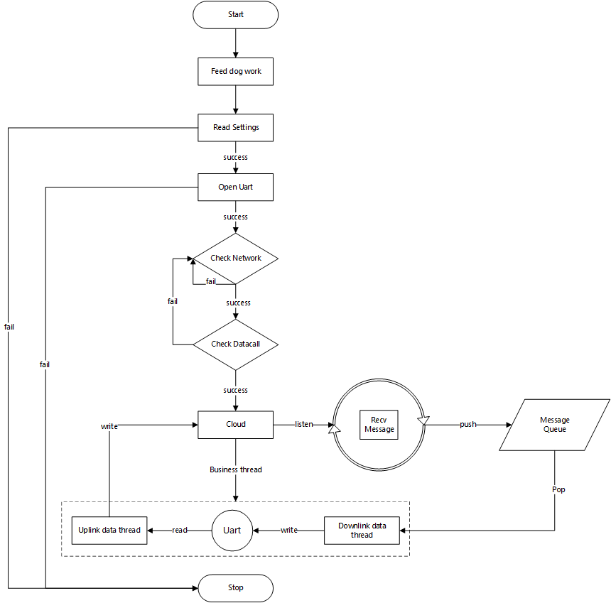

Application flowchart
Generally speaking, understanding a program code mostly starts from the startup part, and this approach is also adopted here by first searching for the source of the program's startup. The general program startup sequence for this routine is shown in the following figure:
Overall, the business can be summarized as follows:
  1. Start the dog feeding thread (the Huawei series 4G DTU is equipped with a hardware dog)
  2. After initializing the DTU object, read the system configuration
  3. Initialize serial peripherals
  4. Check the network status
  5. Initialize cloud configuration and message queue
  6. Start data up and down business threads
💡 Basic principle: This DTU adopts multi-threading + message queue to achieve upstream and downstream forwarding of serial port and cloud data. Among them, the Uplink data thread is used to read serial data and send it to the cloud; The downlink data thread reads cloud data from the message queue and forwards it through the serial port; The message queue is used to cache downstream data in the cloud.

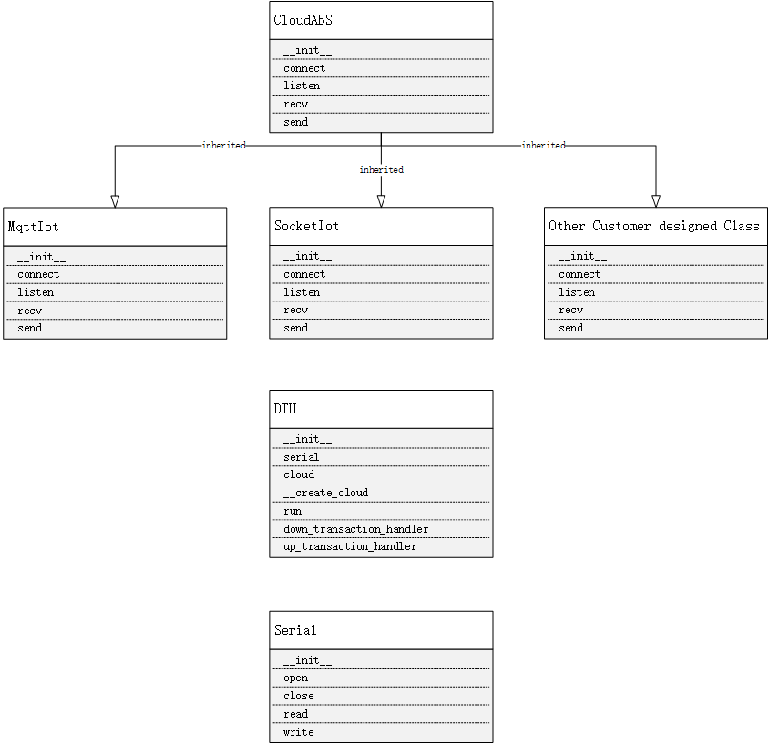

Object model
Multiple object models are defined in this scheme, including the DTU object model, CloudABS object model, and Serial object model. The basic definition is as follows:
DTU Object model
Define the DTU class in the dtu.py module, which is mainly used to manage the upstream and downstream business of serial ports, cloud, and data.

Cloud object model
Cloud model
In order to adapt to different cloud platforms (socket private cloud, MQTT, etc.), this solution defines abstract cloud types as follows. Users can customize Cloud objects according to abstract types to adapt to different cloud platforms.
💡 The implementation of Cloud model objects can refer to socketIot and MqttIot.

The above are the main methods and properties of the Cloud object model, including:
  • __init__: Receive keyword parameters, usually used to configure cloud initialization parameters, which users can define themselves.
  • connect: Connect to a cloud server.
  • listen: Listen to the downlink messages in the cloud. Usually, threads are used in this method to read the downlink data in the cloud and place it in the message queue for easy access by the application side through the self. recv method.
  • recv: Retrieve downlink messages.
  • send: Send an upstream message and receive several location parameters that users can customize.
