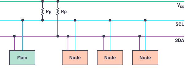

IIC Topology:
- Data (SDA): To transmit data.
Clock (SCL): To sync the data transmission. - Every device on the bus owns a unique address. As a result, the communication between micro-controller and devices can be implemented in accordance with the timing of corresponding address.
- As bidirectional lines, both SDA and SCL are connected to a positive supply voltage via a current-source or pull-up resistor. When the bus is idle, both lines are in high level.
- The transmission rate over the bus is up to 100 kbit/s in the Standard-mode, up to 400 kbit/s in the Fast-mode, and up to 3.4 Mbit/s in the High-speed mode.

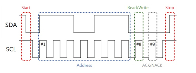

- Idle Level: SCL and SDA both are in high level.

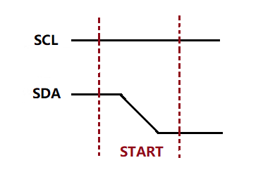

- START Condition: A HIGH to LOW transition on the SDA line while SCL is HIGH (IDLE).

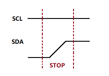

- STOP Condition: A LOW to HIGH transition on the SDA line while SCL is HIGH (IDLE).
- Acknowledge Condition: The acknowledge signal sent by the receiving end after it received valid data. After every byte (8 bits) of data, at the ninth clock, the transmitting end releases SDA line to receive acknowledge signal from the receiving end.
If SDA is low, the Acknowledge (ACK) is valid and the transmission is successful. If SDA is high, it will be a Not Acknowledge (NACK) and indicates the transmission has failed.
- Data Transmission: Data bits are allowed to change while SCL is LOW. After each 8 bits of data is tramsmitted, the slave would pull down the SDA (ACK) or pull up the SDA (NACK).

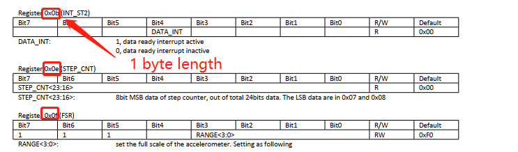

slaveaddressis a 7-bit address. When the master sends the slave address, the address will be shifted 1 bit to the left. After that, when writing data to the slave, the Least Significant Bit (LSB) will be a zero supplemented. When reading data from the slave, the LSB will be a one supplemented instead. For example, an IIC peripheral device has an address of 0x23, the master should send 0x46 if it want to send data to the slave, otherwise 0x47 shall be sent to read data from the slave. - The
addr_lenrefers to the address length of the register. You can get this information from the peripheral's datasheet. Commonly used IIC peripherals usually have an register address length of 1 byte such as QMA7981 3-Axis Accelerometer.

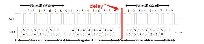

2. The delay parameter: After receiving commands from the slave, some IIC peripherals may need some delay before returning data correctly. So as a master, a delay is needed between sending command and reading data. See next figure.

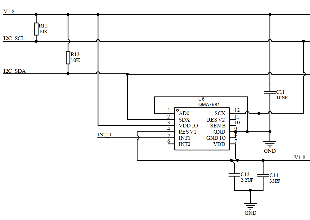

When using QMA7981, a couple of points should be noted:
- QMA7981 has 1 IIC interface which the module can get data from.
- QMA7981 supports two external interrupts at maximum, configurable LOW or HIGH trigger. Note that the QMA7981's interrupt config should corresponds to that in module. For example: QMA7981 is set to trigger interruption at HIGH, then the module's interrupt pin should be set to normal LOW and trigger by rising edge.
self.extint = ExtInt(INT1, ExtInt.IRQ_RISING, ExtInt.PULL_PD, self.ext_cb)
data = self._read([self.INTPIN_CONF_ADDR], 1)
# set logic high as active level for INT1 pin
data[0] |= 0x01
print('INTPIN_CONF_ADDR: {}'.format(data))
self._write([self.INTPIN_CONF_ADDR], [data[0]])

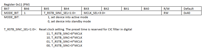

- When AD0 is connected to the ground, IIC slave address is 0x12. When AD0 is connected to VDDIO, IIC slave address is 0x13.
- QMA7981 has two modes: Standby Mode and Active Mode. When powered on, it goes into Standby Mode by default. By setting the PM register (0x11) , it will enter Active Mode.
- When QMA7981 is stationary and level, Z axis will have 1G of acceleration due to gravity. X axis and Y axis should remain 0.

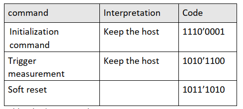

- The master must communicate with AHT10 via IIC and the slave address of AHT10 is 0x38. After the master issues the initialization command ('11100001'=Initialization, '10101100'=Measurement), it must wait for the measurement till the end. Basic commands are listed in the below table.

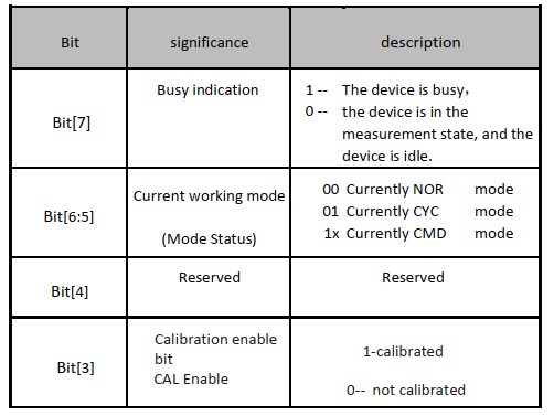

Below is a table regarding the return value of the sensor.
