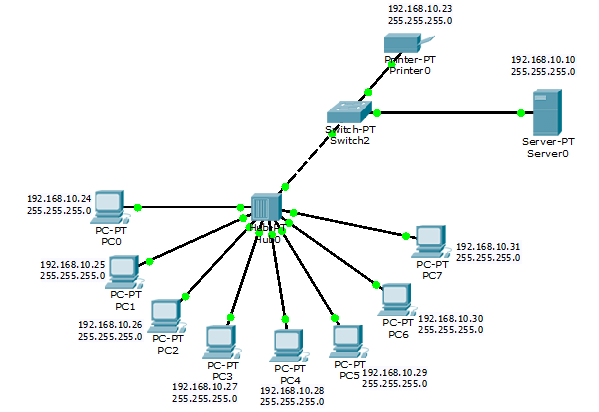

IP Address and Domain Name
An IP address is the host address in a network, used for two network hosts to find each other, which is the basis for successful network communication. An IP address is generally represented as a dotted decimal string, such as 192.168.1.1.
The websites we visit daily are hosted on servers with unique IP addresses. It is difficult to distinguish different hosts by remembering IP addresses, and a website may have multiple IP addresses or the IP address may change for some reason.
Therefore, the use of domain names to represent website addresses has emerged. For example, the domain name www.baidu.com is easier to remember than an IP address. IP addresses are still used in the actual network communication packets, so a domain name resolution protocol is required to obtain the IP address corresponding to a domain name.
The following explanations are based on the IPv4 protocol.

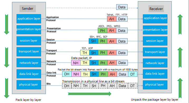

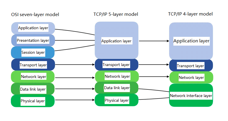

OSI Seven-Layer Model
The Open System Interconnection (OSI) model defined by the International Organization for Standardization (ISO) is a standard framework for computer or communication systems, generally known as the OSI seven-layer model. It provides a standard for implementing network communication protocols, where two parties use the same protocol at the same layer to communicate. For the same device, the lower-layer protocol provides calling interfaces for the upper-layer protocol to package the upper-layer protocol into an underlying-layer protocol, and finally sends it to the network for transmission.
The seven layers are "Application Layer", "Presentation Layer", "Session Layer", "Transport Layer", "Network Layer", "Data Link Layer", and "Physical Layer".
To simplify protocol implementation or facilitate understanding, the models of five layers or four layers have emerged. The four-layer model is generally mentioned more frequently, including "Application Layer", "Transport Layer", "Network Layer" and "Network Interface Layer".
The IP address mentioned earlier belongs to the network layer.
The network layer is used to forward all network data of the host to the NIC and send it to the network through the physical layer circuit.
To facilitate explanation, the following illustration is based on the four-layer model.

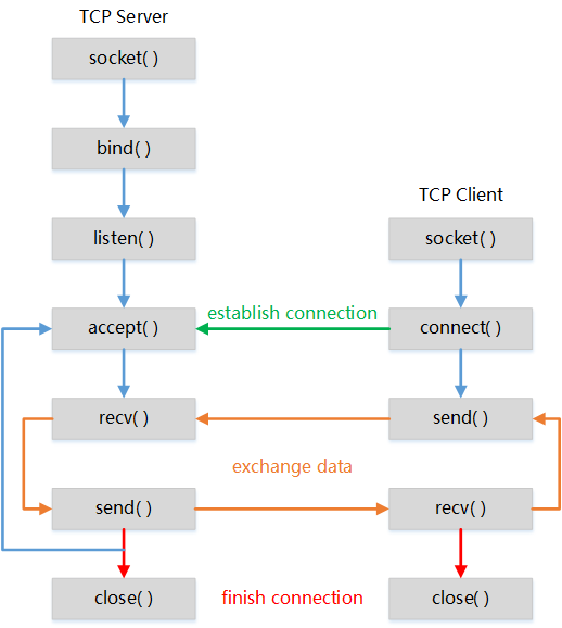

Before starting TCP network programming, let's first understand the socket programming model for TCP servers and clients through the following diagram:
TCP Client Network Programming
The right side of the diagram displays the simplest interface calling process of the TCP client programming:
  1. Call socket() to create a socket object.
  2. Call connect() to connect to the server.
  3. Call send() to send data to the server.
  4. Call recv() to receive data sent by the server.
  5. Loop steps 3 and 4 until certain conditions are met or the connection ends, then call close() to close the socket and release resources.

The left side of the diagram illustrating the socket programming model for TCP servers and clients shows the interface calling process for server programming:
  2. Call bind() to bind the local address and port.
  3. Call listen() to listen for client connection requests.
  4. Call accept() to accept client connection requests.
  5. Call recv() to receive uplink data from the client.
  6. Call send() to send data to the client.
  7. In each client connection, loop steps 5 and 6 until certain conditions are met or the connection ends, then call close() to close the socket and release resources.
  8. In the thread that accepts client connection requests, loop step 4 to accept more client connections.
When programming a TCP server, there are three additional interfaces compared to the client: bind(), listen(), and accept(). The explanations are as follows:
  • socket.bind(address): Bind local IP address and port.
    • address: A tuple or list containing the IP address string and port number. Because the server generally requires a fixed IP address and port, binding is required, otherwise, the client cannot know the server's IP address and port number.
  • listen(backlog): Listens for client connection requests.
    • backlog: The number of connection requests that can be queued for processing in addition to the ones being processed.
  • accept(): Accept a client connection request.
Having understood the process and usage of the interfaces, let's do an experiment: write a TCP server program and a TCP client program in the module. The client periodically sends data to the server and waits for the server to send data back.
TCP server code:

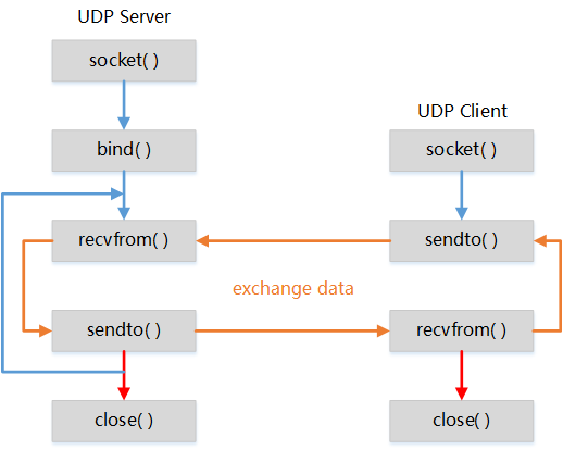

UDP Network Programming
Before starting UDP network programming, let's first understand the socket programming model of UDP server and client through the following diagram:
From the diagram, we can see that the UDP server also needs to call bind() to bind the local IP address and port number, which is necessary for the server.
At the same time, UDP programming is different from TCP programming in interface calls:
  • Different parameters for socket():
    • For TCP programming, the second parameter type is usocket.SOCK_STREAM, while for UDP it is usocket.SOCK_DGRAM.
    • For TCP, the third parameter proto is usocket.IPPROTO_TCP or usocket.IPPROTO_TCP_SER, while for UDP it is usocket.IPPROTO_UDP.
  • Since UDP is connectionless, the client does not need to call connect() to connect to the server.
  • The data sender only needs to call sendto() to send data.
  • The data receiver calls recvfrom() to receive data.
Whether sendto() can send data to the destination depends on the network environment. If the host corresponding to the destination IP address cannot be found, the data will be discarded.
