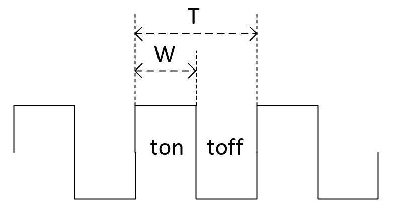

Pulse Width Modulation (PWM) is a very effective technology that uses the digital output of microprocessor to control analog circuits, widely used in measurement, communication, industrial control and so on. The frequency of PWM refers to the number of times in 1 second that the signal goes from a high level to a low level and back to a high level, that is the exact periods in a second PWM with Hz. The period unit of PWM is time, which refers to the time length of the signal from high level to low level and then to high level. The period is represented by T=1/f, while the f refers to the frequency. If the frequency is 50Hz, the one period will be 20ms. As a result, there are 50 PWM periods per second. The pulse width with a unit of time is the duration of the high level in one period. Duty ratio refers to the ratio of the time of the high level to the entire period time in a pulse period, and the unit is % (0%-100%).
See following diagram
In the figure above:
T: period,
W: pulse width,
ton: high level stage,
toff: low level stage,
See following formulas
T=ton+toff, frequency f=1/T, duty ratio =W/T.
For example, T is 10ms and W is 8ms, then the duty cycle is 8/10= 80%, which is a pulse signal with a duty ratio of 80%.

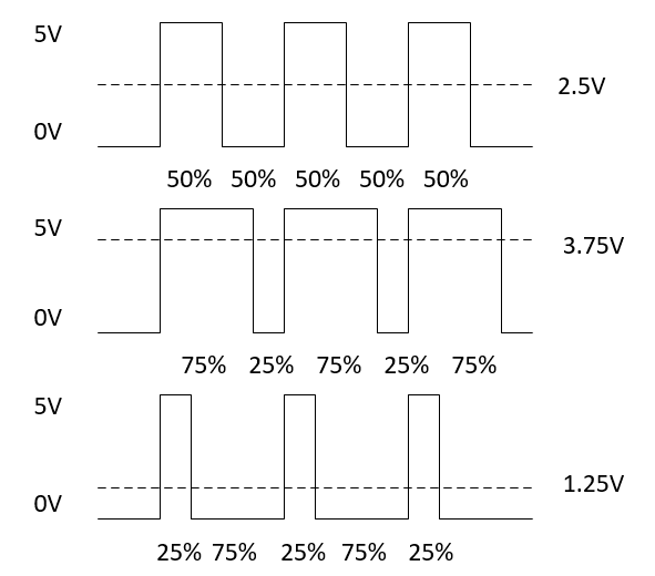

Under the appropriate signal frequency, the effective voltage output can be changed by changing the duty cycle. Assuming that the high level of the IO port is 5V and the low level is 0V, the analog voltage signal simulated by digital signal is obtained by changing the duty ratio of the square wave output from the IO port. At a certain frequency, the duty ratio is 50%, and the simulated output voltage of 2.5V can be obtained; When the duty ratio is 75%, the simulated output voltage of 3.75V can be obtained; When the duty ratio is 25%, a simulated 1.25V output voltage can be obtained. As shown in the picture below:
