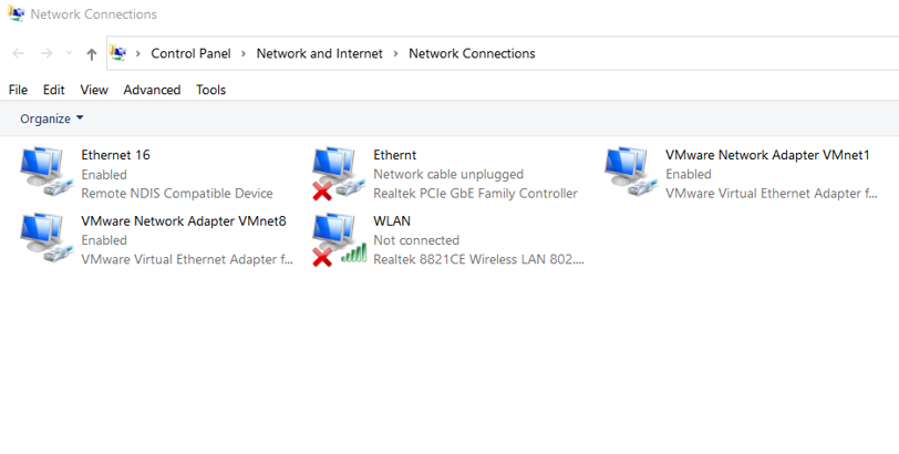

  4. Check the USB network adapter connection
    You can see that a RNDIS mode network interface has been added.

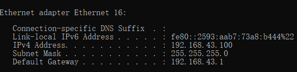

    Open cmd and enter ipconfig. You can also see that basic network information has been obtained. At this point, close all other network interfaces and only keep the network interface of the USB network adapter. The computer can now access the Internet normally.
