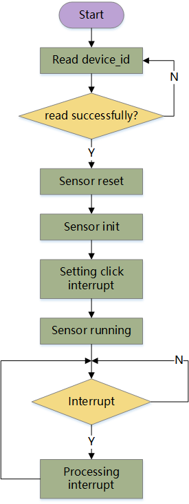

Workflow
Features supported by LIS2DH12:
- Single/double-click detection
- Free fall detection
- Tilt angle measurement
- Switch between landscape/portrait mode
Enable the single-click detection feature. When a single-click event occurs, map it to the INT1 pin. The processing logic is roughly as follows:
LIS2SH12 initialization steps:
- Set the CTRL_REG2 register to enable high-pass filtering.
- Set the CTRL_REG3 register to route the interrupt to the INT1 pin.
- Set the CTRL_REG4 register to configure the full range.
Single-click interrupt configuration steps:
- Configure the CLICK_CFG register to enable the required sensing axis, X, Y, Z.
- Configure the CLICK_THS register to set the threshold.
- Configure the TIME_LIMIT register to set the time window limit.
- Configure the TIME_LATENCY register to set the latency.
Enable LIS2SH12 sensor:
- Configure the CTRL_REG1 register to enable the sensor.

x,y, andzaxes is basically (0,0,1), in units ofG. This can be used to determine whether the sensor reading and acceleration calculation are normal.- It is recommended to use external interrupt to handle interrupts, rather than polling the interrupt register of the sensor. The latter method will prevent entering low-power mode.
The main program code is designed as follows:
def int_cb(args):
print('click just happened...')
acc = dev.int_processing_data()
print("read_acceleration result: ", acc)
if __name__ == "__main__":
# initialize i2c
i2c_dev = I2C(I2C.I2C1, I2C.STANDARD_MODE)
# initialize the lis2dh12 object
dev = lis2dh12(i2c_dev, 14)
# enable single_click_interrupt
dev.int_enable(XYZ_SINGLE_CLICK_INT)
# set interrupt callback
dev.set_int_callback(int_cb)
# start sensor
dev.start_sensor()
# LP mode
dev.set_mode(2)
print("interrupt detecting...")
Verification
Download the experimental code to the module and run it. When you click the sensor, you can see the content in the figure below printed on the "REPL" interface. The tuples in parentheses are the accelerations of the three axes at the moment of triggering, in units of G.
