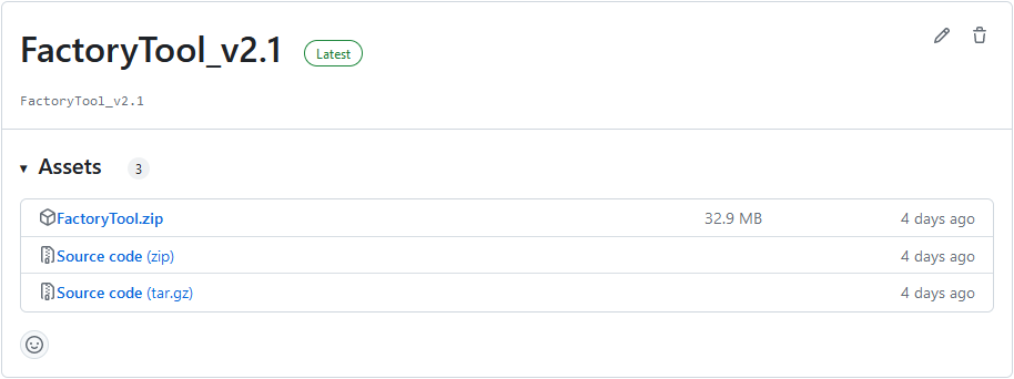

Obtain the Tool
Click here to enter the download page to obtain the Factory Tool package: FactoryTool.zip.

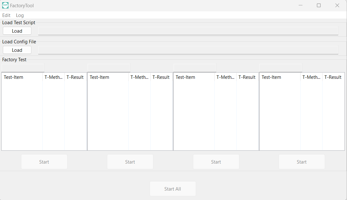

Menu Bar: "Edit" menu and "Log" menu.
Edit: Used to edit test scripts and Excel log files.
Log: Used to view test log files and tool running log files.
Loading Area: "Load Test Script" and "Load Config File".
- Test Scripts: A collection of test functions.
- Configuration File: Binds test information for each test item, including the test item name, test function name, and test method.
Testing Area: Includes device connection ports, test item names, test methods, and test results. The tool has four testing columns, allowing simultaneous testing of up to four devices, or individual testing of a specific device.

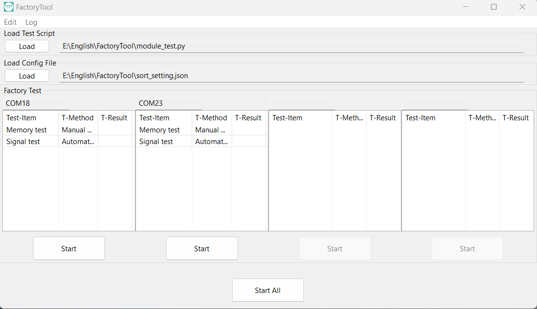

Step 2: Open Factory Tool and select test scripts and configuration files
After opening the tool, click "Load" to select the edited test code and configuration file. If a serial port is detected, the test item name and test method will be displayed under that serial port.

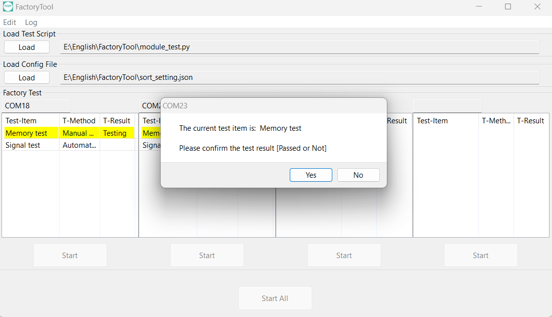

Step 3: Start testing
Click "Start All": Start testing all imported modules.
Click "Start": Start testing the corresponding module.
If it is a manual test, a pop-up window will prompt whether the test is successful. The tester can manually click "Yes/No" to confirm the result.

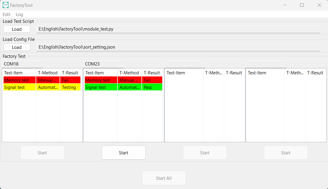

Step 4: View test results
The test results can be directly viewed in the test result column:
- Pass: Green color, test result column marked as "Pass".
- Fail: Red color, test result column marked as "Fail".
- Testing: Yellow color, indicating that the test item is being tested.
