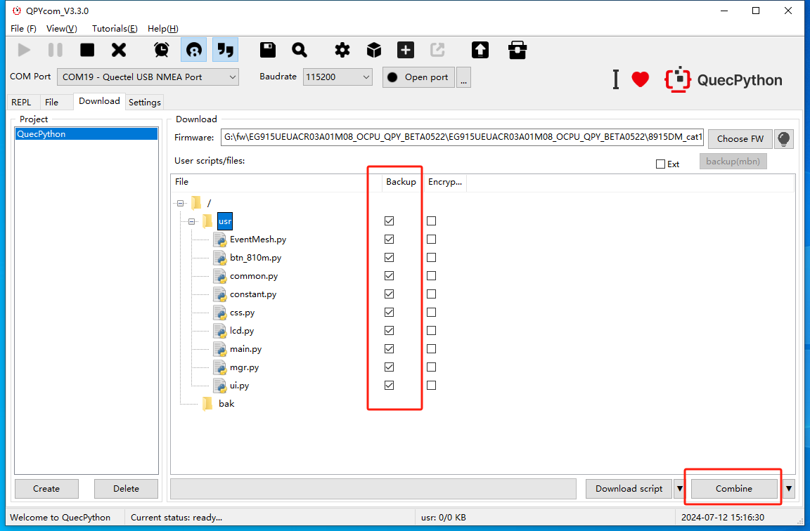

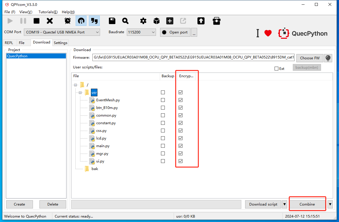

On the ''Download" page, you can combine local Python script files with firmware to generate the files for mass production. The steps are as follows:
  • Create a project in the left navigation bar.
  • Click "Choose FW" to choose the firmware from the local disk.
  • Select the scripts to be combined as indicated in the figure below. You can right-click a specified script file and click "Delete" to delete the file. You can also import an entire directory to combine projects with complex directory structures by clicking "One click import".
  • You can select "Encryption" and "Backup" to enable file backup and encryption.
  • After selecting "Backup" (The bak or usr partition must be empty or non-existent), usr will be automatically imported into the bak/usr directory.
  • Any files added to usr will only exist in the usr partition and will not be restored from the bak/usr directory. Similarly, any files added to bak will only exist in the bak partition and will not be restored from the bak/usr directory.

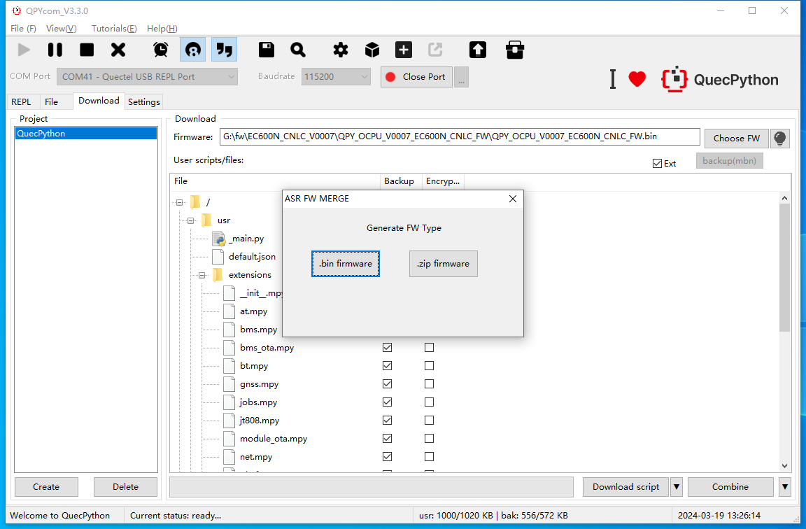

  • For the ASR firmware combination, you can select one file format from .zip and .bin (supported in QPYcom 2.9 and above).

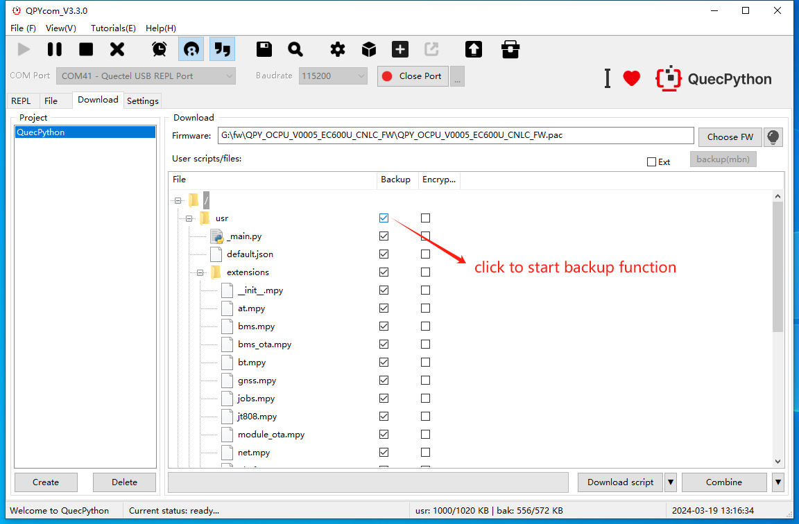

Backup File
Overview of Backup File
The tool can back up the files to be merged during the firmware merging process
If the backed-up files are accidentally deleted, they can be restored by restarting the virtual machine
Backup Steps
  1. Follow the firmware and script merging process above, after selecting the firmware and script to be merged, enable the backup function by checking the backup checkbox
  2. After checking the backup, click the merge button, and the selected script will be backed up before merging

  1. Following the steps of "Combine Firmware and Script", after selecting the firmware and scripts to be combined, select "Encryption" to enable the file encryption.
  2. After selecting "Encryption", click "Combine". The selected scripts will be encrypted before being combined to ensure all combined scripts in the firmware are in .mpy format. After the combination is completed, you can find the generated .mpy file in the mpy folder in the directory.

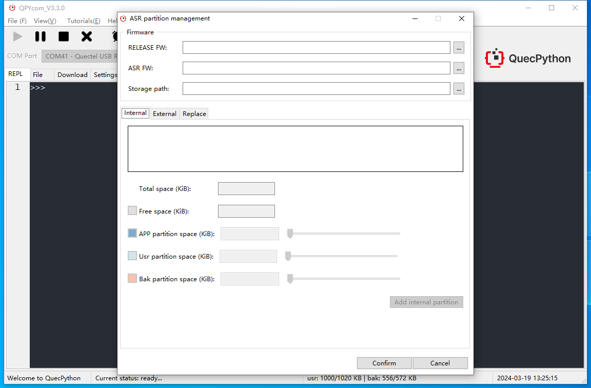

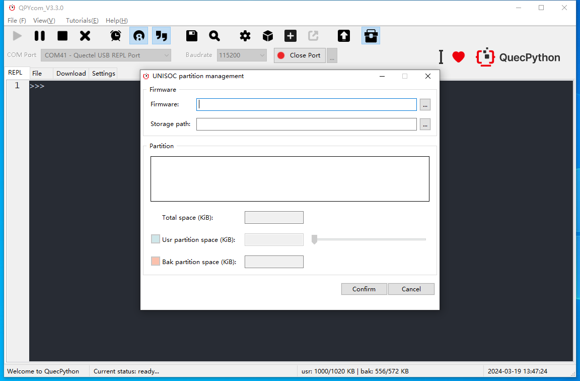

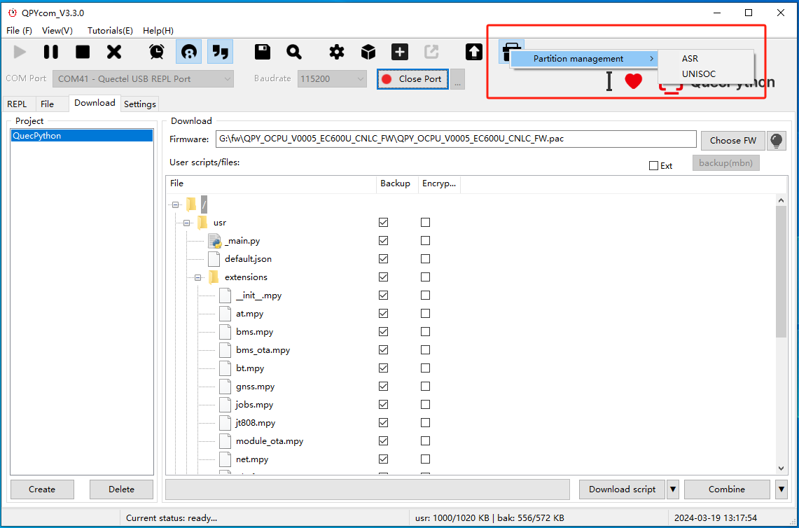

Adjust Image Partition
Adjust User and Backup Partition Sizes
  1. Click the Function Box button and select asr or unisoc.

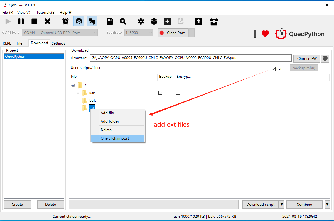

Combine External Partitions
  1. If you need to add an external partition image when combining firmware and creating a file system, you can combine external partitions.
  2. Select "Ext" on the "Download" page. Then a directory named "ext" will be added to the "User scripts/files" window.
  3. Add files to this directory and continue the combination process to combine the firmware with the external partition.
Note: Only custom firmware that supports external partitions can support the combination of external partitions.
