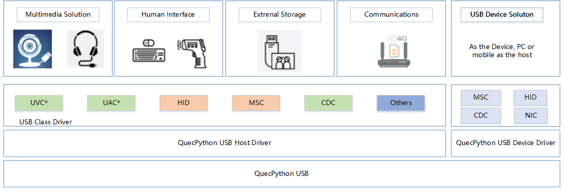

QuecPython supports various USB applications, including USB multimedia applications.
usb_solutions

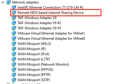

RNDIS Driver Installation
When the RNDIS driver is not installed, the figure below will be displayed.
1688388626069
The steps to install the RNDIS driver on Windows:
  1. Connect your device to the computer's USB port. In "Device Manager", you may see an unrecognized device named "Other device" or a device named "RNDIS".
  2. Right-click this device and select "Update Driver Software".
  3. In the pop-up, select "Browse my computer for driver software".
  4. Then select "Let me pick from a list of device drivers on my computer".
  5. In the pop-up list, select "Network adapters", then click "Next".
  6. In the "Manufacturer" list, select "Microsoft", in the "Network Adapter" list, select "Remote NDIS Compatible Device", then click "Next" to complete the driver installation.
Note: The above steps may vary slightly with your device model, Windows version, and system settings. When installing drivers, it is recommended to follow the specific instructions provided by your device manufacturer.

  • Restart the computer: Restarting the computer can resolve some installation issues.
  • Check module compatibility: Make sure your module is compatible with your operating system in use. Check the technical specifications and requirements of the device manufacturer.
  • Download the latest driver: Go to the QuecPython official website to download the latest version of the driver. Old drivers may be incompatible with a new operating system.
  • Run as administrator: In Windows, right-click the driver installer and select "Run as administrator". This can resolve installation errors due to permission issues.
  • Turn off anti-virus software: Some anti-virus software may prevent drivers from being installed. Temporarily disable anti-virus software while installing drivers.
  • Manually install driver: In "Device Manager", you can manually install the driver. Right-click the device, select "Update driver", then "Browse my computer for driver software", and navigate to the driver location for installation.
  • Contact QuecPython technical support: If you still cannot resolve the issue after trying the above solutions, please contact QuecPython technical support for assistance.
