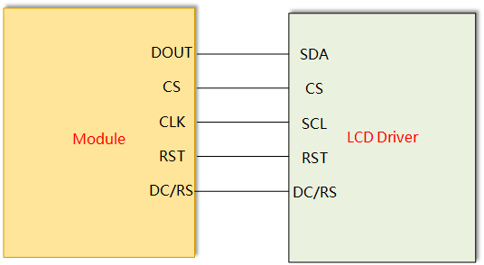

SPI LCD Display
It owns two methods to connect SPI LCD based on cellular modules, one is a dedicated LCD SPI interface and the other is general SPI.
The connection lines between the cellular module and the LCD display are shown in the figure below:
- The DOUT pin is used for serial data transmission. It is a bilateral data communication line between the LCD display and external device such as a controller or micro-controller.
- The SCL/CLK pin is used for clock synchronization during serial data transmission. It provides the clock signal for data transmission for sake of ensuring the proper data synchronization and transmission.
- The RS/DC pin is used to indicate the type of data sent to the LCD, i.e. data or command. When the RS/DC pin is low, it means a command is sent; when the RS pin is high, it means data is sent.
- The RST pin is used to reset the LCD display to its initial state. When the RST pin receives a reset signal, the display will re-initialize and clear the previous status and data.
- The CS pin is used to select or activate the LCD chip. When the CS pin is low, which indicates that the chip is aimed at communication or operation.
When the LCD SPI pin connects to the LCD, the RS, RST and CS pins can only select as specified in the hardware manual. For example, in EC600U series, the CS pin, RST pin and RS pin will be 65, 64 and 63 respectively. See LCD SPI interface initialization as follows:

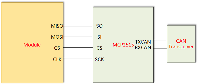

MCP2515 CAN Controller
Most CAN controllers in market use SPI bus communication, among which, the MCP2515 is the most widely used. Therefore, in this chapter, it will introduce how to use the Quecpython SPI module to communicate with MCP2515.
The MCP2515 connection diagram is as follows:
The following contents display the codes for the SPI interface used in the MCP2515 driver.
