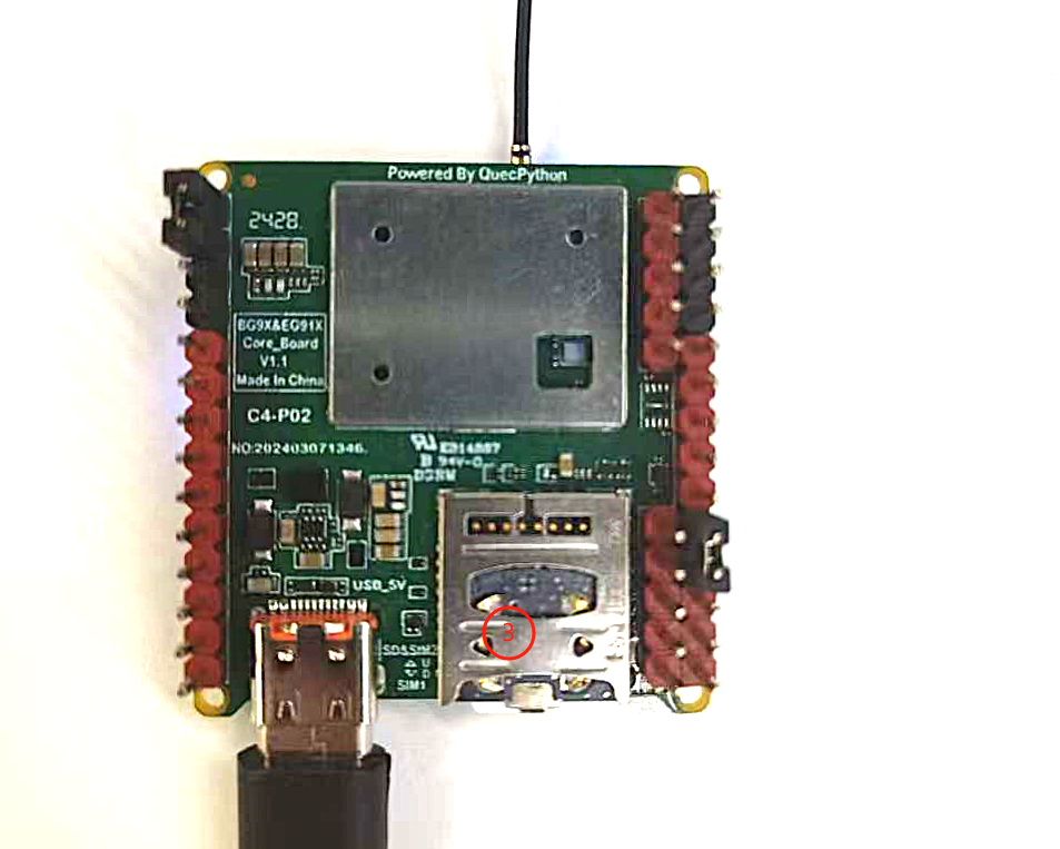

- One usable Nano Sim card

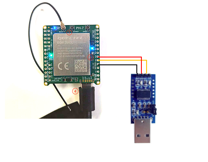

Hardware connection
Follow the following diagram for hardware connection:
- The MAIN port connects to an antenna.
- TX (EG912U development board) connected to RX (USB-to-TTL module); RX (EG912U development board) connected to TX (USB-to-TTL module); GND (EG912U development board) connects to GND (USB-to-TTL module) in common ground. The development board uses 3.3V power supply.
- Insert the Nano Sim card.
- Connect to computer using USB data cable, connect to computer using USB to TTL module.
