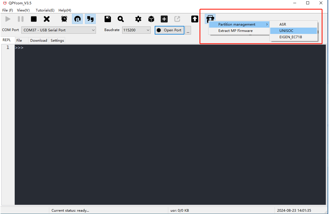

Taking the EG915U series module as an example:
- Click "Function Box" -> "Partition Management" -> "UNISOC"

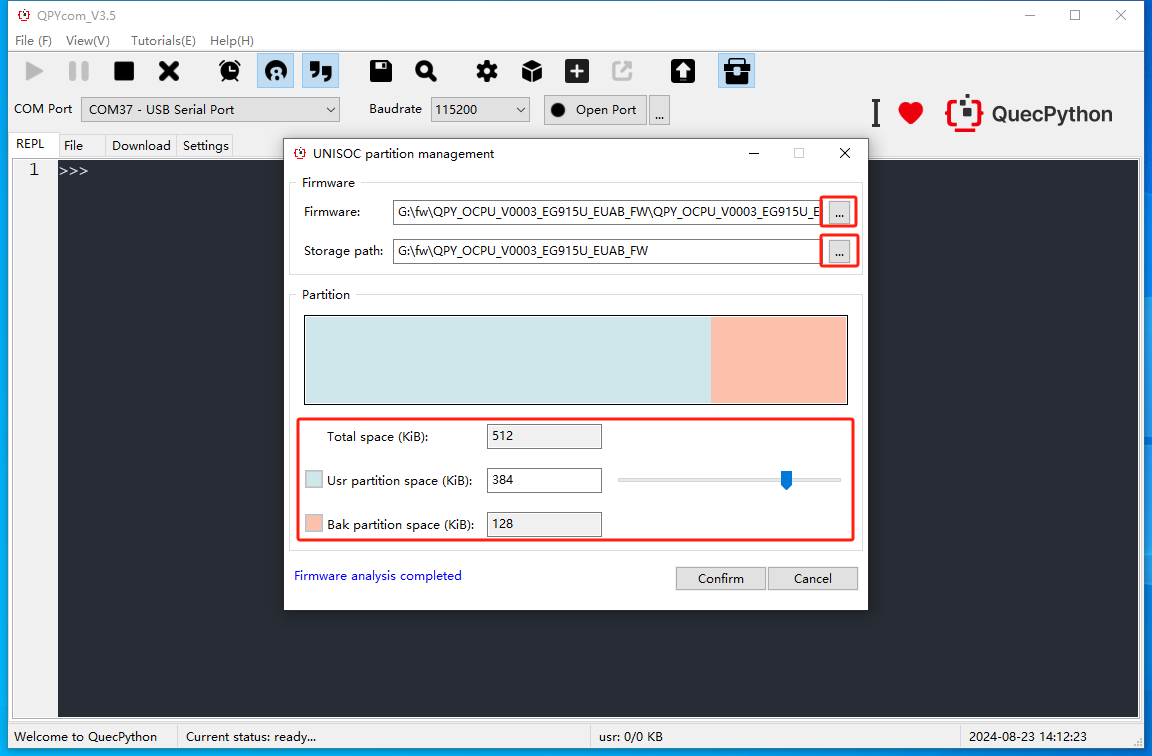

- Select the firmware file, such as QPY_OCPU_V0003_EG915U_EUAB_FW\QPY_OCPU_V0003_EG915U_EUAB_FW.pac, showing the sizes of the "usr" and "bak" partitions, as well as the total size of both partitions.

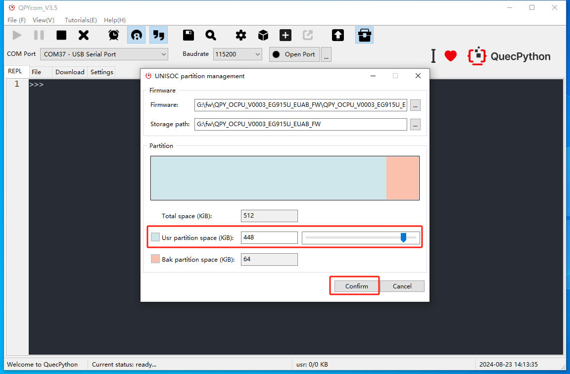

Drag the progress bar or enter in the text box to change the size of the usr partition, The size of the bak partition will be automatically updated to the new value.
Click the "Confirm" button to start generating firmware and wait for the new firmware to be generated..

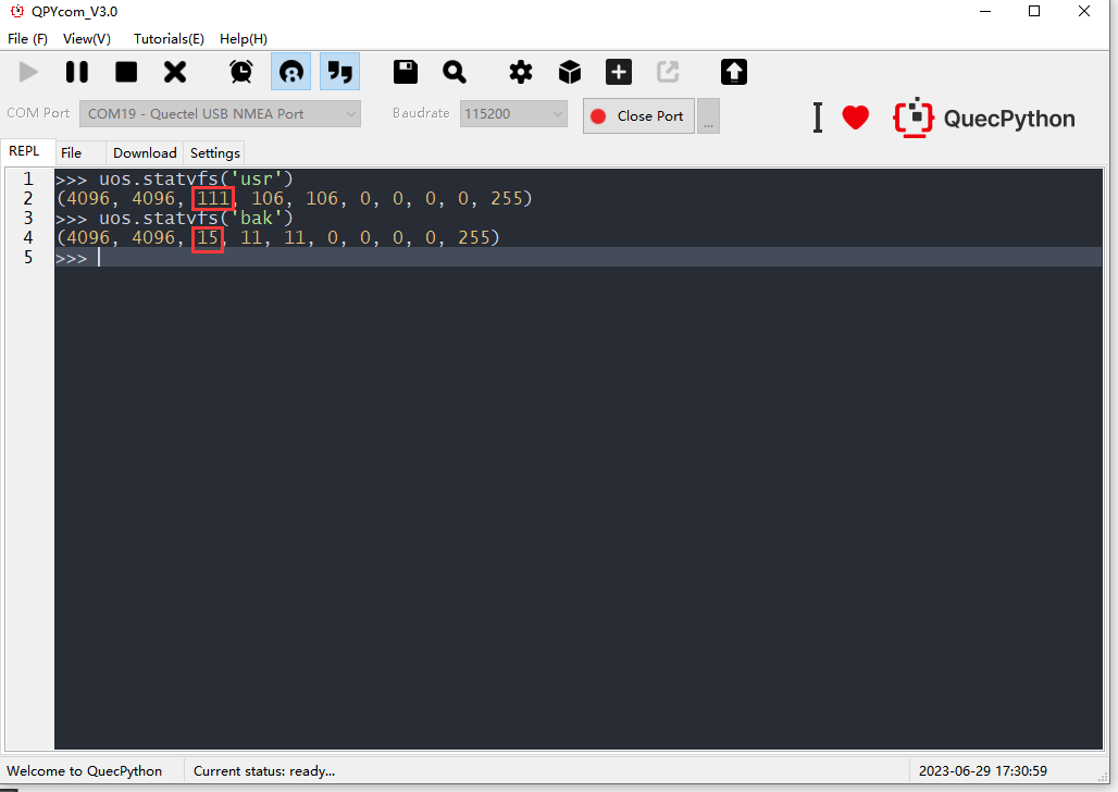

Flash the combined firmware and check the new partition size distribution:
