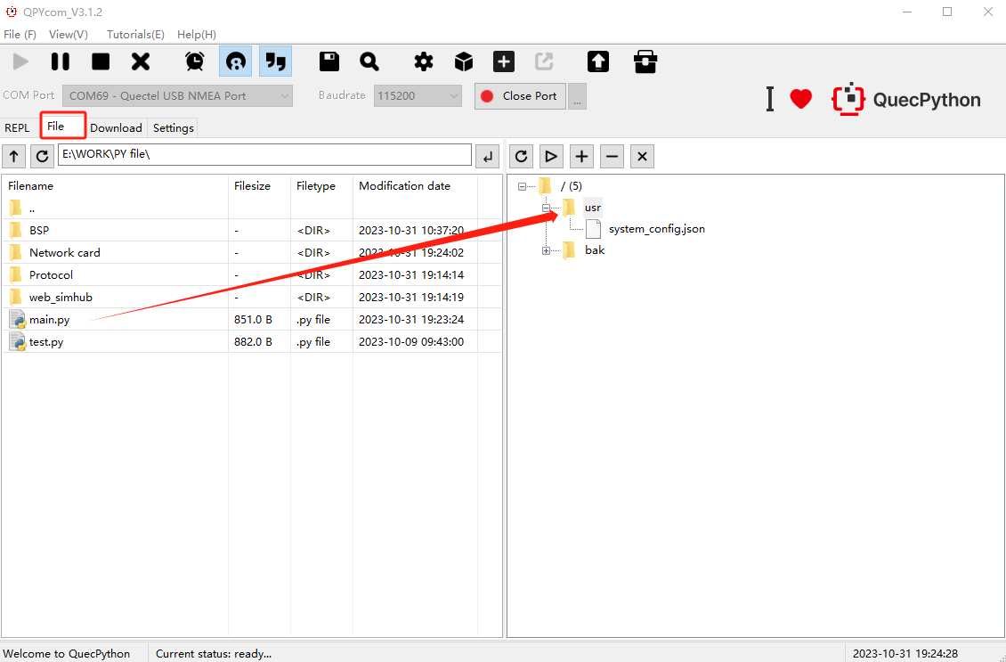

Drag the written script into the module file system's usr partition via the QPYCom file panel. The
main.pyfile is executed during startup.

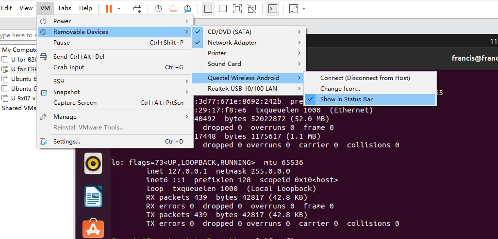

Connect the USB to Ubuntu
Connect the USB port of the device to the Ubuntu system.

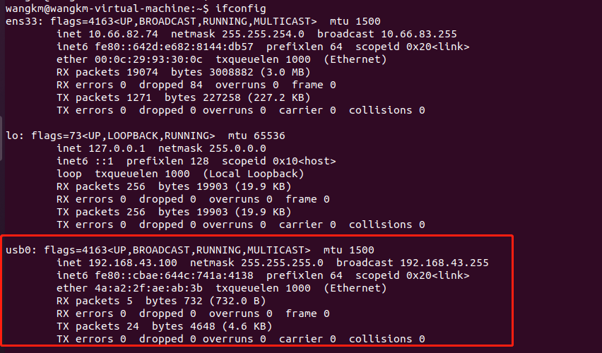

Confirm the USB network adapter connection
After the network adapter is loaded, check the network adapter status with the
ifconfigcommand. You will see the newly added usb0 network adapter. As shown in the following figure:

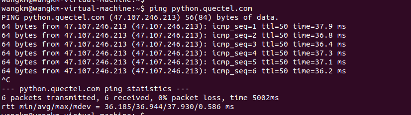

Confirm network connectivity
Check the connection by pinging
python.quectel.com. As shown in the following figure:
