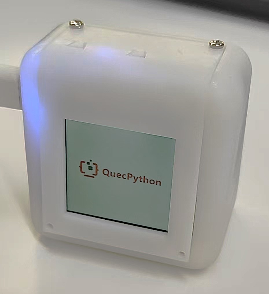

Activate Xiaozhi AI
As shown in the following picture, it is in a state ready to be awakened. A red light will flash on the development board, and you need to use the voice Xiaozhi, Xiaozhi to wake up Xiaozhi AI for a voice conversation.
After waking up, data related to connecting to the server or a prompt indicating connection failure will appear. When a connection failure occurs, please check if the network is normal.
