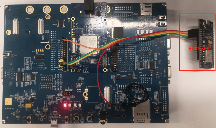

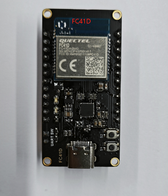

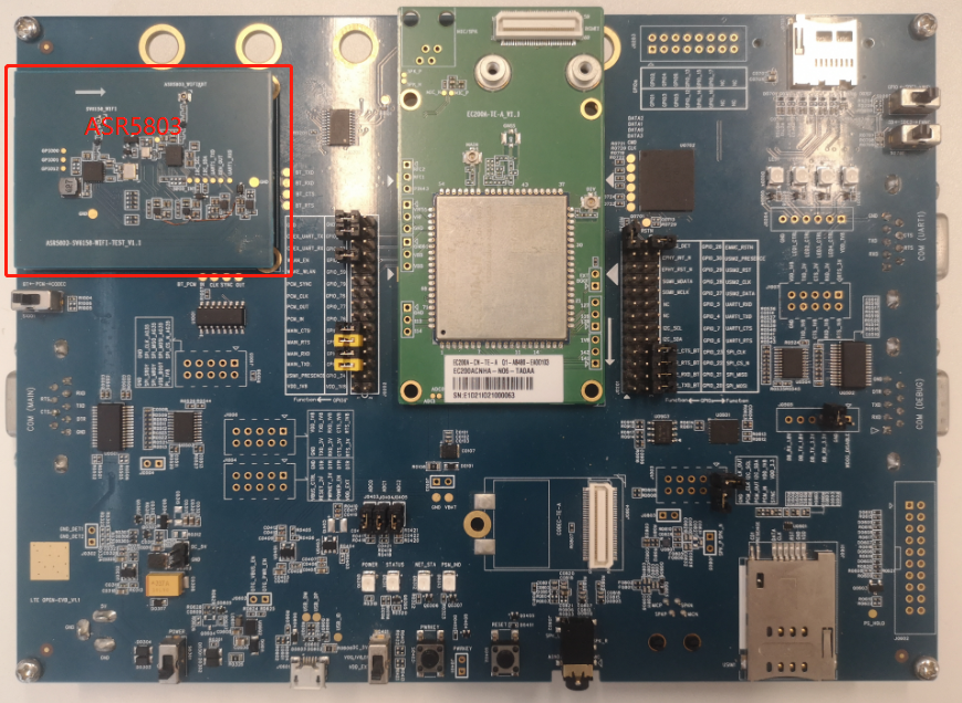

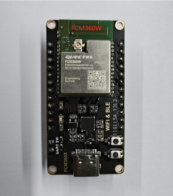

To use the external Wi-Fi NIC functionality, you need to prepare an external Wi-Fi NIC, a router, and DuPont wires.
Connect the module to the Wi-Fi NIC with DuPont wires. The wiring between the module and the NIC can be configured according to actual requirements. For specific interface configuration parameters, please refer to the ESP8266 section on Wiki.
ESP8266 Hardware Connection Photo
ASR5803 Hardware Connection Photo
FCM360W Hardware Photo
FC41D Hardware Photo
