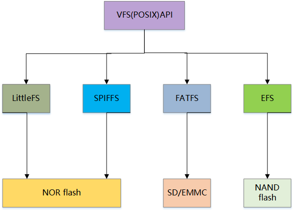

Types of File Systems
Currently, various modules use different types of file systems, including EFS, SPIFFS, littleFS, and FATFS.
| File System | Characteristics | Applicable Scenarios | Applicable Models | Open Source URL |
| EFS | Supports various NOR and NAND technologies | Embedded systems with NOR flash, NAND flash, SD cards, EMMC storage | BG95 series module underlying system | Not open |
| SPIFFS | Low resource consumption, balanced erasing, power-off protection | Embedded systems with SPI NOR flash storage | ECx00U&EGx00U&ECx00G series module underlying system | https://github.com/pellepl/spiffs |
| littleFS | Low resource consumption, balanced erasing, power-off protection | Embedded systems with SPI NOR flash storage | All models of QuecPython application layer | https://github.com/littlefs-project/littlefs |
| FATFS | Compatible with Windows FAT32 format | Embedded systems with SD card and EMMC storage | SD card and EMMC storage scenarios for all models | http://elm-chan.org/fsw/ff/00index_e.html |
VFS
Virtual File System. It is an abstract file system built on top of the aforementioned physical file systems. It provides a unified interface to access different physical file systems. The VFS API is compatible with the POSIX standard API. The specific steps for operation are as follows.

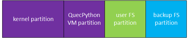

The software of the QuecPython device consists of firmware and user application scripts. The firmware is stored in the device image partition, while user application scripts are stored in the device file system partition. A file system backup and restore mechanism is designed to ensure system stability. Currently the device has two file system partitions: the user file system /usr and the backup file system /bak. The user file system stores the Python scripts and data files needed for normal operation and is read-write. The backup file system is used to back up the original factory files from the user file system and is read-only. If the backup and restore function is enabled, when files in the user file system are accidentally deleted or modified, the original files will be automatically restored from the backup file system to the user file system. The NOR flash space is distributed as shown in the diagram below:
Implementation Principle
Combine the firmware with the QPYcom tool and check "Backup." The files will be automatically imported into the backup file system partition and two files named checksum.json and backup_restore.json will be generated in the backup file system partition. checksum.json records the CRC checksum values of files in the backup partition. backup_restore.json records the flag indicating whether the backup and restore function is enabled.
During the boot-up phase, if the backup and restore function is enabled, the system will check whether the checksum.json file exists in the user file system partition. If it does not exist, the checksum.json file from the backup file system partition will be copied to the user file system partition. Then, the CRC checksum value from the user file system partition and the CRC checksum value calculated from the user files in the user file system partition are compared. If the file does not exist or the checksum values do not match, the corresponding file from the backup file system partition is copied to the user file system partition, and the CRC checksum value is recalculated and updated in the checksum.json file in the user file system partition.
When user files participating in backup and restore need OTA upgrades, in the last step of the upgrade process, the updated CRC checksum value of the user files is updated in the checksum.json file in the user file system partition.

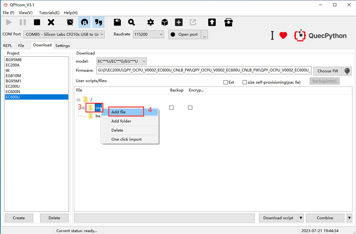

Procedures

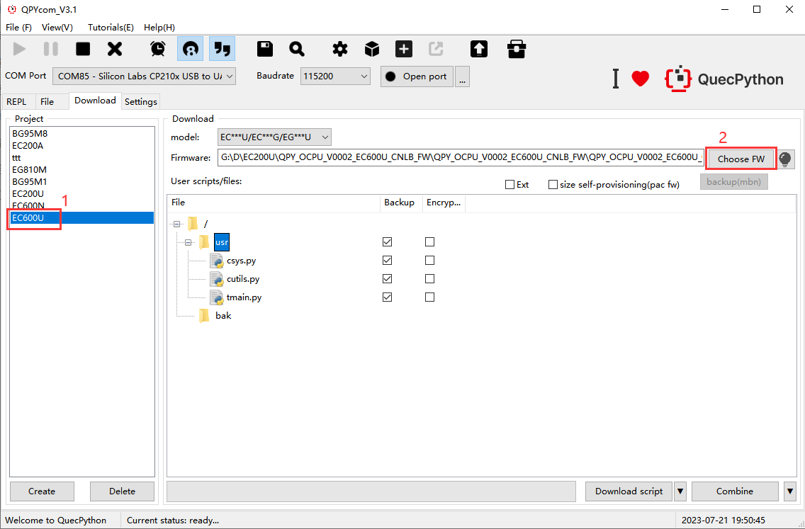

Select the module.
Select the firmware to be combined.
Right click and select usr to pop up the dialog box.
Click "Add file" to add the files to be combined and backed up.

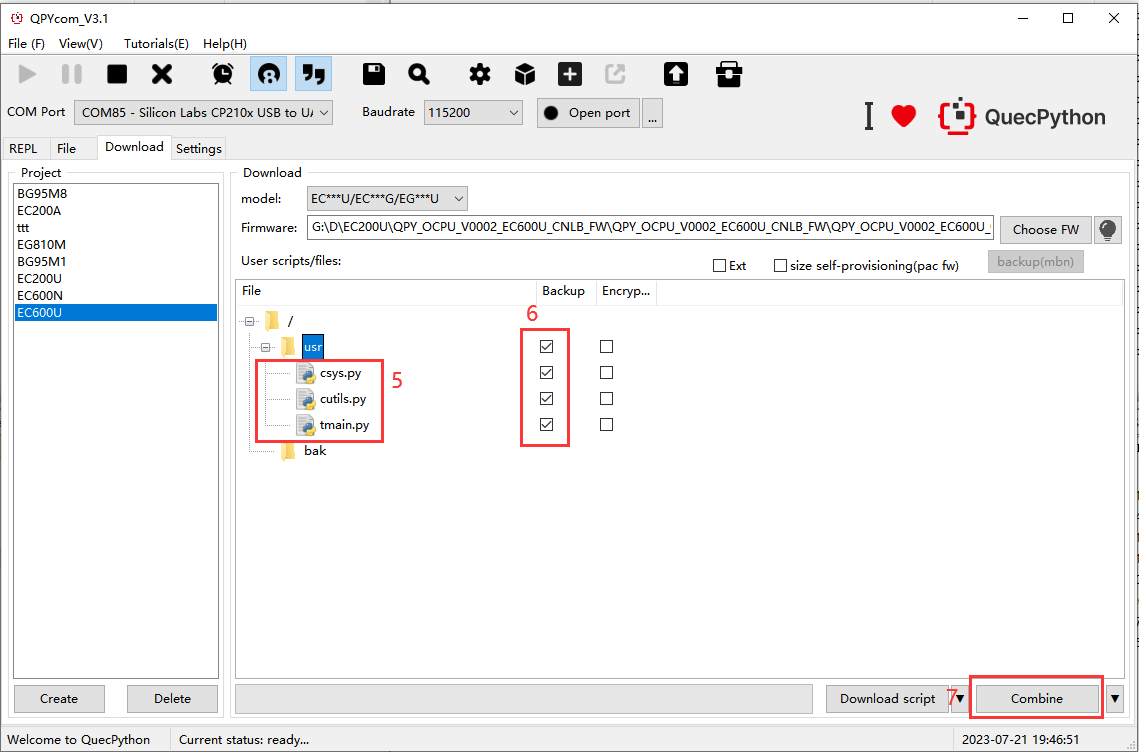

Confirm files added to be combined.
Check the button for backup.
Click the "Combine" button to combine the firmware. After that, firmware with backup and restore functions can be generated.
