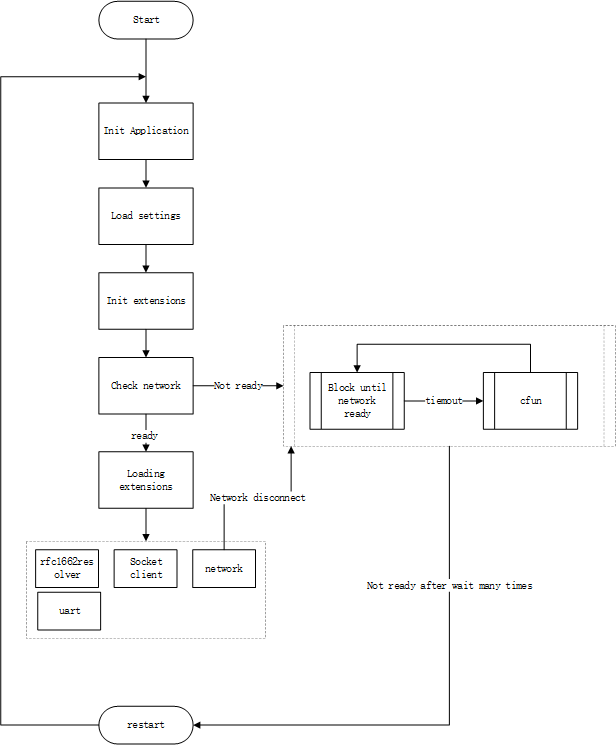

System startup process
  1. Instantiate application objects
  2. Import configuration JSON file
  3. Initialize various application extension components (this step will register each application extension into the main application object, facilitating communication between extensions)
  4. Check the network (this step will block waiting for the network to be ready. If the wait times out, try switching to cfun to restore the network)
  5. Load application extensions and start related services (customizable by users)
  6. The system enters normal operation mode (by default, SIM card and network detection are enabled. If there is a network failure, it will attempt to switch to cfun to restore the network)

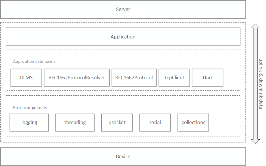

Basic framework
The smart meter solution is developed based on an application framework called QFrame.
The QFrame application framework is a fundamental application framework developed by QuecPython. Click here to view Design and application guidance for this framework.

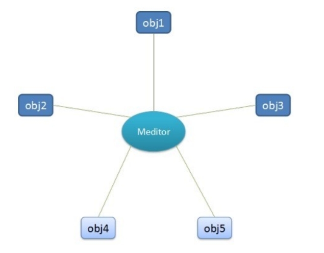

An application often relies on multiple business modules, and there may be coupling between them.
In the framework design, the communication between business modules adopts a star shaped structure design, as shown in the following figure:
The Mediator in the figure is an intermediary object (usually named 'Application') that communicates between various business modules through the Application object. This design is called the intermediary pattern.
The business module is embedded in the application program in the form of application extensions, and the interaction between various application extensions is uniformly scheduled through the Application object.

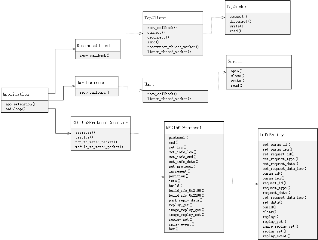

Class RFC1662ProtocolResolver
This class is an application extension class, an RFC1662 protocol data resolver, used to process RFC1662 protocol data transmitted in the business, and pack and unpack this class data.
The class provides the following methods:
  • resolve(msg)
    • Function: Process an RFC1662 protocol message. The behavior is to find the processing function of the message from the registry by resolving the protocol (which can be understood as the message id of the protocol message), and call the function to process if found, otherwise throw a ValueError exception. See the register decorator function on how to register the processing function.
    • Parameters: msg is an RFC1662Protocol object, which is an encapsulation class of the RFC1662 protocol, see the introduction below.
    • Return value: None
    • Exceptions: If the processing function cannot be found in the registry for the incoming msg, a ValueError exception will be thrown.
This class is a specific implementation of the RFC1662 protocol, including unpacking and packing. The instance object of this class is an encapsulated form of a complete RFC1662 protocol package. The main methods are:
  • build_rfc_0x2100: assemble 0x2100 protocol packet, return bytes, equivalent to RFC1662ProtocolResolver.tcp_to_meter_packet
  • build_rfc_0x2200: assemble 0x2200 protocol packet, return bytes, equivalent to RFC1662ProtocolResolver.module_to_meter_packet
  • build: class method, used to resolve a protocol packet frame, return RFC1662Protocol object.
  • replay_get: reply get command, judge success or failure
  • replay_set: reply set command
  • reply_event: reply event information
