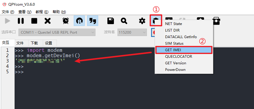

- Apply for a Bernard chip platform testing account.
According to the steps shown in the figure below, obtain the IMEI number and provide it to the sales personnel of Mobile Remote to apply for a walkie talkie testing account.

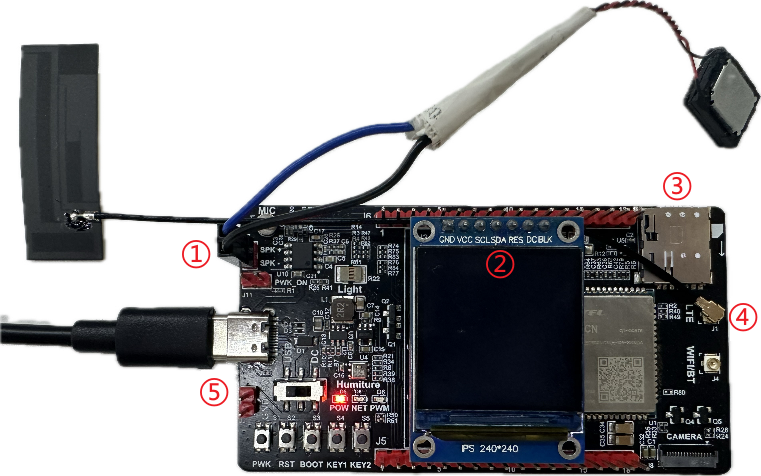

Connect the hardware according to the following diagram:
- Connect the horn to the pins labeled
SPK+andSPK -in the diagram. - Connect the LCD screen to the pin bank labeled with the word
LCD. - Insert an available Nano SIM card into the position shown in the diagram.
- Connect the antenna to the antenna connector marked with the word
LTE. - Connect the development board and computer using a Type-C data cable.

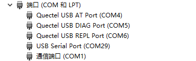

After completing the hardware connection work, long press the button labeled PWK on the development board until the network light flashes or a COM port containing the words Quectel USBappears in the port list of the computer device manager, indicating successful boot.

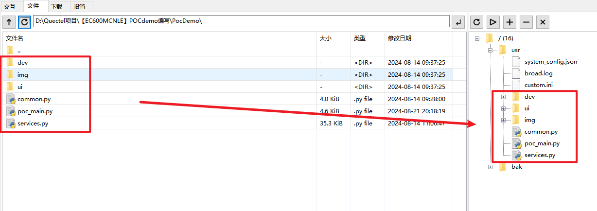

- Refer to this chapter Import all files from the
codefolder in the source code directory into the module file system, as shown in the following figure:

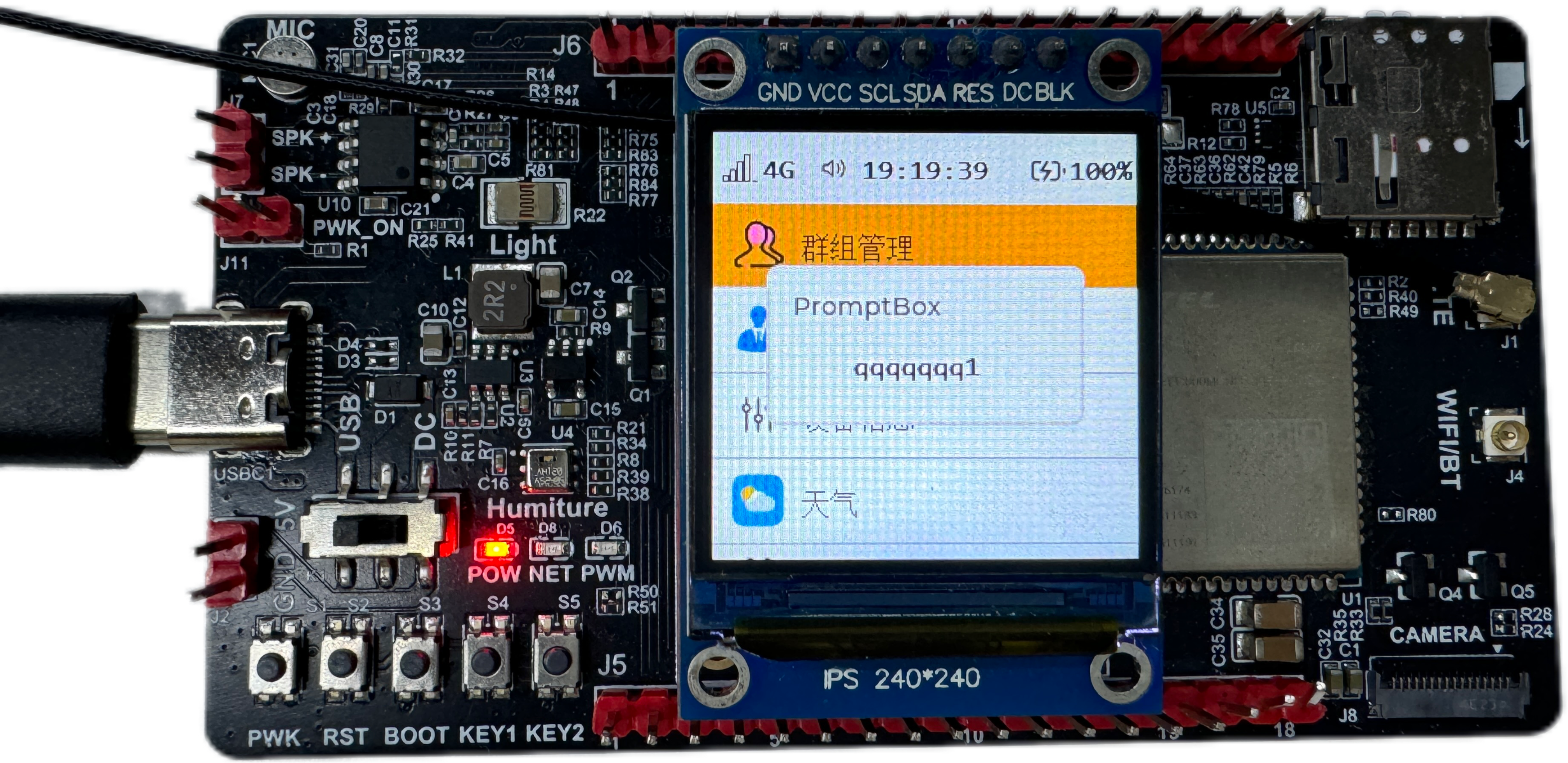

Main screen
The main interface contains multiple option lists, and each option corresponds to a new interface.
- Click the
key2key to scroll down the checkbox. - Double click the
key2key to enter the selected interface. - Long press the
key2key to return to the previous interface.
Group List
Entering the group management interface can query the list of groups that the current account has joined, and the message prompt box will indicate which group it is currently in, as shown in the following figure:
