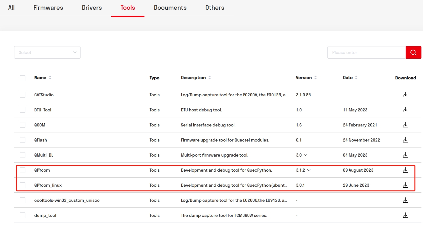

1.1 Installing QPYcom
As shown in the figure below, you can visit the official download page to download QPYcom based on your computer's operating system:
  • Use QPYcom for Windows systems.
  • Use QPYcom_linux for Ubuntu systems.
After downloading, unzip the file to use it.
Click here for more information on how to use QPYcom.

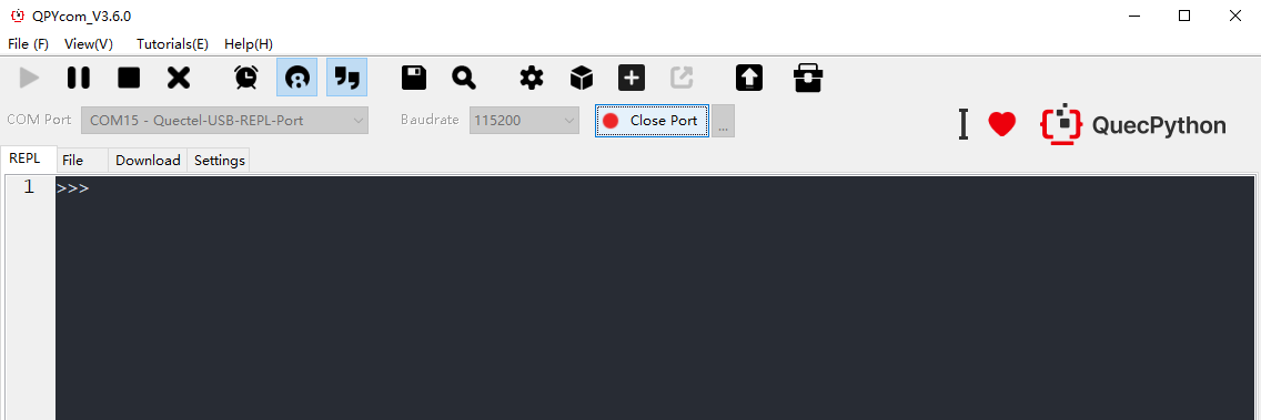

Step 2: Open USB Serial Port
Follow *Step 3* in *Section 3* of Helios SDK Development Guide__Intermediate to select the corresponding port from the drop-down menu of Ports in QPYcom. In this example, it is COM5.
Click Open port to enter the command interaction interface by default. The interface is shown in the following figure:

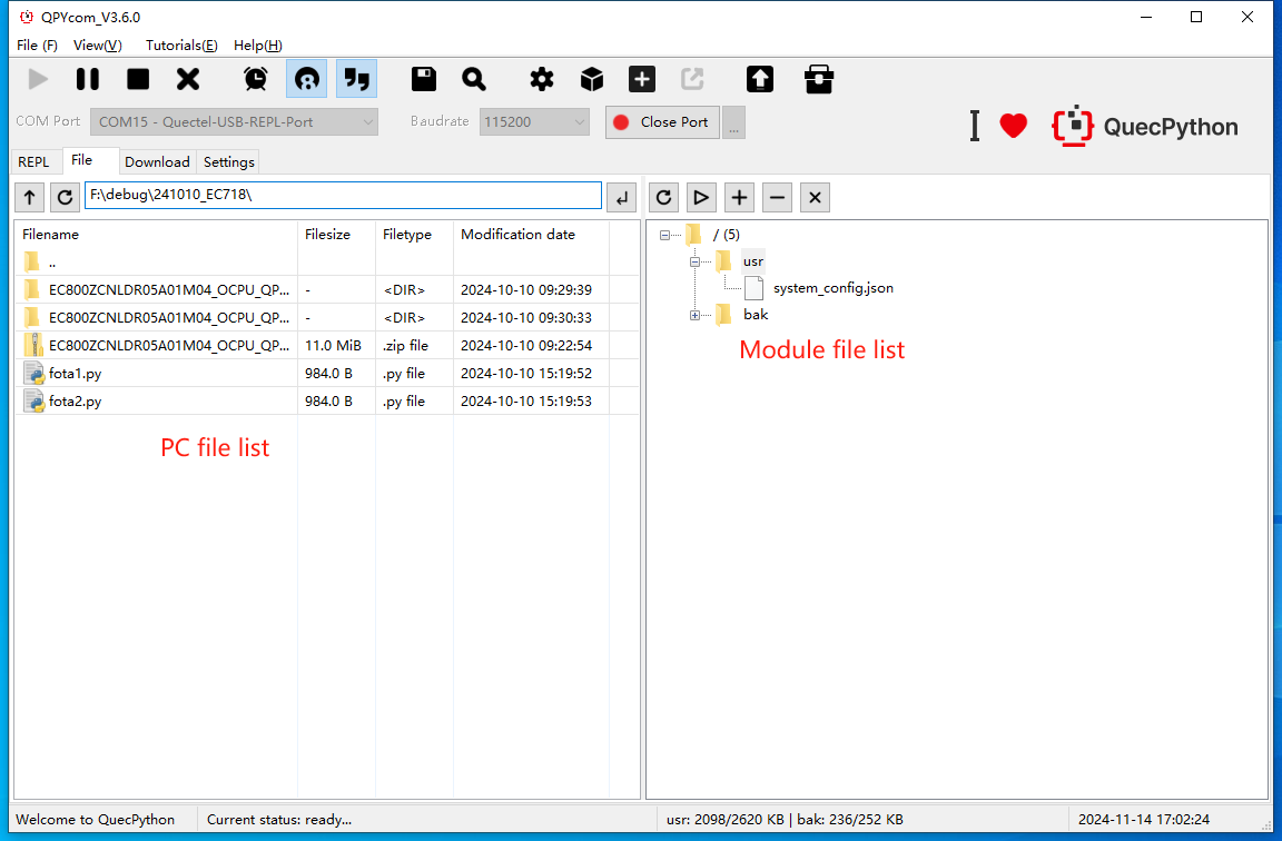

Step 3: Enter File Transfer Interface
Click File in the tab to enter the file transfer interface, as shown in the following figure:
In the figure above, the left side of the interface is the file list on the PC, and the right side is the file list on the module. After QuecPython starts on the module, a file named system_config.json will be automatically generated. Users can temporarily ignore the purpose of this file.

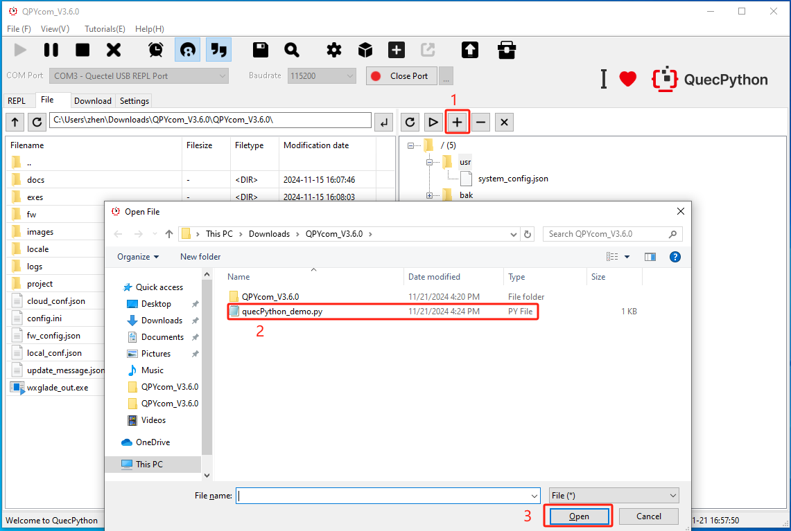

Step 4: Import Python Script File

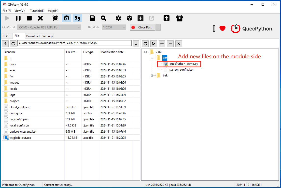

Click the + button above the file list on the module to transfer the file to the module.
As shown in the following figure, follow the order of 1, 2, and 3 to import the quecPython_demo.py file to the file system.
After the import is complete, the quecPython_demo.py file will appear in the file list on the module, as shown in the following figure:

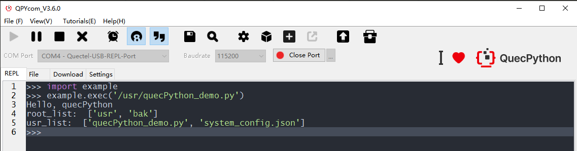

1.4 Executing Imported Script File
Click the REPL tab to enter the command interaction interface.
In the command interaction interface, enter the following two commands one by one:
import example
example.exec('/usr/quecPython_demo.py')
After the commands are executed, you can see the following output on the interface:
At this point, quecPython_demo.py has been successfully executed, and the newly imported script file is also displayed in usr_list.

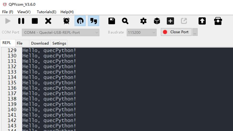

Step 5: Observe the Execution Result
After reconnecting the USB serial port, the command interaction interface will periodically print Hello, quecPython! every 1 second. This indicates that the main.py script has been successfully auto-started.

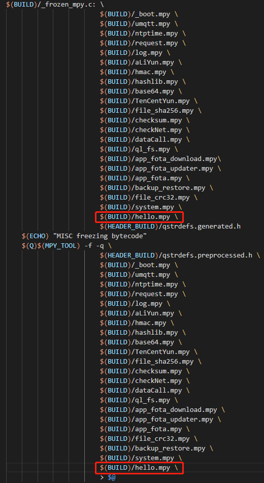

Step 3: Modify the Compilation Script
Open services\microPython\ports\quectel\core\Makefile and add $(BUILD)/hello.mpy \ to the dependency files and execution commands of $(BUILD)/_frozen_mpy.c, as shown in the following figure:
Please note the backslash \ at the end of $(BUILD)/hello.mpy \.
In the Makefile, when splitting one command into multiple lines, a backslash \ needs to be added at the end, and no characters, including spaces, can appear after the backslash \.

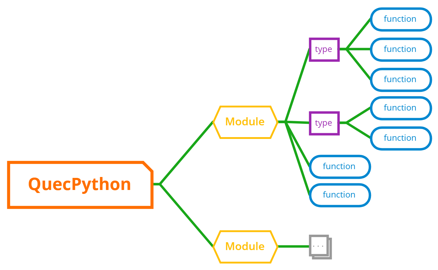

3.1 Classification of Module Interface Levels
From the above figure, we can see that the QuecPython module interface can be divided into three categories: module, type, and function.
The hierarchical relationship between the three is also obvious:
  • There can be multiple modules under QuecPython.
  • Each module can have multiple types or functions.
  • Each type can have multiple functions.
Taking the machine module as an example, machine.Pin and machine.UART belong to the type category.
Under the type category are the specific functions, such as Pin.value() used to set the high or low level of GPIO.
We can enter the following commands in the QPYcom REPL window to check their types:
import machine
type(machine)
type(machine.Pin)
type(machine.Pin.value)
The output result is shown in the following figure, which verifies the above statement.

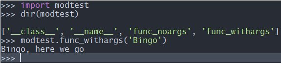

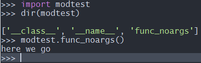

After downloading, restart the module, open QPYcom, and enter the following commands:
import modtest
type(modtest)
dir(modtest)
You will receive an output in QPYcom similar to what is shown in the image in the guide.
On QPYcom, you can see the command output.
From the output, it's clear that the modtest module has been successfully added, but no types or functions have been added yet.

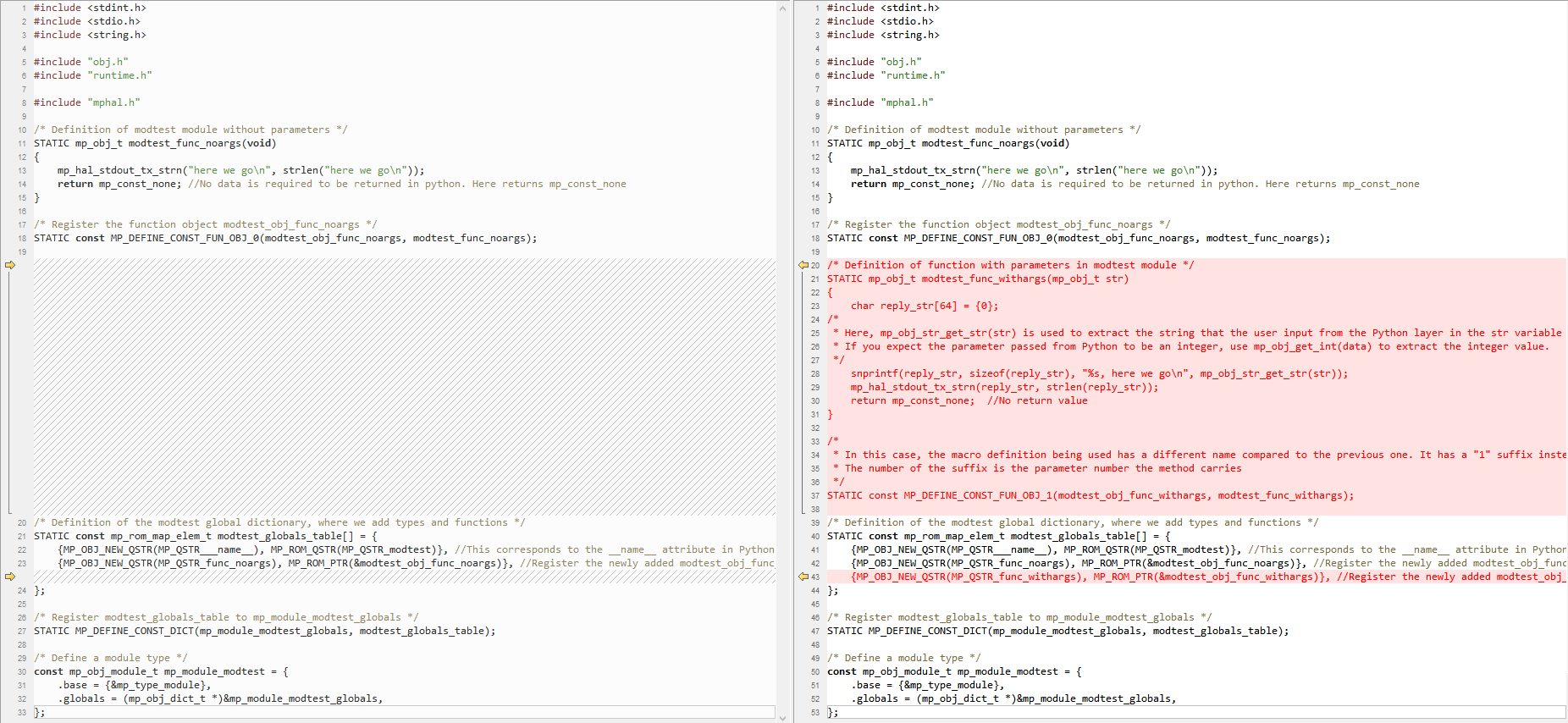

3.3 Adding Functions to the Module
Functions can be divided into two categories: those with no parameters and those with parameters. In the following steps, examples of adding both a function without parameters and a function with parameters to the modtest module will be shown. In Python, they correspond to two methods: modtest.func_noargs() and modtest.func_withargs(argv).
3.3.1 Function Without Parameters

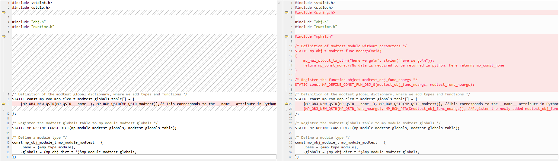

Here adds a method mp_obj_t modtest_func_noargs(void) implemented by C function. Its purpose is to respond to the command modtest.func_noargs() by outputting the string here we go.

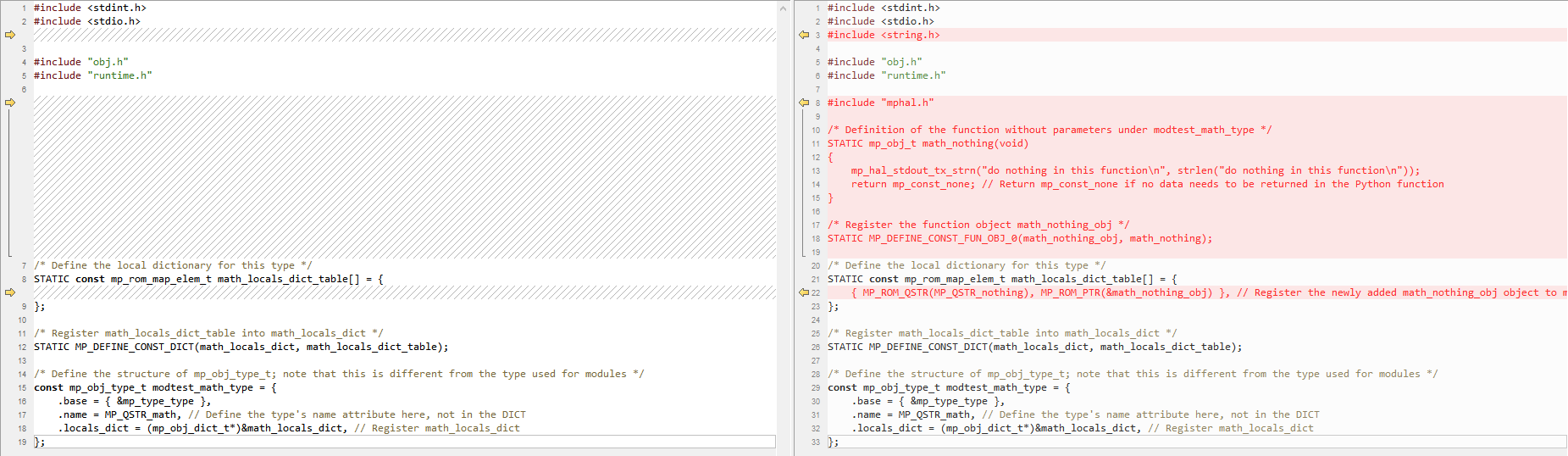

Step 1: Modify the Code
Open the services\microPython\ports\quectel\core\source\modtest.c file and make the following modifications.
The complete code is as follows.

/* Define a module type */
const mp_obj_module_t mp_module_modtest = {
    .base = {&mp_type_module},
    .globals = (mp_obj_dict_t *)&mp_module_modtest_globals,
The difference comparison in the figure below shows the difference between this code and the code in section 3.2 (the current code is on the right, and the red part is the difference):
  • Added the C language function modtest_func_noargs corresponding to the Python module modtest method modtest.func_noargs(). Any C language function corresponding to Python will return the mp_obj_t type. In this example, no value is returned from modtest.func_noargs(). Therefore, the corrsponding C function should return mp_const_none to inform Python that this method has no return value.
  • Use the macro MP_DEFINE_CONST_FUN_OBJ_0 to add a function object modtest_obj_func_noargs, which is the code on Line 18.
  • Register the newly added modtest_obj_func_noargs object to modtest, which is the code on Line 23.
Step 2: Verify the Functionality
After completing *Step 1*, you can compile and download the firmware directly without modifying the script file.
After downloading is complete, restart the module, open QPYcom, and enter the following commands:
import modtest
dir(modtest)
The execution result is shown in the following figure:
From the figure, it can be seen that the execution result of dir(modtest) has listed the func_noargs method.
Executing modtest.func_noargs() outputs the expected string here we go.

The difference comparison in the figure below shows the difference between this code and the code in *Section 3.3.1* (the current code is on the right, and the red part is the difference):
  • Added the C language function modtest_func_withargs corresponding to the Python module modtest method modtest.func_withargs(str). In this example, the string parameters that the user input from the Python layer is returned through mp_obj_str_get_str(str).
  • Use the macro MP_DEFINE_CONST_FUN_OBJ_1 to add a function object modtest_obj_func_withargs, which is the code on Line 38.
  • Register the newly added modtest_obj_func_noargs object to modtest, which is the code on Line 43.
import modtest
dir(modtest)
modtest.func_withargs('Bingo') # with argv: 'Bingo'
From the figure, it can be seen that the execution result of dir(modtest) has listed the func_withargs method.
Executing modtest.func_withargs('Bingo') outputs the expected string Bingo, here we go.

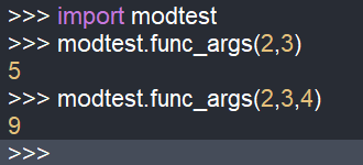

import modtest
modtest.func_args(2,3)
modtest.func_args(2,3,4)
The result is shown in the following figure:
From the figure, it can be seen that func_args function can be called with different number of arguments passed.

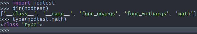

Step 4: Verify the Functionality
After completing *Step 3*, you can compile and download the firmware.
After downloading, restart the module. Open QPYcom and enter the following commands:
import modtest
dir(modtest)
type(modtest.math)
The execution result is shown in the following image:
From the image, we can see that a type named math is added.

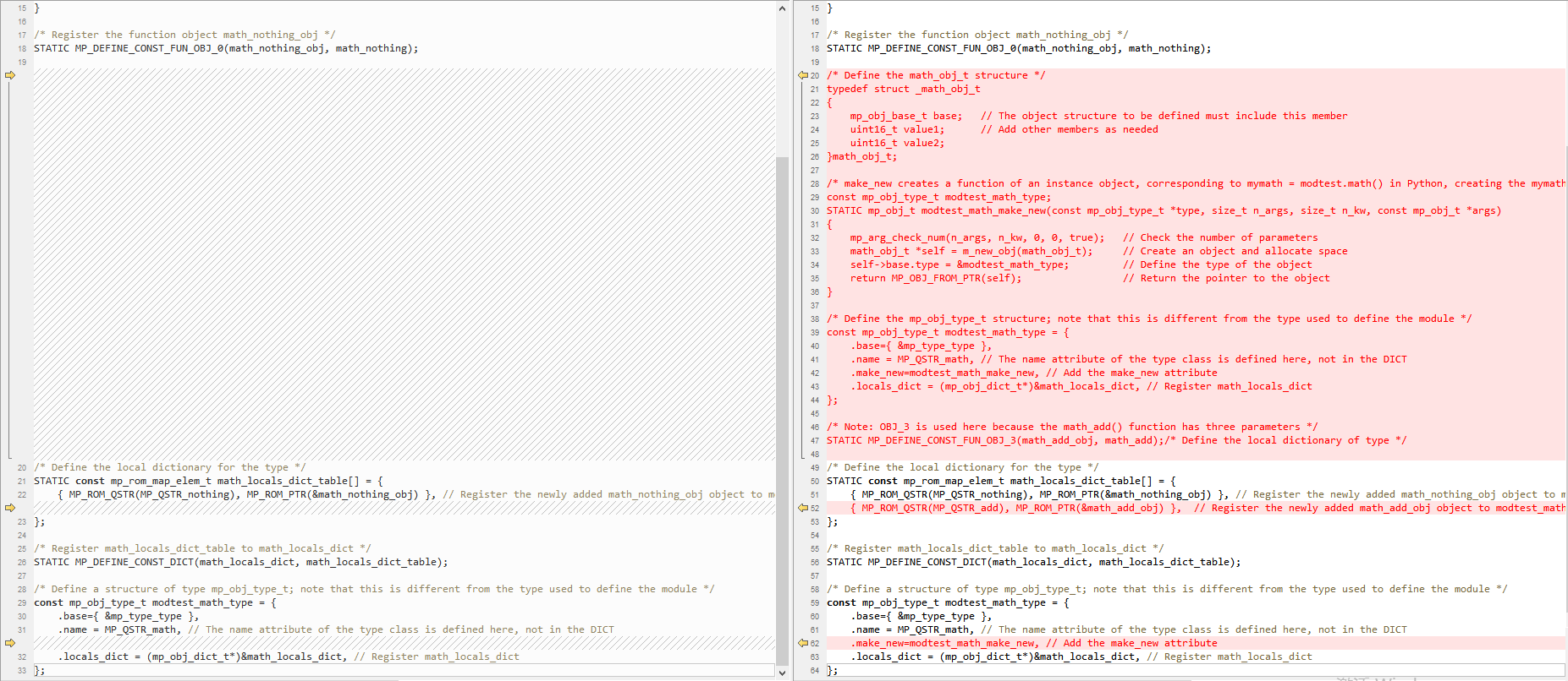

3.5.1 Function Without Parameters
Here, we add a C function called mp_obj_t math_nothing(void).
Functionality: When entering modtest.math.nothing() in the command prompt, it outputs the string do nothing in this function.
Here adds a method mp_obj_t math_nothing(void) implemented by C function. Its purpose is to respond to the command modtest.math.nothing() by outputting the string do nothing in this function.
Open the services\microPython\ports\quectel\core\source\modtest_math.c file and make the following modifications.
The complete code is as follows:

The difference comparison in the figure below shows the difference between this code and the code before the modification (the current code is on the right, and the red part is the difference):
As can be seen from the figure, adding a function without parameters to the type is the same as adding it to the module, so no further explanation is needed.

After completing the above three steps, let's see the differences between the code in this section and the code before the modification.
The red font in the following figure is all the code we added.
