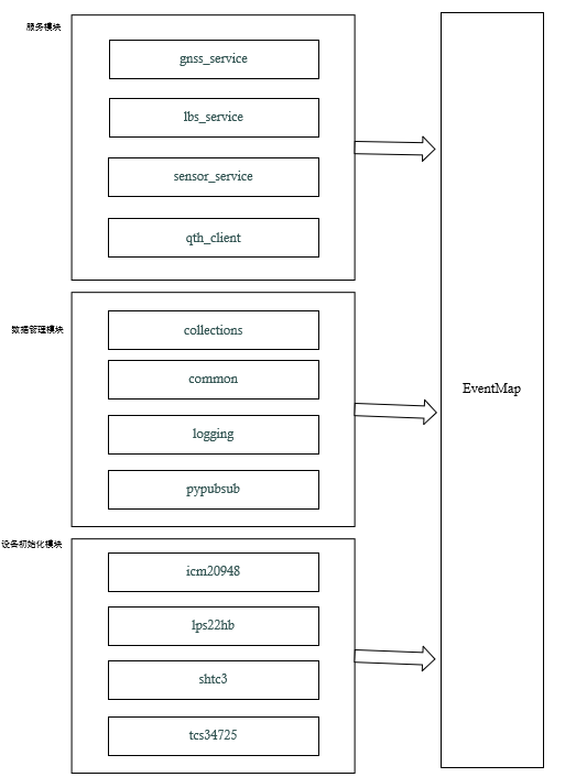

Software design
Software framework
  • Software Design Diagram

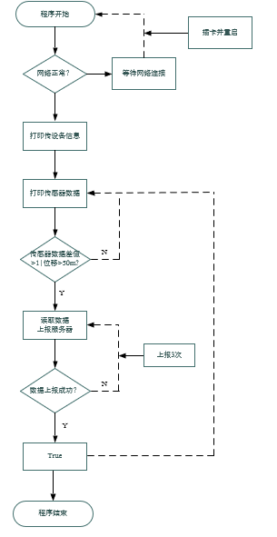

  • Business initiation process

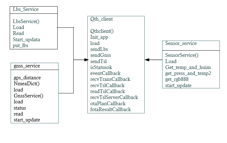

Service module
  1. Lbs_Service: Provides Lbs data location service
  2. gnss_Service: Provides gnss data location services
  3. Sensor_Service: Provides sensor data detection services
  4. Qth_client: Provides data upload and callback services
The relationship diagram between each service and client is as follows:

    def start_update(self):
        prev_temp1 = None
        prev_humi = None
        prev_press = None
        prev_temp2 = None
        prev_rgb888 = None
        while True:
            data = {}
            try:
                temp1, humi = self.shtc3.getTempAndHumi()
                logger.debug("temp1: {:0.2f}, humi: {:0.2f}".format(temp1, humi))
                if prev_temp1 is None or abs(prev_temp1 - temp1) > 1:
                    data.update({3: round(temp1, 2)})
                    prev_temp1 = temp1
                if prev_humi is None or abs(prev_humi - humi) > 1:
                    data.update({4: round(humi, 2)})
                    prev_humi = humi
            except Exception as e:
                logger.error("getTempAndHumi error:{}".format(e))
            utime.sleep_ms(100)
            try:
                press, temp2 = self.lps22hb.getTempAndPressure()
                logger.debug("press: {:0.2f}, temp2: {:0.2f}".format(press, temp2))
                if prev_temp2 is None or abs(prev_temp2 - temp2) > 1:
                    data.update({5: round(temp2, 2)})
                    prev_temp2 = temp2
                if prev_press is None or abs(prev_press - press) > 1:
                    data.update({6: round(press, 2)})
                    prev_press = press
                logger.error("getTempAndPressure error:{}".format(e))
            utime.sleep_ms(100)
            utime.sleep_ms(100)
            try:
                rgb888 = self.tcs34725.getRGBValue()
                logger.debug("R: {}, G: {}, B: {}".format((rgb888 >> 16) & 0xFF, (rgb888 >> 8) & 0xFF, rgb888 & 0xFF))
                r = (rgb888 >> 16) & 0xFF
                g = (rgb888 >> 8) & 0xFF
                b = rgb888 & 0xFF
                if prev_rgb888 is None:
                    data.update({7: {1: r, 2: g, 3: b}})
                    prev_rgb888 = rgb888
                else:
                    prev_r = (prev_rgb888 >> 16) & 0xFF
                    dr = abs(r - prev_r)
                    prev_g = (prev_rgb888 >> 8) & 0xFF
                    dg = abs(g - prev_g)
                    prev_b = prev_rgb888 & 0xFF
                    db = abs(b - prev_b)
                    # If the color difference exceeds 150, it is considered that the color has changed
                    if pow(sum((dr*dr, dg*dg, db*db)), 0.5) >= 150:
                logger.error("getRGBValue error:{}".format(e))
            if data:
                with CurrentApp().qth_client:
                    for _ in range(3):
                        if CurrentApp().qth_client.sendTsl(1, data):
                            break
                    else:
                        prev_temp1 = None
                        prev_humi = None
                        prev_press = None
                        prev_temp2 = None
                        prev_rgb888 = None
            utime.sleep(1)
