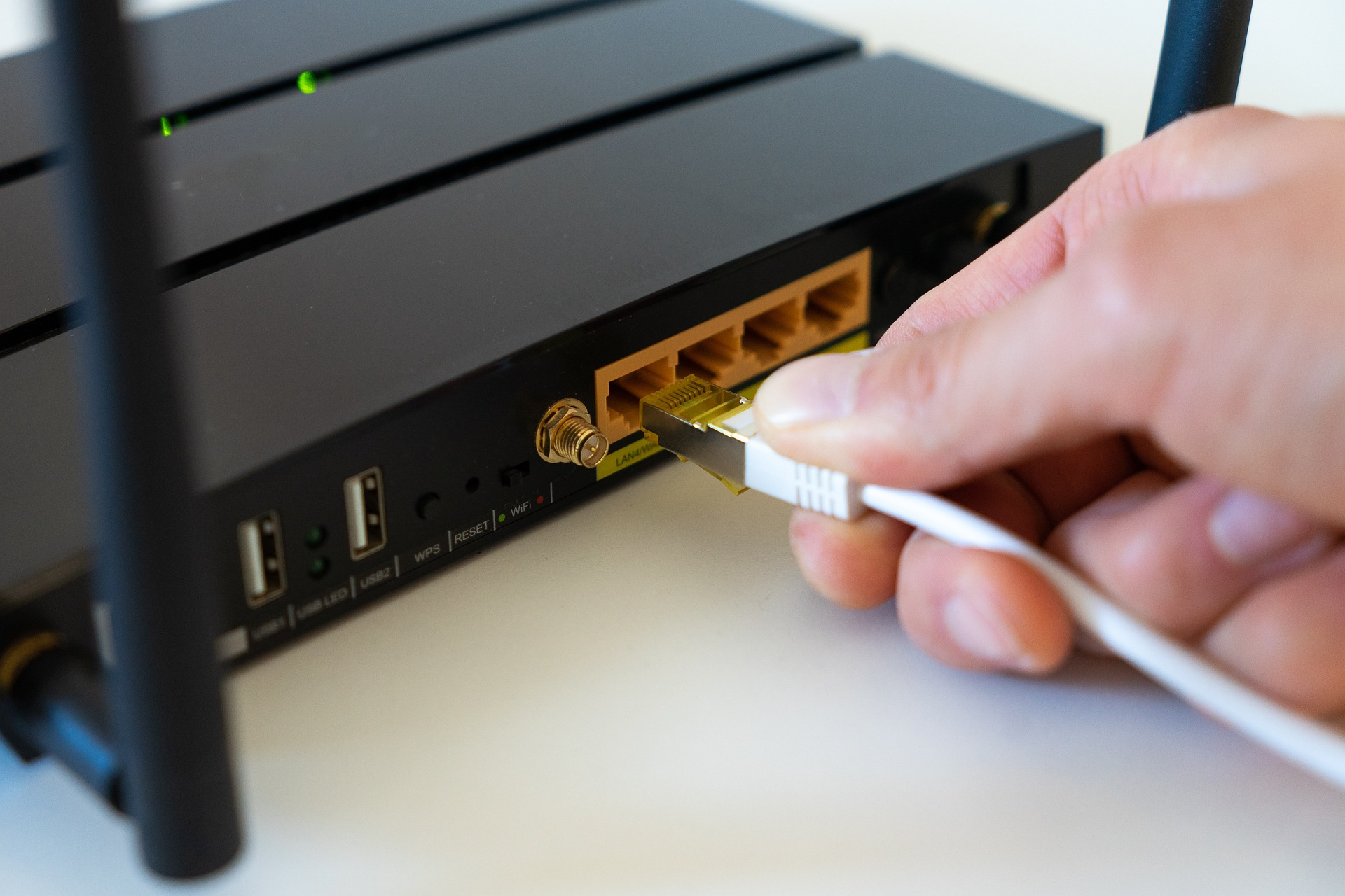

Network Layer
The Network Layer is responsible for transmitting the data collected by devices in the Terminal Layer to the Platform Layer and serving as a bridge for bidirectional communication, sending control commands from the Platform Layer back to the Terminal Layer. From a functional perspective, the Network Layer can be divided into the Access Layer and the Transport Layer.
The Access Layer mainly deals with the functions of the physical layer and data link layer in the traditional OSI model, which essentially involves various methods for devices to access networks and establish interconnections. In terms of media, it can be divided into wired network access and wireless network access. Wired network access methods include Ethernet, serial communication (such as RS-232 and RS-485), and USB, among others. Wireless network access methods include Wi-Fi, Bluetooth, cellular networks (such as 2G/3G/4G/5G, which will be detailed in the next document), and low-power wide-area networks (such as LoRaWAN and NB-IoT), among others.
The Transport Layer is built on top of the Access Layer and includes communication protocols for data reporting and delivery. Compared to internet terminals, most IoT terminal devices currently have limited available resources in terms of processing power, storage capacity, and network speed. Therefore, they tend to use communication protocols that consume fewer resources, such as MQTT (Message Queuing Telemetry Transport) and CoAP (Constrained Application Protocol). These protocols are based on the publish/subscribe model, enabling bidirectional communication between devices and platforms. They also support features like data encryption and compression.

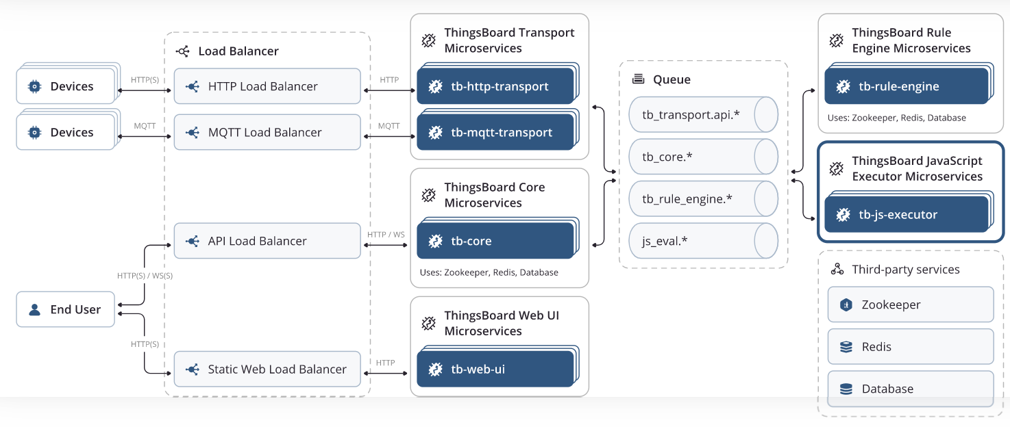

Platform Layer
The Platform Layer is the intermediate layer in the IoT architecture where data is processed, stored, and analyzed. In the past, this layer was typically composed of independent servers. With the development of technologies like microservices and cloud computing, modern IoT platform layers typically include cloud-based system platforms, data analytics engines, and middleware, enabling developers to build and deploy applications on top of the IoT infrastructure.
The Platform Layer serves as an intermediate service that connects devices and industrial applications. It plays a pivotal role in the overall IoT architecture by hosting abstracted business logic and standardized core data models. A typical platform layer not only enables fast device connection but also provides powerful modular capabilities to meet various requirements in industry application scenarios.
In addition to basic device connectivity and management functionalities, mature IoT platform layers often include security management, monitoring and operations, rule engines, and edge computing capabilities to provide added convenience for practical applications.

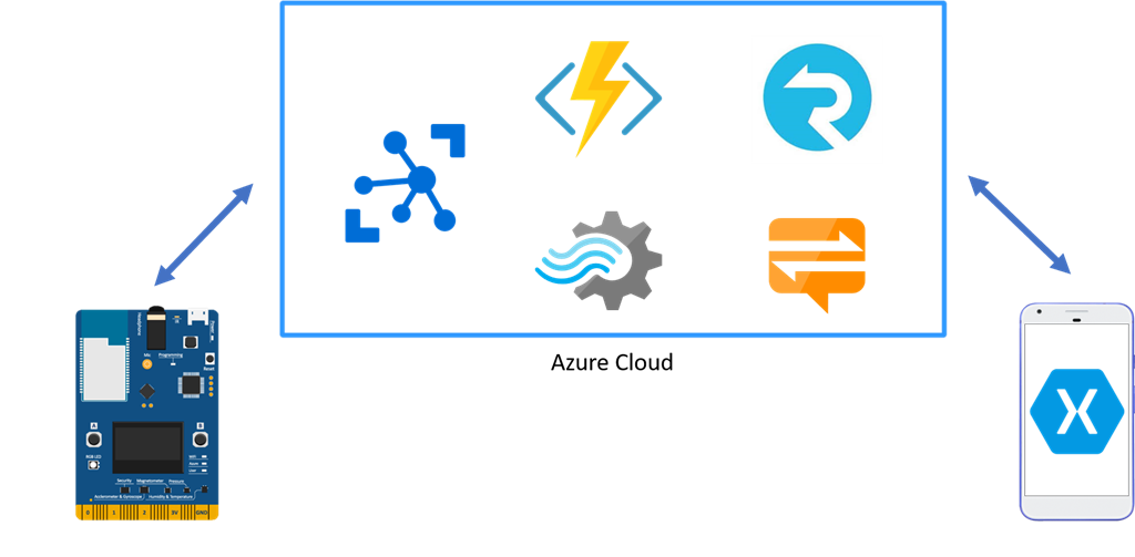

Framework Establishment
Combining the IoT four-layer architecture introduced earlier and the refined requirement details, developers can begin to establish a high-level engineering framework. It can be observed that the main development work of this project is concentrated on the following three components:
- Terminal Layer (Smart Hardware): Develop a smart plug responsible for interacting with the cloud platform and controlling the air conditioner.
- Platform Layer (Core Logic): Deploy the corresponding platform and implement the necessary decision-making and control algorithms.
- Application Layer (Mobile App): Remotely control the air conditioner through a smartphone app and easily query the real-time status of the air conditioner through the app.
In fact, most IoT engineering projects include these three aspects. In simpler terms, IoT development often involves developing the "ends" of data (data generation and consumption) and the "middle" (overall logic).

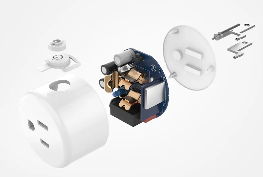

For the device-side development, the goal is to create a Wi-Fi-based smart plug. Therefore, during the development process, developers need to control the Wi-Fi chip or module to implement the necessary network configuration, connection, and bidirectional communication with the cloud platform. Additionally, the smart plug needs to integrate an infrared emitter to control the air conditioner via infrared signals. Developers need to consider factors such as the emission power and installation angle of the infrared emitter, as well as study the infrared codes for controlling the air conditioner.

The actual development process typically starts with hardware design. Based on the clear functional requirements, component selection, and PCB design and manufacturing are carried out. For a smart plug, in addition to meeting the basic functional requirements, factors such as overall size and anti-interference capabilities need to be considered. Therefore, hardware design itself is a high-threshold and highly specialized task.

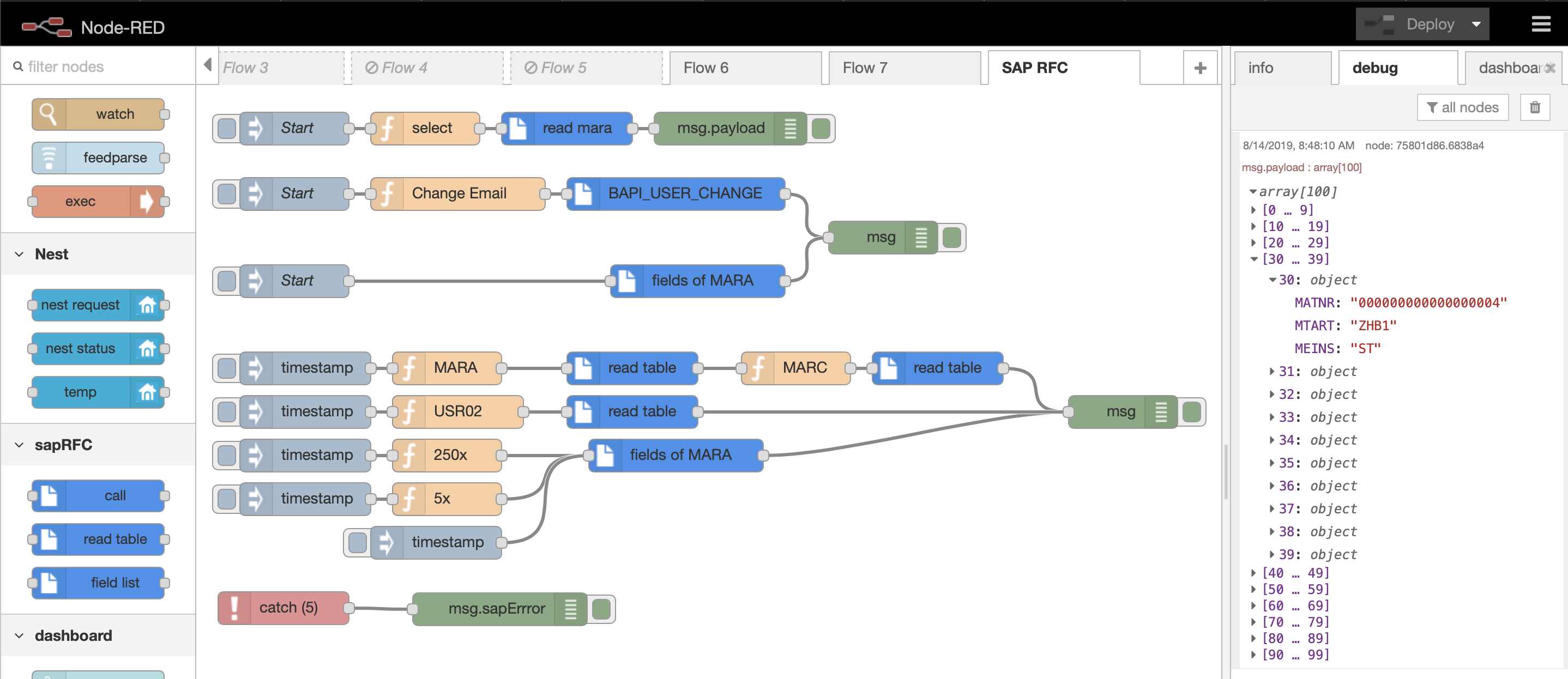

Internet of Things (IoT) and Low-Code
Low-code development technology has played an important role in both the platform and application layers of the Internet of Things (IoT) ecosystem. With low-code development, platform developers and users can easily control the flow of IoT data in the cloud ("cloud orchestration") and quickly build various end-user applications, including mobile apps, through visual interfaces and drag-and-drop operations. This greatly improves efficiency and flexibility while reducing complexity and risk in both IoT platform development and data utilization. With the development of various programming frameworks, low-code development is also being used in device-level IoT development.
