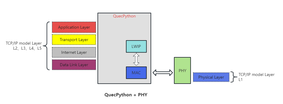

How does QuecPython support Ethernet?
Network communication is generally built on the TCP/IP protocol, and QuecPython supports the lightweight TCP/IP protocol stack - lwIP. According to the Ethernet interface characteristics supported by QuecPython modules, there are two interface types:
- QuecPython module + Ethernet chip (MAC + PHY, such as W5500/CH395).
- QuecPython module + PHY chip (such as YT8512/JL1101).

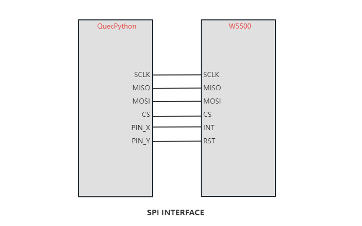

Hardware Structure
The hardware connection diagram of the SPI interface is as follows:
| Pin | Description |
SCLK |
SPI clock pin |
MISO |
SPI master input slave output pin |
MOSI |
SPI master output slave input pin |
CS |
SPI chip select pin, this pin can also be configured customly |
PIN_X |
Custom pin used for data reception interrupt trigger |
PIN_Y |
Custom pin used for chip reset control |

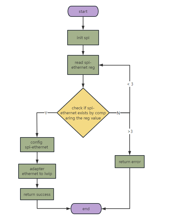

Initialization Process
The initialization process of the NIC is shown in the following figure:

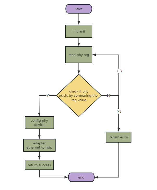

The NIC initialization process after startup is shown in the following figure:

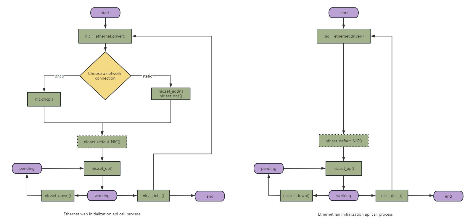

Ethernet API Description
QuecPython provides unified APIs for the device with external SPI-Ethernet or RMII-PHY interfaces.
The Ethernet interface calling process is shown in the following diagram:

Obtain Dynamic IP Address
In most network environments, IP information is obtained through DHCP. The DHCP API provided below makes the module automatically obtain IP information in WAN mode. For example, when an Ethernet NIC is connected to a router for network access, call the API below to obtain the router-assigned IP address.
nic.dhcp()
Set Static IP Address
An Ethernet NIC requires different IP address configurations to access the network in different network environments. Therefore, the API for configuring static IP addresses is provided below, then you can configure and use IP addresses according to the specific network environments. For example, this API is useful for fixing device IP addresses or when there is no DHCP server available for IP address allocation within a network.
nic.set_addr(ip, subnet, gateway)
Set DNS Address
In a network, DNS servers are required for domain name resolution, converting domain names into corresponding IP addresses for communication. The following API is provided to enable you to configure DNS server addresses according to your environments.
nic.set_dns(primary_dns, secondary_dns)
Enable NIC
Enable the NIC as needed. In this case, the data on the NIC is processed, facilitating the management of the NIC.
nic.set_up()
Disable NIC
Disable the NIC as needed. In this case, the data on the NIC will not be processed, facilitating the management of the NIC.
nic.set_down()
Get NIC Configuration
Query the current NIC configuration to operate and display the NIC. For example, when using a specific NIC for network communication, you must bind the NIC. In this case, you must get the NIC configuration.
nic.ipconfig()
Configure Default NIC
The default NIC is effective for module network communication and network forwarding.
- For socket communication by the module, the module will search for the router and match the corresponding NIC for sending. If no NIC is bound for sending, the network will be sent through the default NIC. If the default NIC does not exist, an error will be reported and the operation will exit.
- For network forwarding in a multi-NIC environment, when determining which NIC to use for forwarding non-local data, if there is no default NIC, the data will be discarded directly. If a default NIC is configured, the data will be forwarded through the default NIC.
nic.set_default_NIC(ip)
