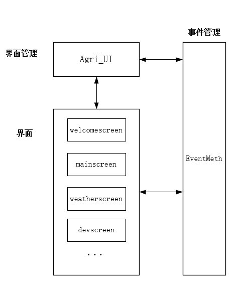

Software designt
Software framework
Software Design Diagram

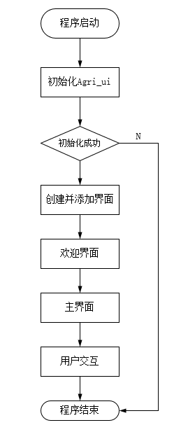

Business system startup process
image-20250205112309962

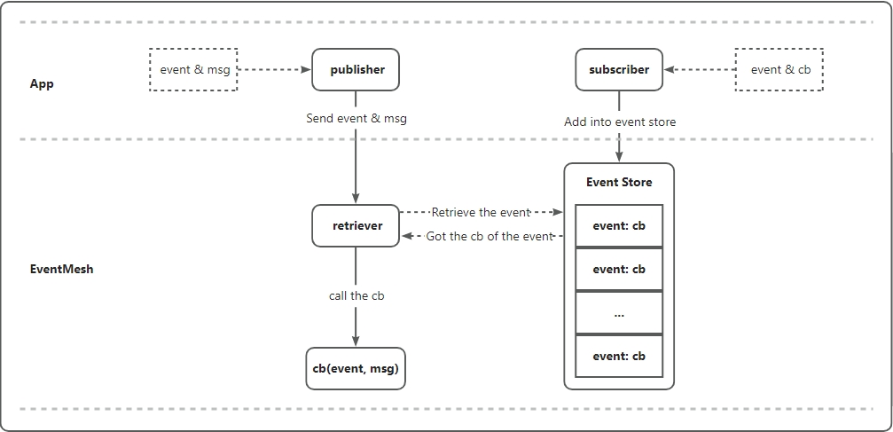

Event management
Collaboration between various modules is achieved through the EventMet event management class EventMeth event management class provides publishing and subscribing of events, as well as synchronous and asynchronous sending of messages. The framework is shown in the figure:
The definition of event management class is as follows:
class EventStore(object):
def __init__(self):
        self.map = dict()
        self.log = None
    def append(self, event, cb):
        self.map[event] = cb
    def fire_async(self, event, msg):
        if event in self.map:
            _thread.start_new_thread(self.map[event], (event, msg))
            if self.log:
                self.log.info("ASYNC executed (event) -> {} (params) -> {} (result) -> {}".format(event, msg, None))
    def fire_sync(self, event, msg):
        res = None
        try:
                res = self.map[event](event, msg)
        except Exception as e:
            usys.print_exception(e)
        if self.log:
            self.log.info("SYNC executed (event) -> {} (params) -> {} (result) -> {}".format(event, msg, res))
        return res
event_store = EventStore()
def subscribe(event, cb):
    subscribe event and cb
    return event_store.append(event, cb)
def publish(event, msg=None):
    publish event and msg
    return publish_sync(event, msg)
def publish_async(event, msg=None):
    异步发送
    return event_store.fire_async(event, msg)
def publish_sync(event, msg=None):
    同步发送
    return event_store.fire_sync(event, msg)
  1. EventMesh is an application framework based on subscription and publish mechanisms, where users can subscribe to any topic of interest, which represents an event.
  2. At the same time as subscribing to the topic, it is also necessary to register a callback (event_cb) function to handle the generated events.
  3. Users can post the event anywhere it occurs and carry the message content. At this point, the callback function registered by the subscriber will be called and the event will be processed.

Screen module
screen.py defines a Screen class as the base class for all interfaces, which is defined as follows:
class Screen(object):
    """Abstract class of screen"""
    def __init__(self):
        super().__init__()
        self.style_siyuan_14_red = None
        self.style_siyuan_16_blue = None
        self.style_opa_btn = None
        self.style_siyuan_26 = None
        # Some code is omitted here
    def create_style(self):
        create style
        # Interface style, background color: 3a5283
        style_screen = lv.style_t()
        style_screen.init()
        style_screen.set_bg_color(lv.color_make(0x3a, 0x52, 0x83))
        style_screen.set_bg_opa(255)
        self.style_screen = style_screen
        # The style of the left menu bar
        style_cont_menu = lv.style_t()
        style_cont_menu.init()
        style_cont_menu.set_radius(0)
        style_cont_menu.set_bg_color(lv.color_make(0x28, 0x39, 0x5c))
        style_cont_menu.set_bg_grad_color(lv.color_make(0x28, 0x39, 0x5c))
        style_cont_menu.set_bg_grad_dir(lv.GRAD_DIR.VER)
        style_cont_menu.set_bg_opa(255)
        style_cont_menu.set_border_color(lv.color_make(0x21, 0x95, 0xf6))
        style_cont_menu.set_border_width(0)
        style_cont_menu.set_border_opa(0)
        style_cont_menu.set_pad_left(0)
        style_cont_menu.set_pad_right(0)
        style_cont_menu.set_pad_top(0)
        style_cont_menu.set_pad_bottom(0)
        self.style_cont_menu = style_cont_menu
The Screen class provides common methods required for all screen objects, such as creating screens and displaying status bar information (operator name, signal strength, system time, battery level, etc.). QuecPython uses NXP's GUI Guider as a graphical interface design tool, generates the style code for this section.
All script files ending with _screen. py implement a class inherited from class Screen(), which is the code implementation corresponding to the screen that needs to be displayed. The main content of the interface code is provided by the GUI Guider tool is automatically generated and then slightly modified, mainly by modifying the object initialization method __init__() and the control event handling callback function __xxx_event_cb().
GUI startup
The load_screen event is subscribed to in the start() method of the class AgriUi (object) class in the Agri_ui.py script file.
example:
class AgriUi(object):
    def __create(self):
        for screen in self.screens:
            screen.create()
    def start(self):
        self.__create()
        EventMesh.subscribe("load_screen", self.__route)
        EventMesh.publish("load_screen", "WelcomeScreen")
        utime.sleep(2)
        EventMesh.publish("load_screen", "MainScreen")
    def __route(self, topic, meta):
            if screen.name == meta:
                lv.scr_load(screen.screen)
Thestart() method in the above code is used to launch the graphical interface of the smart agriculture control panel, and its workflow is as follows:
  • Call the __create() method to create metadata for each screen interface.
  • Call the EventMesh. subscribe() method to subscribe to an event named load_screen. When the event occurs, call the __route() method to process it.
    The __route() method matches the corresponding interface object based on the message carried when publishing the event, that is, the name of the screen interface, and calls lvgl's lv.scr_load()method to load the new interface.
    Observant readers will notice that in every class implemented in the screen interface script file, there will be statements similar to self.name=" MainScreen" in its object initialization method __init__(). This statement records the name of the screen interface.
  • The EventMesh.publish("load_screen", "WelcomeScreen") statement is used to trigger the first interface display, which is the welcome interface. Then wait for the welcome interface to display for 2 seconds, creating a good visual experience.
  • After the welcome interface ends, use the EventMesh.publish("load_screen", "MainScreen") statement to trigger the display of the main interface.
At this point, the graphical interface of the smart agriculture control panel has been launched, and the subsequent interface switching is controlled by the user's touch.
In summaryAgri_ui.py performs all initialization work for the smart agriculture control panel, including lvgl initialization and MIPI LCD initialization; At the same time, it provides a graphical interface for adding screen objects and a GUI launcher. The screen object adder is used to add all possible screen objects that may need to be displayed in the application, and the GUI launcher is used to launch graphical interface functionality.

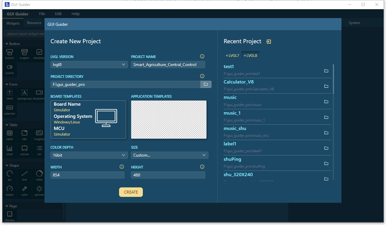

Graphic interface design
As mentioned earlier, QuecPython uses NXP's GUI Guider as a graphical interface design tool, GUIDER not only enables interface layout design, but also automatically generates QuecPython code. Click here to view the tutorial on using the GUI Guider tool.
Layout and background settings
Create a smart agriculture project and choose a suitable layout template and background design. This stage will start with a blank layout design, selecting a blank template and setting the resolution to 854 * 480.
Draw screen
This section will start drawing the various modules in the homepage.

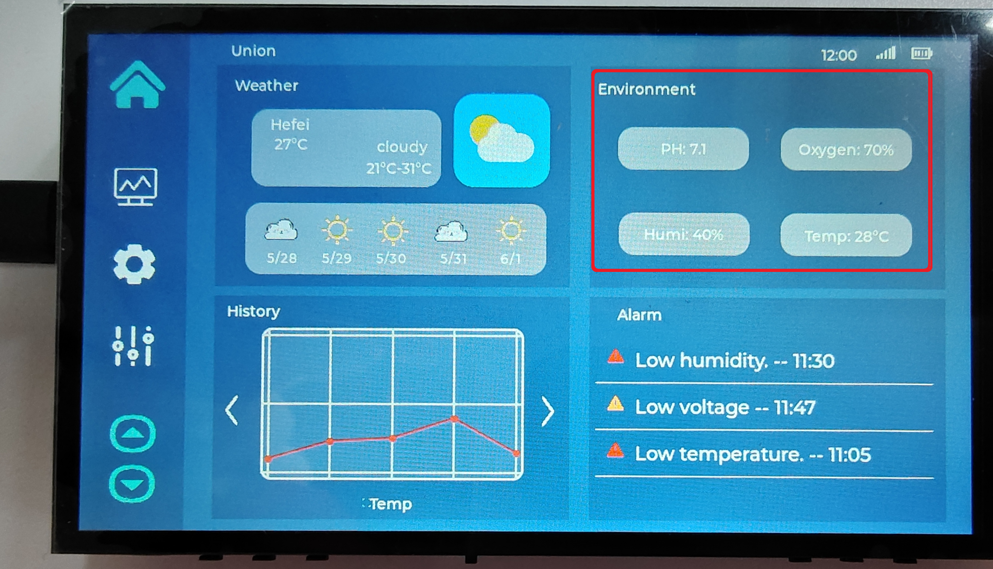

5.Common environmental parameters display:
  • component: container,label。
  • Data display block: Display key parameters in the form of independent "blocks" or "cards", such as current readings of soil pH, soil temperature, oxygen and carbon dioxide concentrations, etc.
When designing the environmental parameter display on the upper right side of the smart agriculture graphical interface in GUI Guider software, the 'label' and 'container' components can be used to clearly display key information such as soil pH value, oxygen concentration, soil moisture, and carbon dioxide concentration. The following are detailed design steps:
  1. Environment parameter container:
    • Place a container component on the upper right side of the interface as a wrapping element for all environment parameters. This container will help organize and separate different parameter displays.
  2. Parameter label:
    • For each environmental parameter, use a separate label component to display the parameter name and value. For example, one label displays "Soil pH value: 7.1", another label displays "Oxygen concentration: 50%", and so on.
    • The label of parameter names can use smaller fonts, while the label of numerical values can use larger or bolded fonts to highlight numerical information.
  3. Parameter update mechanism:
    • If possible, design a data update mechanism to periodically refresh the displayed environmental parameter values. This can be done by binding the 'label' component to the data source and setting a timer to update the values.

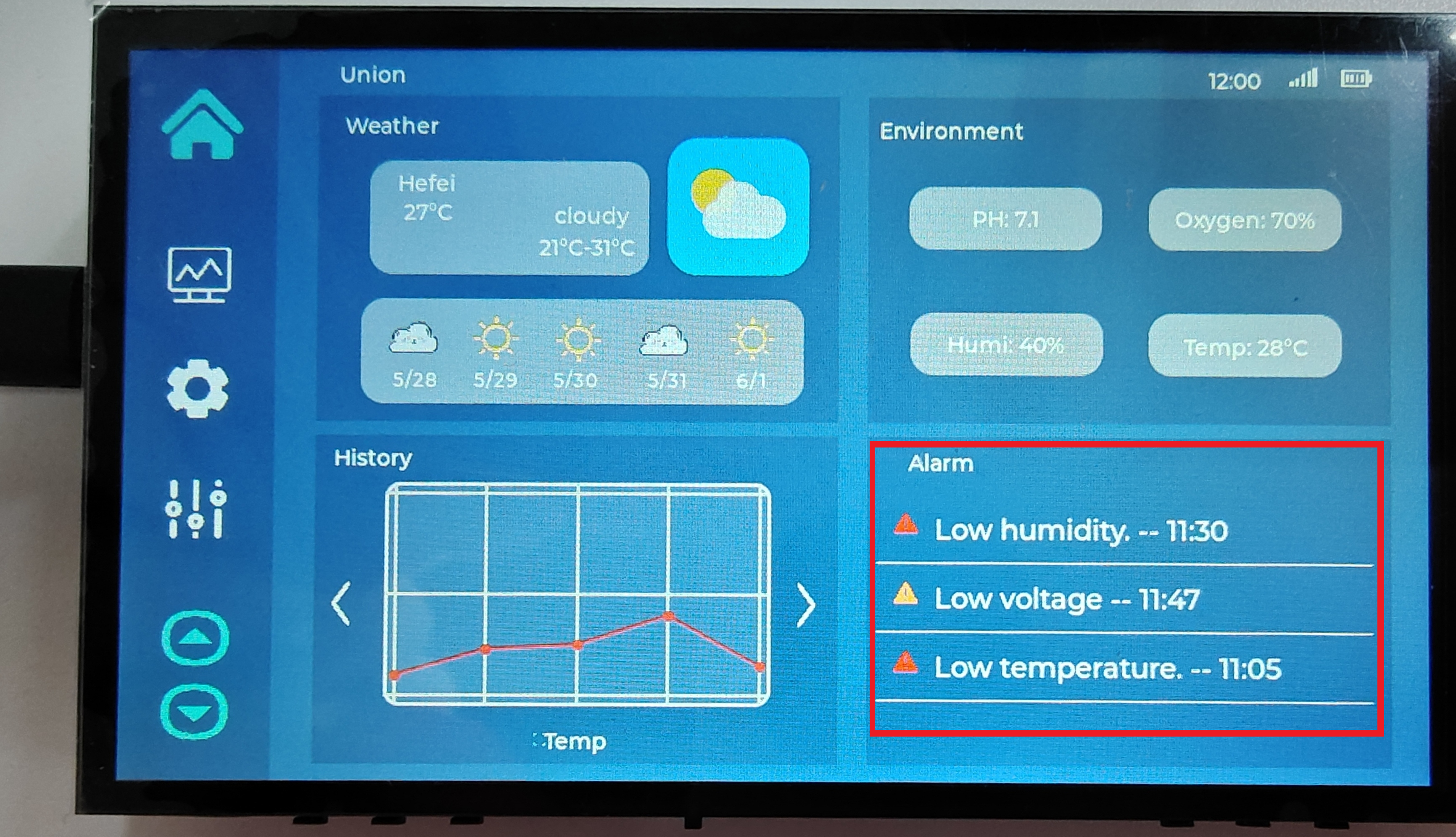

6.Alarm Information Area:
  • component: container,label,table。
  • list view: Display recent alerts and warnings in the form of a list or log.
  • priority indication: Use color coding or icons to indicate the priority or severity of alarms.
  • interactivity : Allow users to click on the alarm to obtain more details or confirm and clear notifications.
When using GUI Guider software to design the lower right alarm information area of the smart agriculture graphical interface, you can use label container and table components are used to effectively display alarm titles and specific alarm information. This area will provide users with critical security and system status updates. The following is a detailed design process:
  1. Alarm information container:
    • Place a container component on the bottom right side of the interface as the main framework for the alarm information area. This container will contain the title and specific content of the alarm information.
    • Set the size of the container to ensure sufficient space to display alarm information while maintaining coordination with other elements on the interface.
  2. Alarm Information Title:
    • Use a label component to display a title at the top of the container, such as Alarm Information.
    • Choose eye-catching and easy to read fonts and sizes to ensure that users can clearly identify the functionality of this area.
  3. Alarm Information Table:
    • Use the table component below the container to list specific alarm information. This can include columns such as alarm time, type, status, etc.
    • Adjust the column width and row height of the table to ensure that all information is clearly visible.
  4. Alarm information style:
    • Set appropriate background, border, and font colors for the table component to maintain consistency with the overall interface style.
    • Consider using different colors or icons to represent different levels of alerts, such as red for emergency alerts and yellow for warnings.
  5. Alarm information update mechanism:
    • Design a data update mechanism that allows thetable component to dynamically display the latest alarm information. This may require binding the table component to the backend data source and setting a scheduled refresh.
  6. Responsive design:
    • Ensure that the container and its table and label components can be appropriately scaled at different screen sizes and resolutions.
    • On a small screen, it may be necessary to adjust the layout of the table to ensure the readability of information.
