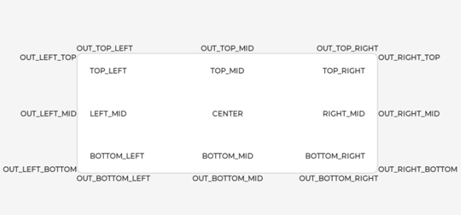

Alignment
You can use the align property to set the alignment of a control relative to its parent container. Quecpython provides the following two methods:
  • obj.align(lvgl.ALIGN.type,x,y)
  • obj.set_align(lvgl.ALIGN.type)
If you want to set it to center, use a shortcut method obj.center().
LVGL supports the following alignment types:
image-20230726163115149
For example, the following code will shift the object by 10;20 px from the center of its parent:
