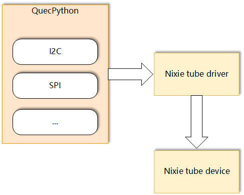

Driver Block Diagram
- Microcontroller (MCU): The microcontroller is the core of the system and is responsible for processing and executing all operations. It sends commands to the display driver IC through an interface based on the information to be displayed.
- Display Driver IC: The display driver IC (also known as a digital display driver IC) is an integrated circuit specifically designed to drive digital displays. It receives commands from the microcontroller and drives the digital display to display the corresponding numbers or characters based on these commands.
- Interface (SPI, I2C, etc.): The interface is the communication path that connects the microcontroller and the display driver IC. The microcontroller sends commands to the display driver IC through the interface.
- Digital Display: The digital display is the display device driven by the display driver IC. It displays the corresponding numbers or characters based on the commands from the display driver IC.
In a basic digital display system, the relationship between these components can be summarized in the following steps:
- The microcontroller generates commands based on the information to be displayed.
- The microcontroller sends the commands to the display driver IC through the interface.
- The display driver IC receives these commands and drives the digital tube to display the corresponding numbers or characters.
This is the working principle of a basic digital display system. Different digital display systems may have different specific implementations, but most systems follow this basic pattern.

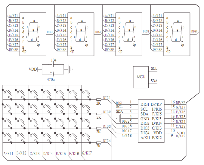

TM1650
TM1650 is a dedicated circuit for LED (light-emitting diode display) driver control with a keyboard scanning interface. It integrates MCU input/output control digital interface, data latch, LED driver, keyboard scanning, brightness adjustment, and other circuits.
It supports two display modes: 8-segment × 4 digits and 7-segment × 4 digits.
It can communicate with QuecPython series modules through I2C.
The tm1650 script has encapsulated the basic operations of TM1650, and users can directly call interfaces such as Tm1650.show_num, Tm1650.show_str, Tm1650.show_dp, etc. to display on the digital tube.
