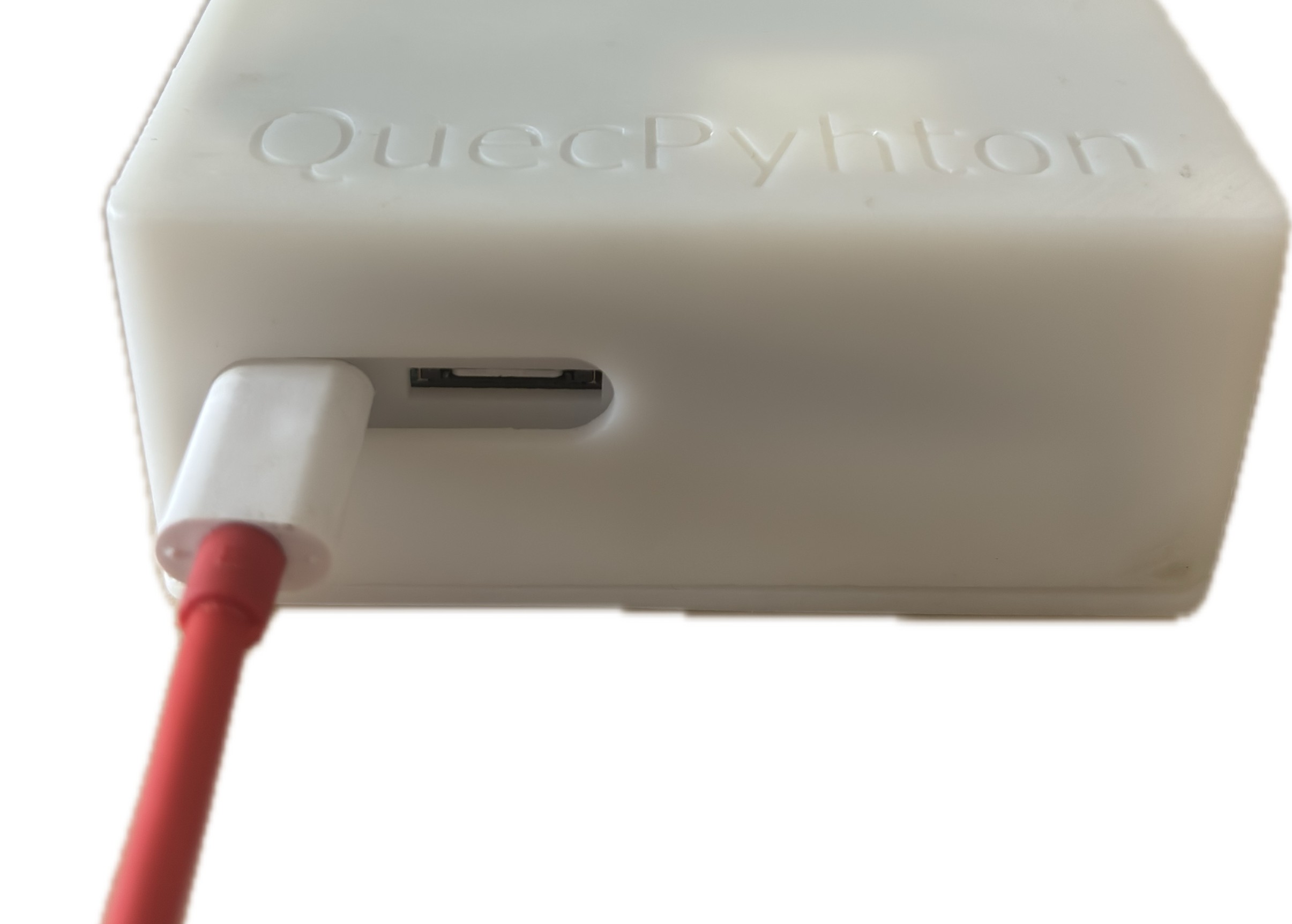

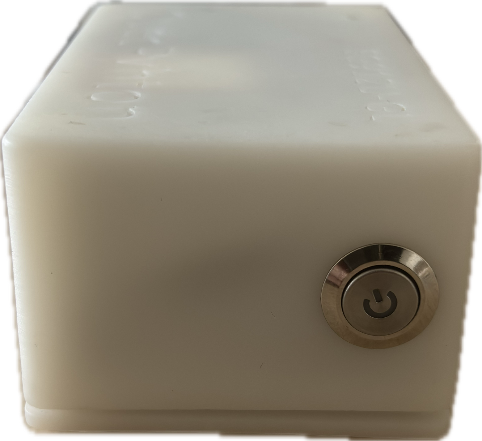

- Power on using any of the following methods:
Method 1: Press the power button on the side of the device.
Method 2: Connect the smart tracker to your laptop or power bank using the included USB-C cable, and the device will automatically power on.
/usb-c_sim.jpg)

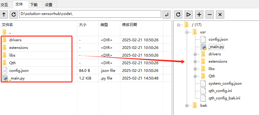

Script Import and Execution
- Refer to this chapter Import all files from the
codefolder in the source code directory into the module file system, as shown in the following figure:
- Refer to this chapter Execute the main program file
_main.py. - Refer to this chapter Stop the program from running.

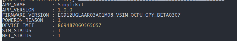

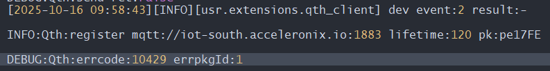

Program Startup
After executing the _main.py script, the program starts running and prints the dialing information, including the dialing status, IP address, DNS server address, device number, etc
Data Detection
After starting to run, startup information will be printed.

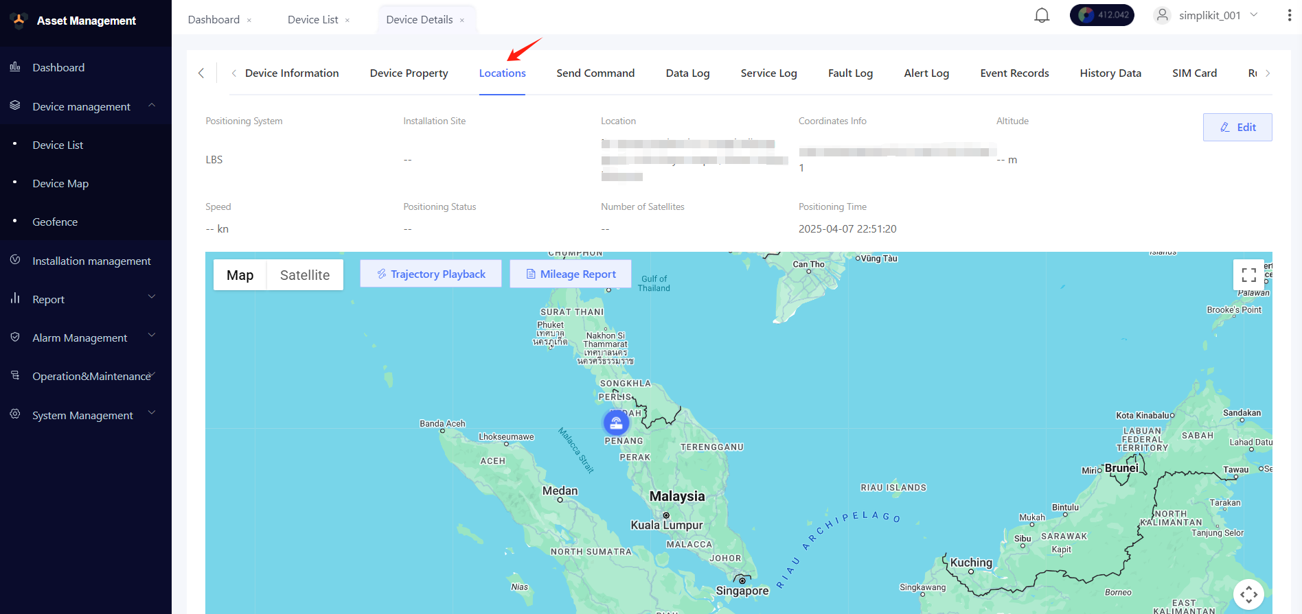

View device location
Click to visit the cloud platform,Click Details in the device list to open the device details page.
Go to the Location tab to view LBS location data.
Note: The location is updated every 30 minutes. If you need to manually refresh, please click the refresh button in the application control panel, then reload the page to view the updated location.

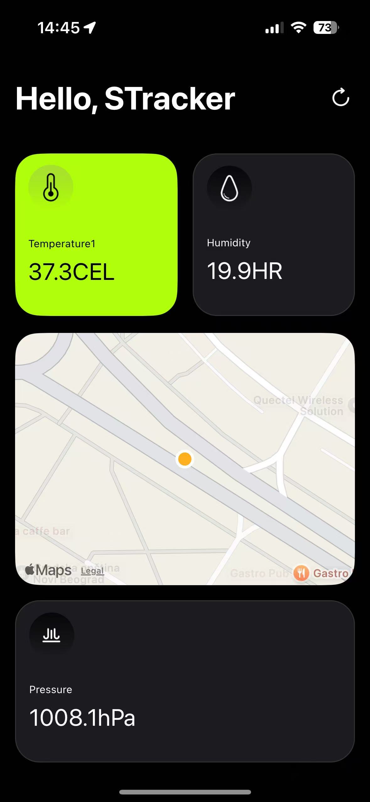

View and manage sensor data

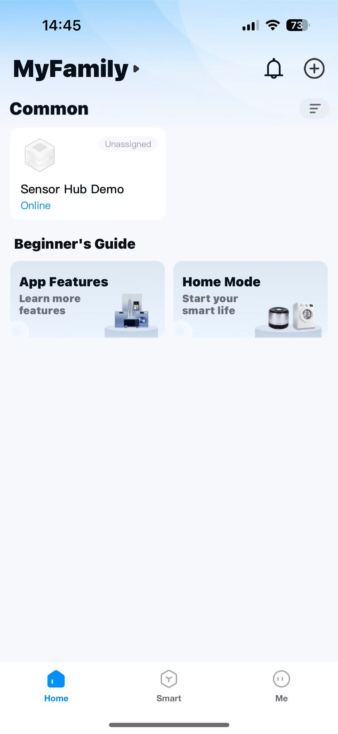

- When the device is online, click on the device in the Wonderfree app to enter the control panel.
- View the real-time sensor data and LBS location data of the smart tracker.
- If you need to update sensor data or LBS location, click the refresh button in the upper right corner of the control panel.
