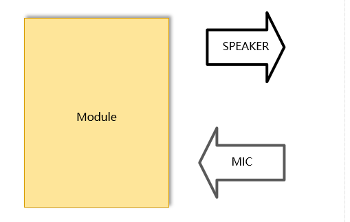

Built-in Codec
Codec (audio codec chip) is used for digitalizing and restoring audio signals. Audio codecs generally consist of two parts: ADC (analog-to-digital converter) and DAC (digital-to-analog converter). ADC is responsible for converting analog signals (such as microphone, line input, etc.) into digital signals (such as PCM, etc.), and DAC is responsible for converting digital signals (such as I2S, SPDIF, etc.) into analog signals (such as headphones, speakers, etc.). Some modules have a build-in codec to input and output audio analog signals directly, as shown in the following diagram:

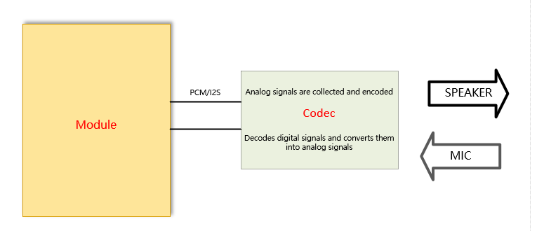

External Codec
When the module does not have a built-in codec or when two codecs need to be used, an external codec can be connected via the PCM or I2S interface. In this case, the external analog input and output signals need to be connected to the codec, as shown in the following diagram:

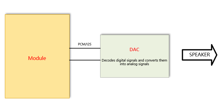

External DAC
An audio DAC is an audio digital-to-analog converter, which is a device that converts digital signals into analog signals. It can convert audio data stored in digital media such as CDs, DVDs, MP3s, etc. into analog signals that can be output through speakers or headphones, allowing people to hear sound. The module can connect an external DAC via the PCM or I2S interface, as shown in the following diagram:

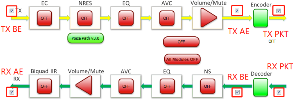

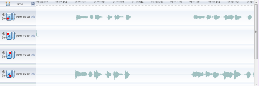

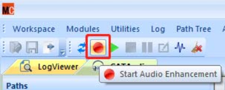

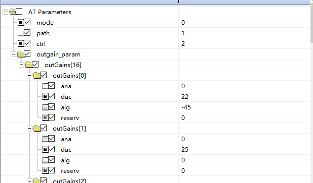

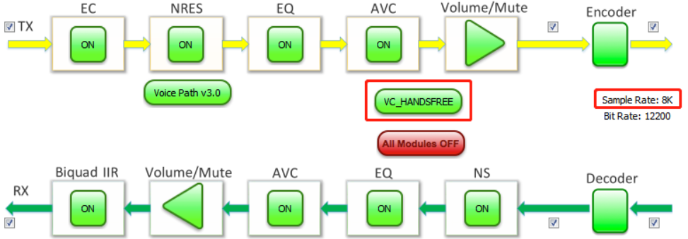

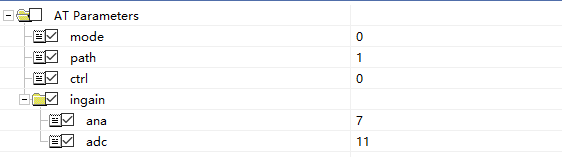

Audio Parameter Calibration
The audio calibration tool can adjust the input gain (including analog gain and ADC gain), output gain (including analog gain, DAC gain, and algorithm gain), and sidetone gain of the built-in codec. The validation modes include real-time mode and non-real-time mode, which can be controlled via APIs. In the non-real-time mode, the adjusted parameters will take effect in the next playback/call. The tool can be adapted to various application scenarios and various input/output channels. After adjusting the audio parameters with the audio tool, they can be directly fixed in the NV file as the default audio parameters.

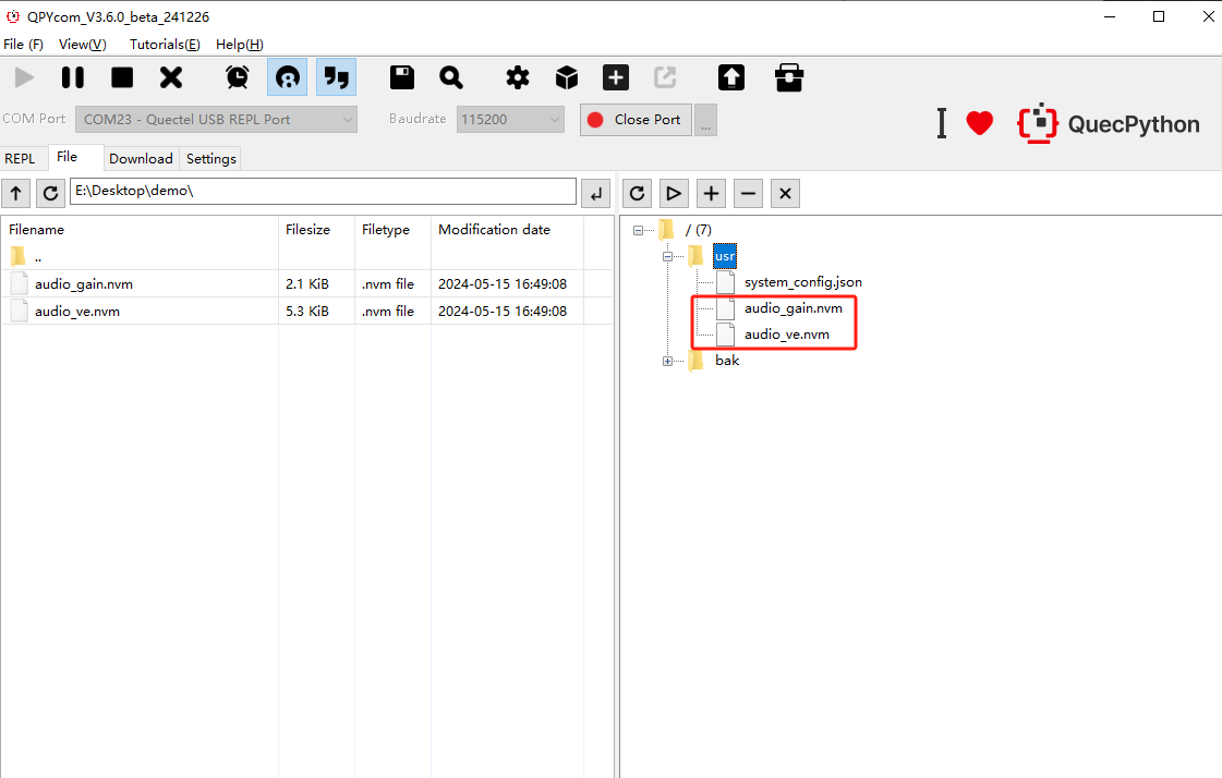

Obtain NV Files and Usage Methods
Obtain NV Files:
Please contact Quectel technical support for assistance.
Usage Methods:
Using the QPYCom tool, after connecting the module, open the repl port,place the NV file in the 'usr' directory and restart the module to take effect.Currently, only the EC600M series, EC800M series, EC600N series, and EG810M series support this method.For other models of modules, please contact Quectel technical support team.
