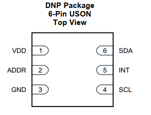

Package Specification
OPT3001 (6 pins) sensor package specification:
| Pin Number | Pin Name | Description |
| 1 | VDD | Power supply. |
| 2 | ADDR | Address pin. |
| 3 | GND | Ground. |
| 4 | SCL | I2C clock pin. |
| 5 | INT | Interrupt pin. |
| 6 | SDA | I2C data pin. |

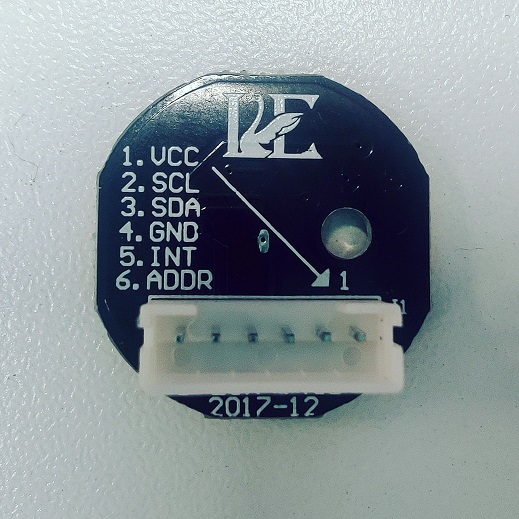

Picture of real product:

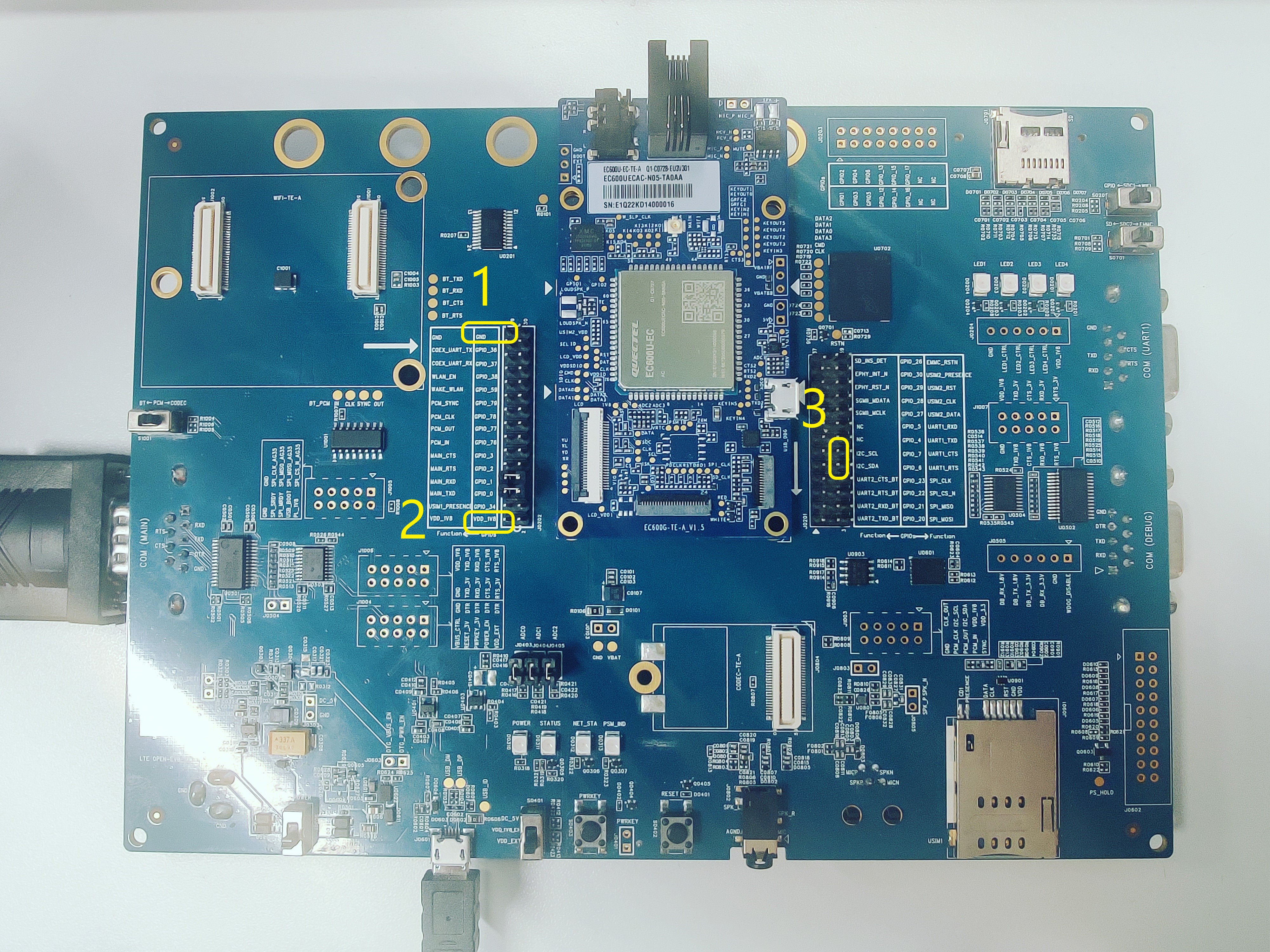

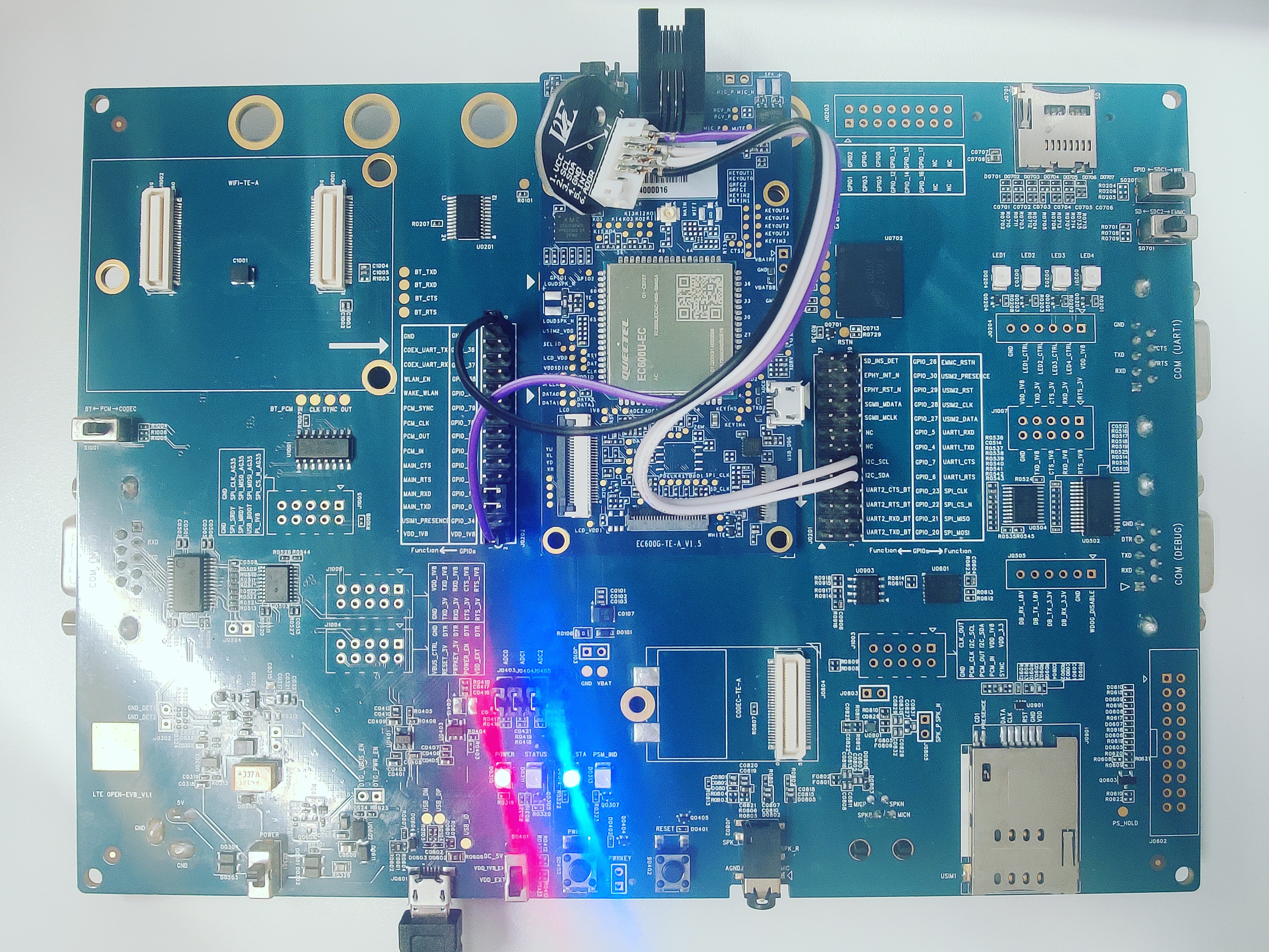

In this section, the OPT3001 sensor needs to be connected to the EVB with four wires. The specific wiring is as follows: connect GND to the ground, VCC to VDD_1V8 (as marked with "2" in the figure below), and SCL and SDA to I2C_SCL and I2C_SDA (GPIO_7 and GPIO_6, as marked with "3" in the figure below). INT does not need to be connected in this experiment.
The following figure shows the actual picture after the connection is completed.
