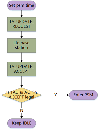

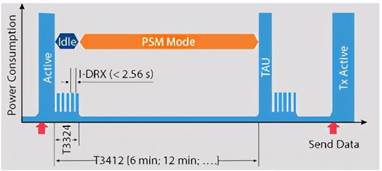

PSM: PSM mode is a power-saving mode specified by 3GPP. In this mode, the module wakes up periodically and performs business operations, and spends the rest of the time in PSM. During PSM mode, the module's behaviors and power consumption are similar to those when the module is sht down.

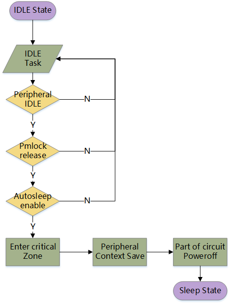

Sleep Detection Mechanism:
During the initialization of RTOS, a task named IDLE with a priority of 0 will be established by default. This means that this task will only be scheduled when no other tasks are running in RTOS. The sleep-related operations are performed in the IDLE task. In this IDLE task, RTOS detects whether the module's peripherals are in use, whether there is data from the network, or other sleep conditions. If the sleep conditions are met and autosleep is enabled, the module will enter sleep mode.

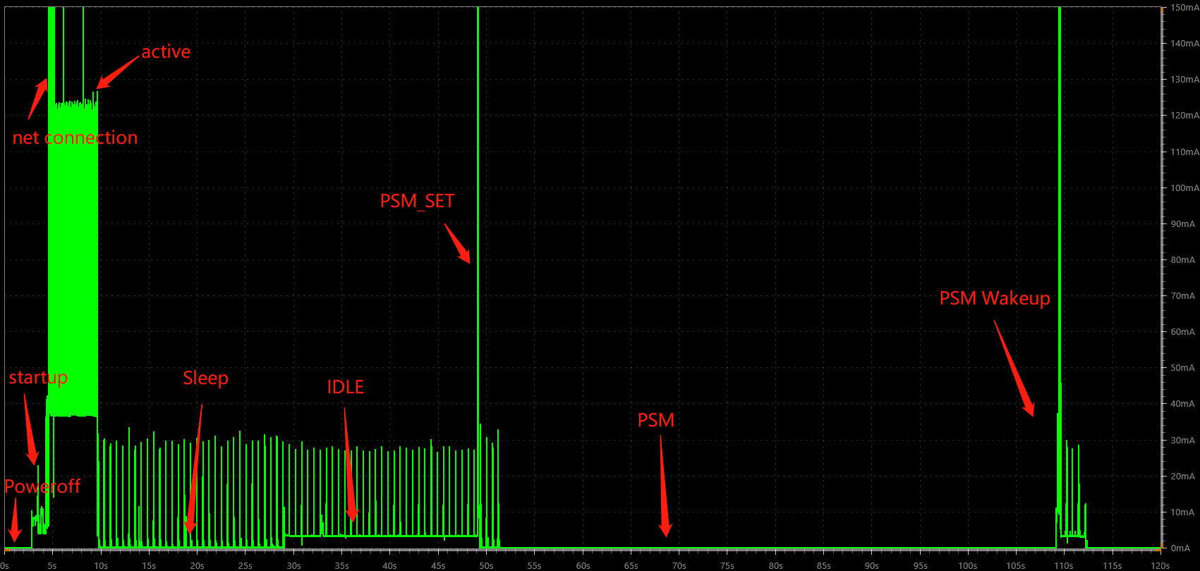

Typical Power Consumption Characteristics:
consumption_all

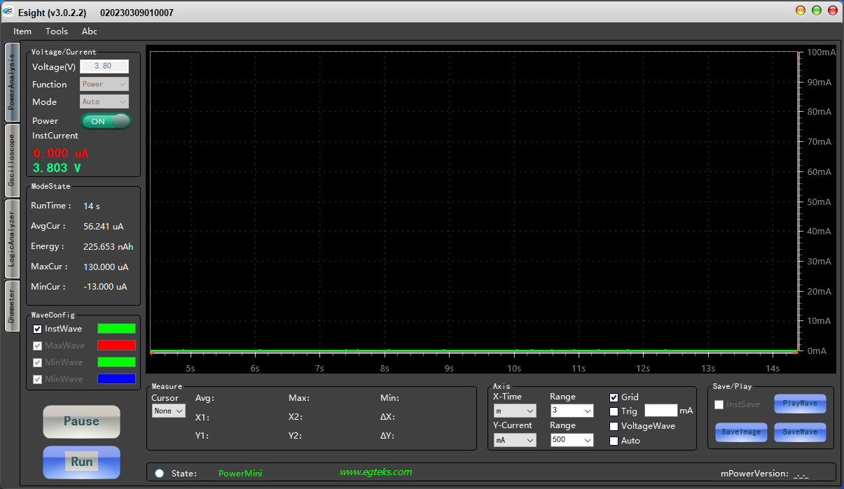

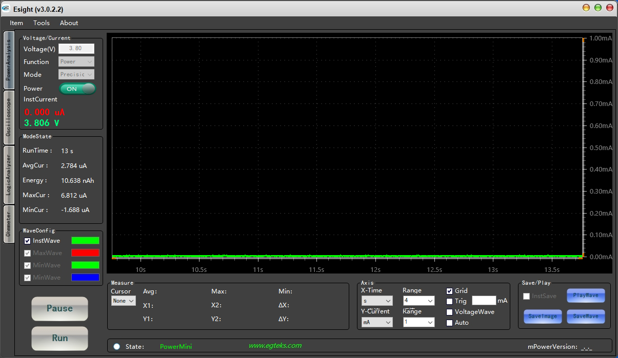

Generally, when measuring the idle current, the network needs to be set to CFUN0 to disable the RF feature. The current measured at this time is the idle current of the module. Under normal circumstances, its characteristics are generally approximately linear, as shown in the following figure:

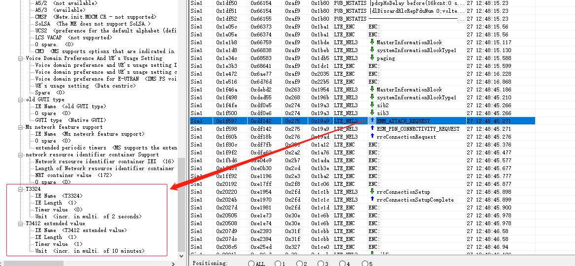

DRX Period & Paging

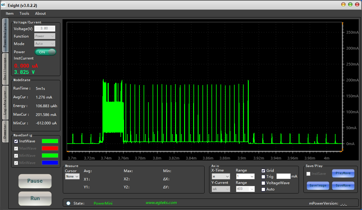

Base station paging: When the network status changes/UE needs to be called/ETWS or CMAS system sends an alert, the base station will initiate paging to the module, notifying the module in IDLE state to start communication.
DRX period: When the module network does not have an RRC connection, it periodically listens to the base station paging to ensure timely response when the base station paging arrives. This listening period is called the DRX period. The DRX period is generally 32 ms, 64 ms, or 128 ms. The shorter the DRX period, the more times the base station signal is listened to within the same time, the higher the power consumption, but the faster the response to paging. Conversely, the longer the DRX period, the lower the power consumption, but the slower the response to paging.

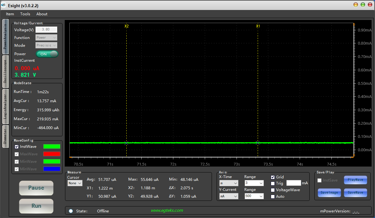

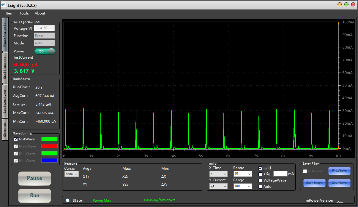

Attached is the current consumption chart in sleep (CFUN1) mode, and the regular peaks in the chart are paging, and the period is called the DRX period:
Paging

Paging
To avoid the ping-pong effect (referring to the situation where the network state switches back and forth, causing more system resource occupation and network performance degradation), the base station does not release the RRC connection immediately after the network service is completed. Instead, it waits for a period of time to ensure that the RRC connection does not need to be reestablished when performing service again in a short time. The duration of the RRC connection varies depending on the network environment and carrier strategy. When there is no network data and the RRC is not released, the module does not enter sleep mode. Therefore, the duration of the RRC connection significantly affects the module's power consumption.

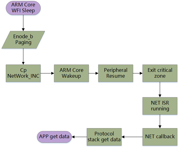

Network Data & Phone Call Wake-up
Network data & phone calls: The base station notifies the module of a call request through paging, and then the CP (or DSP) wakes up the CPU through a callback and notifies the CPU that there is network data coming. The CPU starts to move the air interface data into the protocol stack buffer, and at this time, the upper-layer application (socket or phone call) can obtain the network data from the protocol stack.

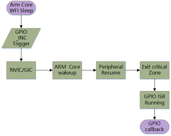

GPIO Interrupt Wake-up
Prerequisites for GPIO availability: GPIO is kept powered during module sleep, and the interrupt controller connected to it is not turned off.
When the GPIO hardware is triggered, the interrupt controller connected to it responds immediately and wakes up the CPU. The CPU will resume the context of the peripheral and then exit the critical zone. At this time, the ISR detects that the GPIO interrupt has been triggered and immediately executes the GPIO interrupt function (generally, it sends a message to trigger the callback bound to the GPIO), and finally triggers the callback function bound to the GPIO.

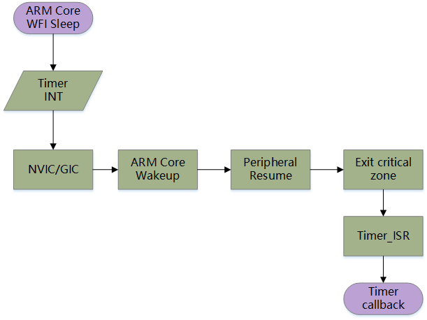

Timer Wake-up
When the timer times out, it triggers the interrupt bound to the system timer. The interrupt controller responds immediately and wakes up the CPU. The CPU resumes the context of the peripheral and then exits the critical zone. Finally, the callback bound to the timer is triggered by ISR.

PSM is a mode with lower power consumption than regular sleep mode, but its operation requires support from the network.
To enable PSM, a request needs to be sent to the base station (carrying timer information through ATTACH or TA_UPDATER). If the base station supports entering PSM, it will send the timer information in the corresponding REQUEST. It should be noted that the actual PSM parameters will use the values sent by the base station, which may not be the same as the values requested by us.
The module will configure the timer time based on the values sent by the base station. When the module enters IDLE and the ACT timer times out, the module will shut down the CPU and all RF functionalities. At this time, it is equivalent to a partial module shutdown, but leaving some wake-up sources on, usually including ACT, TAU timers, and PSM_INT. The power consumption generally drops to the microampere level. Since the base station has recorded that the UE is using PSM, it will not disconnect from the UE. If the next time the UE is powered on in the same cell, it does not need to dial up, but directly use the original IP and other information, thus further reducing power consumption.
When the PSM TAU timer times out, the RTC alarm expires, or the PSM_INT wake-up source is triggered, the module will be awakened. Since the CPU (including SRAM) and PA are powered off, the module cannot restore the running state before sleep, but needs to go through the startup process again. After startup, network services can be performed, and when the network service is completed and RRC is released, the ACT timer starts counting, and when it times out, it enters PSM.
Complete PSM Process
PSMProcess
Finally, under the influence of two timers, the module undergoes sleep and wake transitions periodically. However, it is only during the wake phase that it can engage in network operations; during the sleep phase, it remains unresponsive to network paging.
Current Consumption Characteristics are as follows (in this example, wake-up occurs every 1 minute):
Timer
ACT and TAU Timers
ACT, also known as T3324, starts counting when the module completes network operations (i.e., upon RRC connection release). When the timer expires, the module immediately enters PSM.
TAU, also known as T3412, starts counting when the module completes network operations (i.e., upon RRC connection release). When the timer expires,it will wake the module up if the module is in PSM.
Their sequential relationship is as shown below:
Timer
Upon receiving the PSM time from the base station, the module immediately sets up an RTC alarm and a timer. The RTC alarm serves as the wake-up source for PSM, and its timeout duration is equal to the value of T3412. In other words, after the period of T3412 time, the module will be awakened by the RTC alarm to enter the next cycle. The timer's timeout duration is set to T3324, and only when it expires is it possible for the module to enter PSM mode. This means that after the RTC alarm wakes the module up, it will remain operational for a duration of T3324.
From this, it is evident that for the module to enter PSM correctly, T3324 must be less than T3412. Otherwise, a situation may arise where the RTC alarm has already timed out, but the module still cannot enter PSM.

Common Troubleshooting

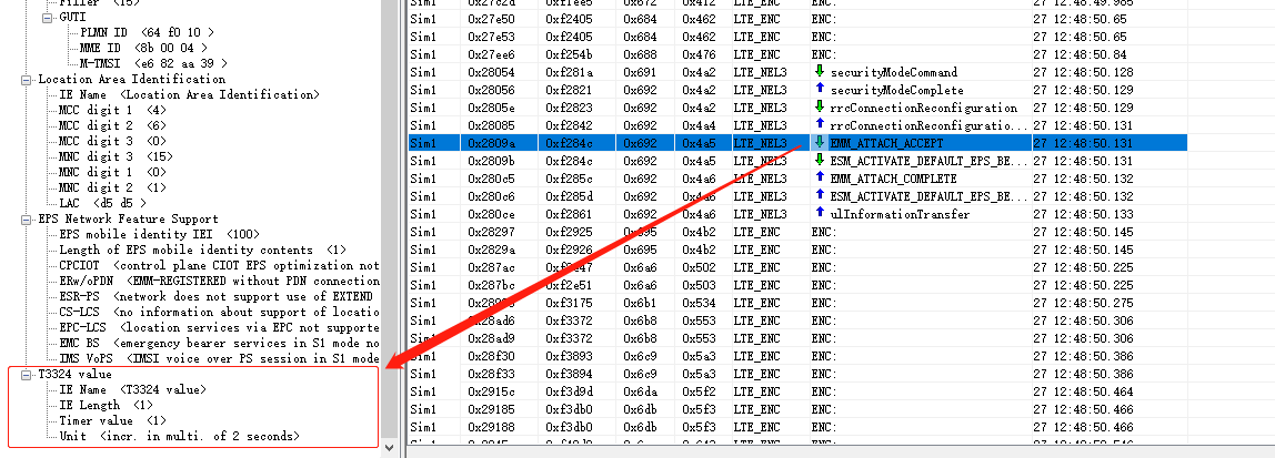

1. Set to PSM and True is returned but the module cannot enter PSM
The base station may not support PSM. To confirm this, check the information sent by the base station in the CP log. The items to check are:
ATTACH_REQUEST
ATTACH_ACCEPT
TA_UPDATE_REQUEST
TA_UPDATE_ACCEPT
In the example below, after the module is set successfully, the REQUEST always contains paired timer information. Pay attention to whether the ACCEPT contains the correct timer information sent by the base station.
Timer
In the example below, PSM cannot be entered because the network environment does not support PSM and the base station only sends only one ACT timer instead of a paired TAU timer:
Timer
2. The module successfully enters PSM, but the sleep and wakeup cycle is different from the set value
Similarly, check the above CP log items. The base station may issue timers with periods different from the set value, and the module will use the values issued by the base station as the actual values.

After the hardware connection of the device under test is completed, do not power on the device and disconnect the USB_VBus to directly measure the shutdown current. At this time, the module is not working, and all the output pins to the external are pulled low or left floating, and the average current consumption remains relatively stable, basically in the uA level.
Measuring Module Sleep Current
After measuring the shutdown current value, press and hold the power key to power on the module. The default power consumption mode of the module when it is powered on is IDLE. Please call the interface related to sleep to make the module enter sleep when it is idle. The operation method can be found in the Autosleep API. After setting to sleep, disconnect the USB. The module cannot enter sleep when the USB is connected.
After entering sleep mode, the module should have a periodic and stable current consumption waveform, which is the DRX period mentioned above, as shown in the following figure:
Because the power consumption of a single DRX period has a certain randomness, the average current consumption of the module should be calculated by selecting several complete DRX periods and taking the average value. In the figure above, three complete periods are selected to calculate the average current consumption during sleep. Power analyzers generally provide the functionality of calculating the average current consumption within a specific time period, so selecting several DRX periods is sufficient.
Measuring the Idle Current of the Module When It Is Powered On
After completing the current consumption test under network connection, reconnect the USB. Give command to the module to disable the RF, the interfaces can be found at net - Work Mode Configuration. After the configuration is completed, disconnect the USB and observe the current consumption. At this time, the module is idle and the RF is disabled, and the current consumed is the lowest level that the module can achieve when it is in sleep mode. The current consumption at this time is generally referred to as the idle current:
The idle current is approximately a straight line, and a segment of average current can be selected.
Measuring PSM Current Consumption
Before measuring the PSM current consumption, please set to PSMand check if it takes effect. The application method and the method to check if PSM takes effect can refer to the previous section PSM.
After confirming that the module enters PSM normally, disconnect the USB and start the test. After waiting for the ACT timer to time out, we can check the idle current in PSM.
As shown in the figure, the idle current in PSM is much lower than that in the normal autosleep mode, and it has similar characteristics and size as the current consumption during module shutdown.
PSM will be periodically awakened by the TAU timer to complete network interaction, so there will be a current consumption peak that matches the TAU period:
Similarly, the average current consumption in PSM needs to be calculated by selecting multiple periods and taking the average value.

2. Timers
Timers, including osTimer, RTC, and hardware timers, will wake up the module when they time out. At this time, the current consumption characteristics are: the idle current meets the requirements, but it cannot remain in sleep all the time. If the timeout time between two timers is too short, the module will not be able to enter sleep.

Troubleshooting approach: Decompose the business logic and turn off the timers one by one. When a specific timer is encountered, observe if the current consumption returns to the expected level. This can help identify whether there is an abnormal wake-up event associated with that particular timer."
