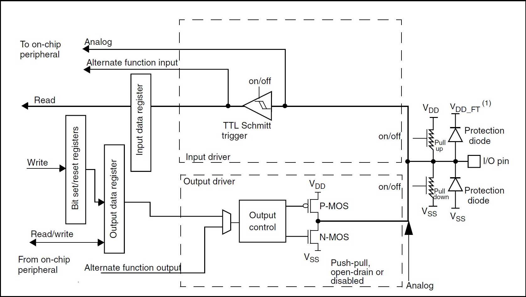

Framework
The GPIO (Abbreviation of General-purpose input/out), a kind of input/output interface for general data, communicates with external electrical components or devices, which can be deployed in micro-processor, micro-controller and other embedded systems.
See basic diagram as below:
GPIO_gpio_basic_structure
I/O pin: The actual HW interface in micro-processor or micro-controller that connects to external device. Each GPIO pin can be programmed as input or output mode.
Protection diode: One special diode that protects the I/O pin in micro-controller or micro-processor from influence caused by voltage kick-out or ESD.
Pull-up/down resistor: It sets the status of GPIO pin in IDLE or in condition of invisible input signal. The Pull-up resistor will connect the GPIO pin to the positive to set it as the default high-level status. While the Pull-down resistor will connect the GPIO pin to the GND to set it as the default low-level status. Both of them will be controlled by register configured by SW.
P-MOS and N-MOS: The circuit with P-MOS and N-MOS will facilitate GPIO with "Push-pull" and "Open-drain" modes.
TTL Schmitt trigger: Process noise or unstable input data. It will eliminate the noise of data signal based on highest threshold and lowest threshold to provide more accurate digital signal.
Output driver: Control the voltage and current of GPIO pin in output mode
Input receiver: Process input signal from GPIO pin. In most cases, one TTL Schmitt trigger will be embedded to eliminate the noise of digital signal.

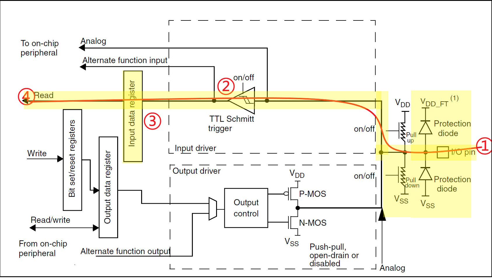

Working mode

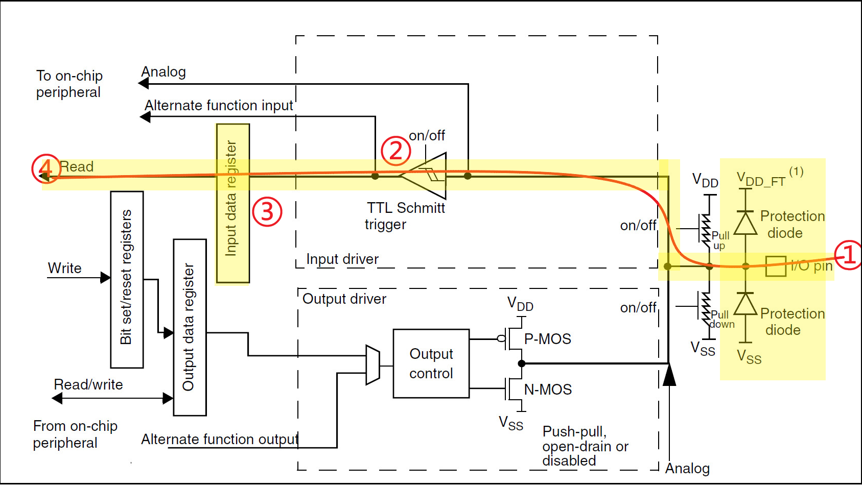

Floating input
Called as Hi-Z, it means the GPIO pin will be floating without being pulled to any logic level. In this status, the GPIO pin can pick up voltage noise easily and read random value. Therefore, please avoid it unless given reason.
gpio_floating
The contents highlighted by yellow background illustrates the data transmission channel. The external level signal will enter the internal chip via the I/O with number ①; After that, reformed by Schmitt trigger with number ②, the signal will arrive at "Input data register" with number ③ and ends at the other terminal (Number ④) of "Input data register". Thus, it is available to read the level change of I/O via internal data bus as you wish.

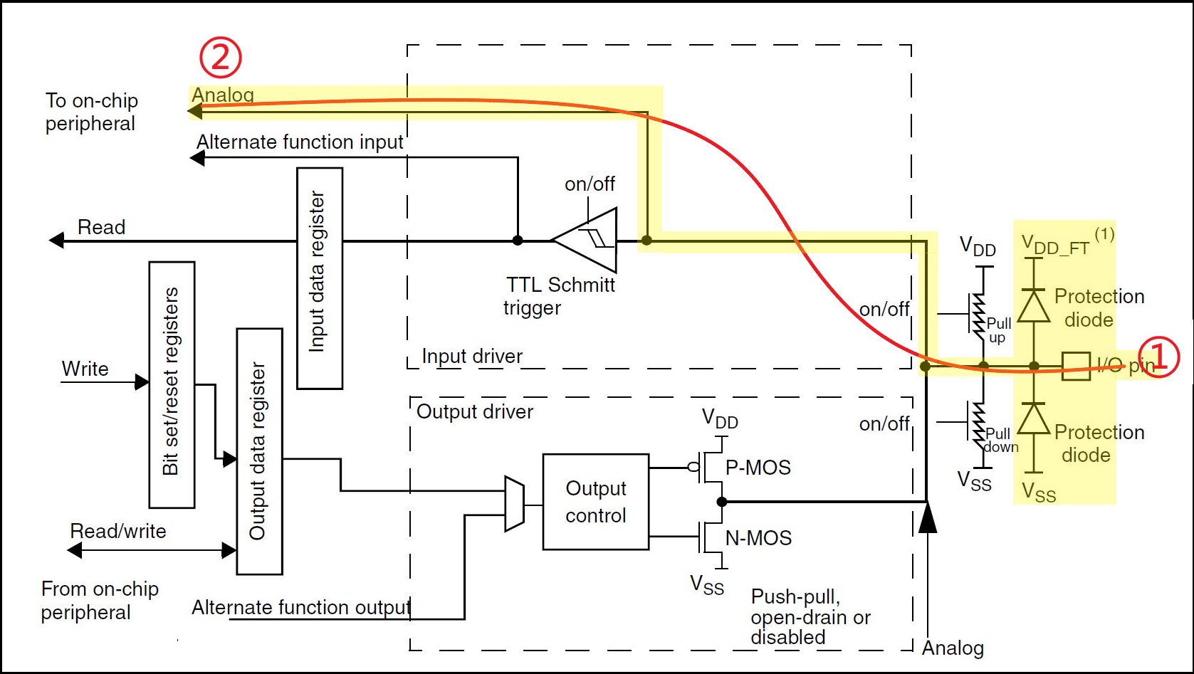

Analog input
There is neither pull-up resistor nor pull-down resistor and the signal will enter analog input channel without going through Schmitt trigger. Normally, it will be used in ADC data sampling.
gpio_analog

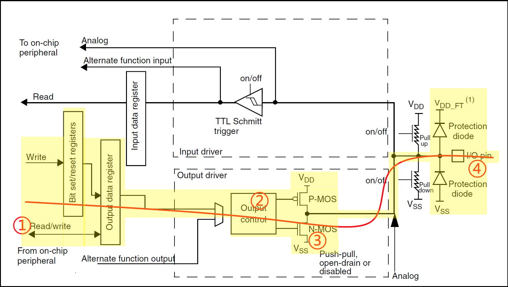

Push-pull output
In Push-Pull output mode, the GPIO pin will drive high level or low level actively. That means the GPIO can not only push the voltage to high level but also pull voltage to low level. This mode can provide powerful driver, which is suitable for load such as LED and motor.
gpio_push_pull
The most prominent characteristic of push-pull output lies in that it can output high level and low level truly. Moreover, it is equipped with driver in both levels.

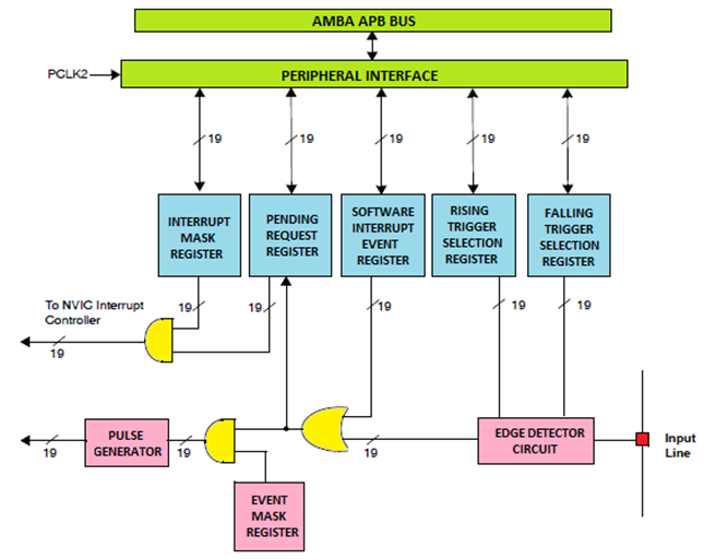

Interrupt Framework
1692426270556
Interrupt Mask Register: This register will mask or disable dedicated interrupt for sake of preventing it from triggering interrupt service routine (Abbreviated as ISR hereinafter). When the certain bit is set as 1, the corresponding interrupt will be masked.
Pending Request Register: This register will store the pending interrupt request. Once the value in corresponding bit is 1, which means the relevant interrupt is pending.
Software Interrupt Event Register: This register allows software to generate interrupt. The interrupt service routine (ISR) related to dedicated interrupt will be triggered by writing into this register.
Rising Trigger Selection Register: This register will trigger interrupt in rising edge of signal.
Falling Trigger Selection Register: This register will trigger interrupt in falling edge of signal.
Edge Detector Circuit: This is HW circuit, which will trigger interrupt by detecting the change in rising edge or falling edge.
Timing Mask Register: This register will mask the interrupt generated in specific time. Normally, it will eliminate the interrupt triggered in a error way.
Pulse Generator: It will generate a series of pulse in HW, which will trigger timing or synchronized event, including interrupt.
NVIC (Nested Vectored Interrupt Controller): As a part of ARM Cortex-M, it will manage interrupts, especially the nested and interrupt vector, that is the pointer points at interrupt service routine.

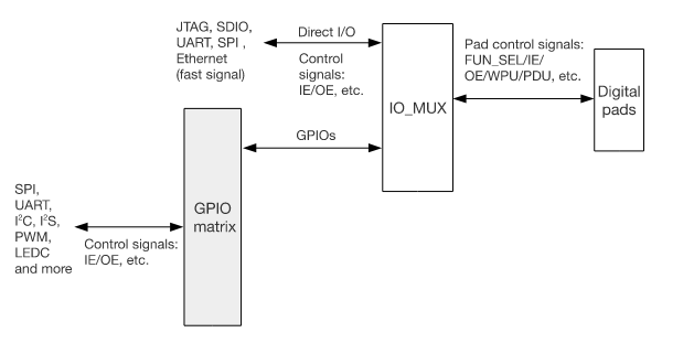

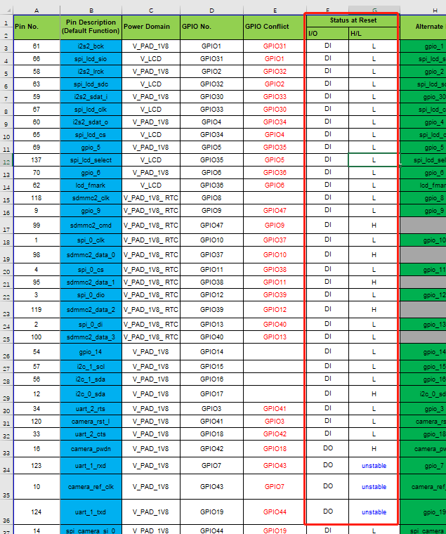

Function Multiplexing
In embedded systems, including plenty of micro-controllers and micro-processors, some dedicated physical pins can be configured as different functions, that is called Pin Multiplexing. Then, how to understand it? The key point is to learn that some pins can be converted among different HW components, resulting in huger flexibility in stage of HW design. The purpose of pin multiplexing is to reduce space and cost since the quantity of physical pins will be decreased.
tutorial_peripheral_diagram
The physical pins of an embedded chip may be designed to switch among several functions
  • General data Input/output as GPIO;
  • As a part of SPI interface, it will communicate with other SPI devices;
  • As a part of UART interface, it will used in serial communication;
  • Or it is endowed with other specialized functions such as ADC input or PWM output.
In stage of embedded system design, it is available to configure these pins according to HW and SW demands. In addition, it is also allowed by some embedded platforms to convert these pins dynamically when operating, providing much flexibility.
Absolutely, each coin has two sides, the pin multiplexing also owns limitation. I.e. one pin is not allowed to execute two or dmore functions at the same time. Therefore, please take it into consideration during the period of system design. Moreover, the pin multiplexing management will induce the system complexity and more SWs are demanded to configure and use these pins properly.

When the GPIO is configured as input, its inner structure allows itself to detect and reflect the voltage imposed. It is available for you to read this status via querying internal register in micro-controller or Pin.read.
HIGH: The voltage in GPIO is adjacent or equal to that in power supply such as 1.8 V or 3.3 V。
LOW: The voltage in GPIO is adjacent or equal to that in GND.
Applicable scenario
  • Button or switch input: By reading the GPIO level, it is available to detect whether the key is pressed or the switch is on/off.
  • Receive signal from other digital device: Receive signal sent by devices such as sensor, module or other micro-controllers.
Note
  • Pull-up and pull-down resistor: In some cases, the external device won't provide definite status. In order to avoid such "floating" situation, the internal or external pull-up or pull-down resistor can be used.
  • Input voltage range: In order to protect micro-controller, please guarantee the input voltage of GPIO shall be within the permissible range.

Interrupt
This class is used to configure the I/O pin to trigger an interrupt when an external event occurs
Create object
class machine.ExtInt(GPIOn, mode, pull, callback)
For specific method, please refer to machine.ExtInt.
Types to trigger interrupt
Rising Edge Interrupt
  • Applicable Scenario: Detect the moment when the button is pressed or detect the sensor from idle to active status.
Falling Edge Interrupt
  • Applicable Scenario: Detect the moment when the button is pressed to released or detect the sensor from active to idle status.
Both Edges Interrupt
  • Applicable Scenario: In terms of certain application such as Rotary Encoder for sake of detecting status change, it may demand info of rising edge and falling edge.
Configure pull-up and pull-down resistor internally.
It is allowed for module to configure internal pull-up or pull-down resistor in stage of initializing GPIO.
If the button or switch is connected to GPIO and there exists no external pull-up or pull-down resistor, the internal resistor can ensure that GPIO is in a known state when not driven.
Callback function
When triggering interrupt, it is demanded for module to take charge of dedicated operation or function to be executed, that is called callback function. As a function defined by user, it will be called automatically when specialized interrupt condition is satisfied.
Note: The callback function shall be as short and fast as possible to avoid impending other interrupt or logic of main program for a long time.
Enable/disable
extint.enable()
extint.disable()
For specific method, please refer to Eextint.enable and Extint.disable
Enable
  • Definition: It allows GPIO pin to respond in terms of specialized event such as rising edge and falling edge.
  • Usage: When the system is ready to process interrupt from specialized GPIO pin, please enable it. I.e. It shall be conducted after the system is initialized or former interrupt is accomplished.
  • Operation: There exists dedicated register or command in module to enable specific GPIO interrupt.
Disable:
  • Definition: Stop GPIO pin from responding specialized event, that means the interrupt will not generate even if this event occurs.
  • Usage: When executing vital codes such as FW upgrade, system calibration or other operation that needs to be immune from interrupt, please disable interrupt. Moreover, it is also used in the preliminary stage of ISR to avoid triggering same interrupt again when processing it.
  • Operation: Similar with enabling interrupt, specialized register or command will be embedded in most of micro-controller to disable dedicated GPIO interrupt.
Note
  1. Time Precision: In certain cases, especially for application with high time precision, it may need to enable or disable interrupt rapidly.
  2. Global and local: In some systems, it is available to disable all interrupts (disable globally) or specialized interrupt (disable locally).
  3. Security: After disabling interrupt, it is mandatory to enable it again in appropriate situation. Otherwise, it will cause a failure to respond some vital events in system.
For other method, please refer to wiki -machine.ExtInt in detail.

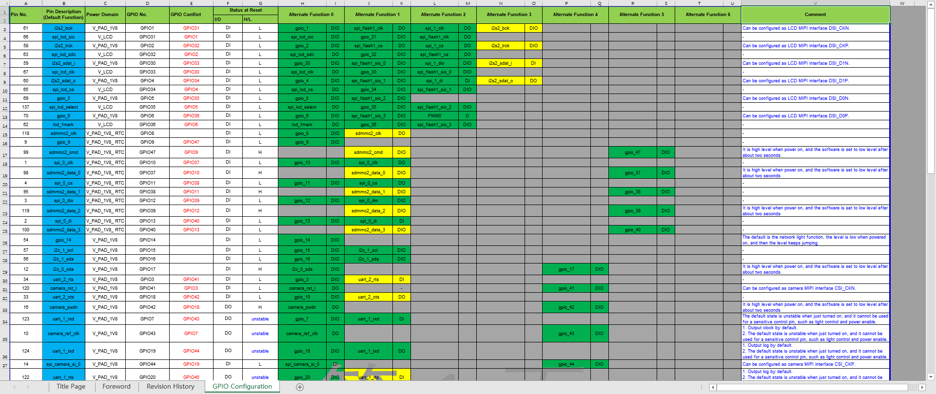

About GPIO Multiplex Table
Displayed by table or document, the GPIO Multiplexing table is used to describe different functions and alternative options of GPIO pins in specialized chip, micro-controller or system. In most of chips and micro-controllers, the GPIO pin is endowed with multiple functions and alternative options. That means each GPIO pin can be configured as various input or output such as data input/output, analog input/output or special peripherals. (I.e. SPI, UART and I2C)
The GPIO multiplexing table of QuecPython illustrates the function and alternative option of each GPIO pin in detail as well as status change in stage of booting. It lists the number, default function and available alternative option of each pin to make it convenient for user to configure and use GPIO pin properly, which is vital in connecting peripherals, driving screen ad controlling communication interface.
The format and contents of specific GPIO multiplexing table will be varied according to different module. Therefore, for given module, please refer to relevant Hardware Design or GPIO multiplexing table for detailed GPIO configuration.
In this case, it will take the QuecPython EC600U GPIO configuration as an example. For other modules, it will be similar.
EC600U_gpio_config
Explanation on each column
Term Explanation
Pin No. Module physical pin number
Pin Description Default function of pin
Power Domain Power domain of pin
GPIO No. GPIO number of pin
GPIO Conflict Pin with GPIO multiplexing (It is not allowed to use the pin with conflict GPIO function at the same time)
Status at Reset Status at reset. The level change will be marked in Comment column.
Alternate Function Pin multiplexing function
Comment Notes of pin and level change description in stage of booting
Status at Reset
The pin at Reset will be varied according to different HW platform and development environment. Normally, when powering up or rebooting system. the initial status of GPIO pin is undefined and is out of control by SW. Therefore, in terms of controlling LED or enabling peripheral switch, the pin with special reset status is needed. Before designing HW circuit, please query relevant documents or references to make acquaintance with pin at Reset in dedicated platform and environment.
The GPIO pin at Reset of individual platform can be acquired via querying GPIO multiplexing table .
Most GPIO pins are stable when powered on, and a small number of GPIO pins are changed by software after powered on. See QuecPython GPIO multiplexing table in detail.
pin_satus_at_reset

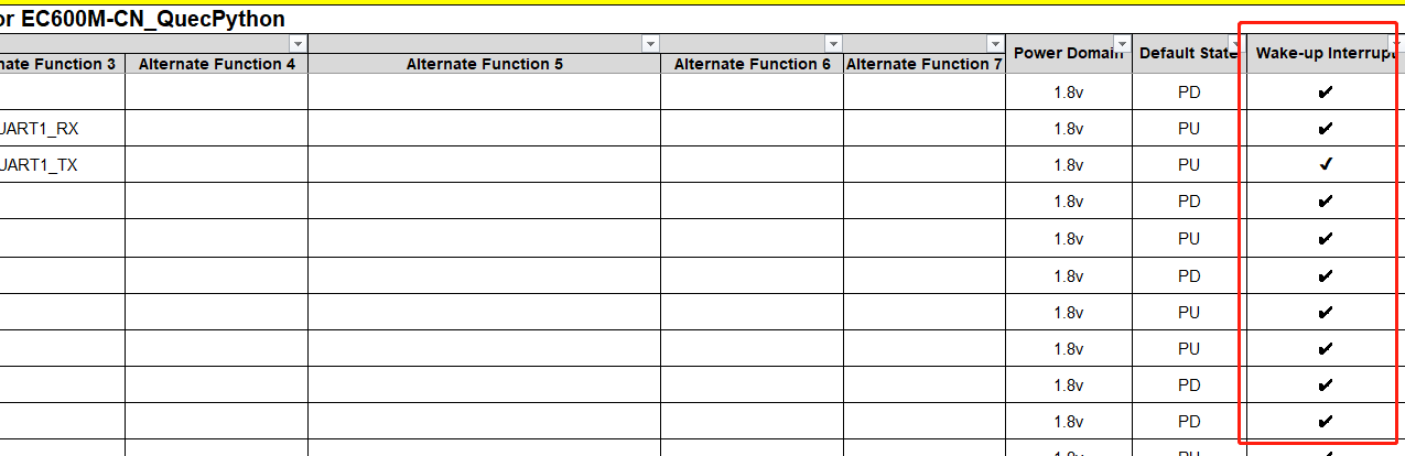

Wake up interrupt
The GPIOs in EC200U/EC600U/EG912U/EG915U modules support waking up module in sleep mode. While for others, most of which support waking up module. For specific, please query and confirm via GPIO multiplexing table.
1692429975477
To check whether it supports waking up interrupt, please refer to the GPIO multiplexing table of the corresponding module.
