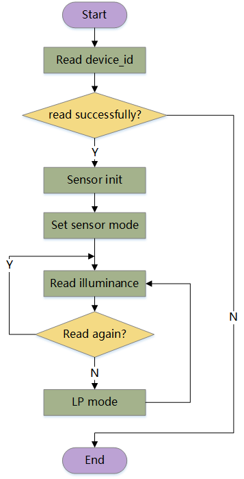

Workflow
The following diagram shows a typical workflow of a light intensity sensor.

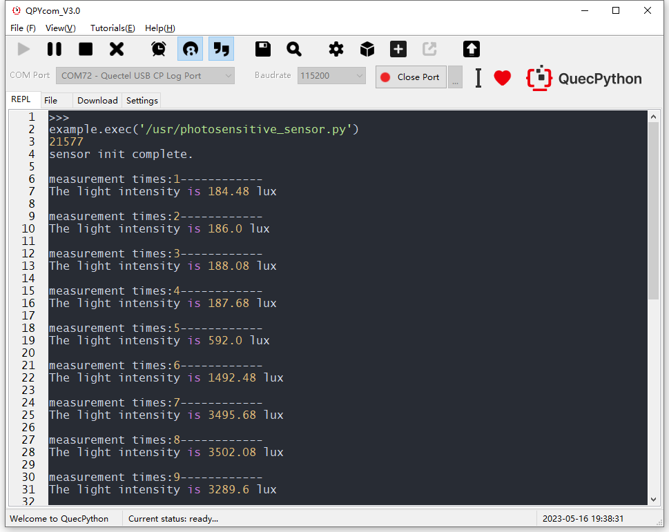

Verification
Download the experimental code to the module and run it. During the running process, you can cover the sensor with your hand or shine a flashlight on it to observe the changes in the illuminance value of the OPT3001 light sensor.
