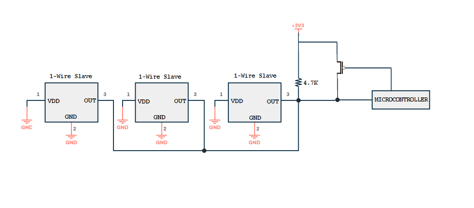

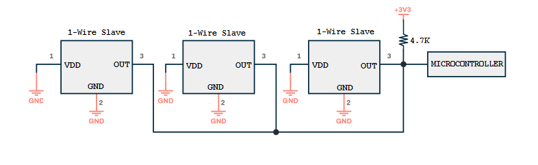

As mentioned, 1-wire slave devices can be powered in parasitic and conventional modes. All 1-wire slave devices have three terminals: VDD, GND and data. In the parasitic mode, the VDD and GND pins are connected to the ground, so the signal and power are supplied to the slave devices on the same line (i.e. the data line).
The slave devices have an internal capacitor of 800 pF, which gets charged when the data line is HIGH. The stored charge keeps the slave live when the data line is LOW. The data line is typically pulled up by a 4.7 K resistor.
Parasitic powering requires strict timing and supply to the exact specification to maintain the slave device live without fail. This is why this mode is less reliable. Often, an additional hard pull-up is used to ascertain the power supply.
Parasitic powering:

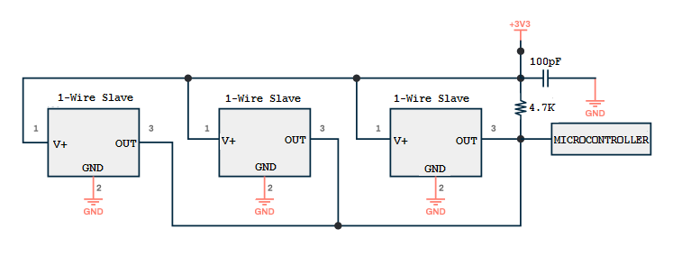

In a conventional powering mode, 1-wire slave devices are externally powered. An additional wire is traced to each 1-wire slave. The external power supply to the slaves ensures safe operation even in harsh, high-temperature conditions.
Typical 1-wire devices operate in voltages from – 1.71~1.89V, 1.71~3.63V, 2.97~6.63V, and 2.97~5.25V. The current drawn ranges between 1.06~5mA. The pull-up resistor sets the current level whether devices are supplied parasitic or conventional power.

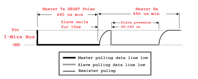

Communication over the data line is initiated by the controller using a reset. It pulls down the data line for 480 us and then releases it, allowing the typical pull-up resistor to pull the data line HIGH. If the slave devices are connected to the bus, they respond to the reset signal by pulling the data line LOW for 60~240 us. If the line is pulled down by the slave(s), the master confirms their presence over the bus. After 60~240 us, the peripheral(s) release the data line, so the master can start writing.

Reset is used to start communication with the slave. The master will send a reset pulse, and then wait for slave's response. See following steps:
- The master pulls down the Data Line (or 1-Wire line) for at least 480 microseconds, and then releases it.
- The master will wait for a moment so that the slave can respond to the reset pulse. Therefore, the slave should pull down the Data Line in 15~60 microseconds to send an acknowledgement signal.
- The master checks the acknowledgement signal from the slave to determine if such slave exists. If acknowledgement signal is visible, the communication is considered a failure.

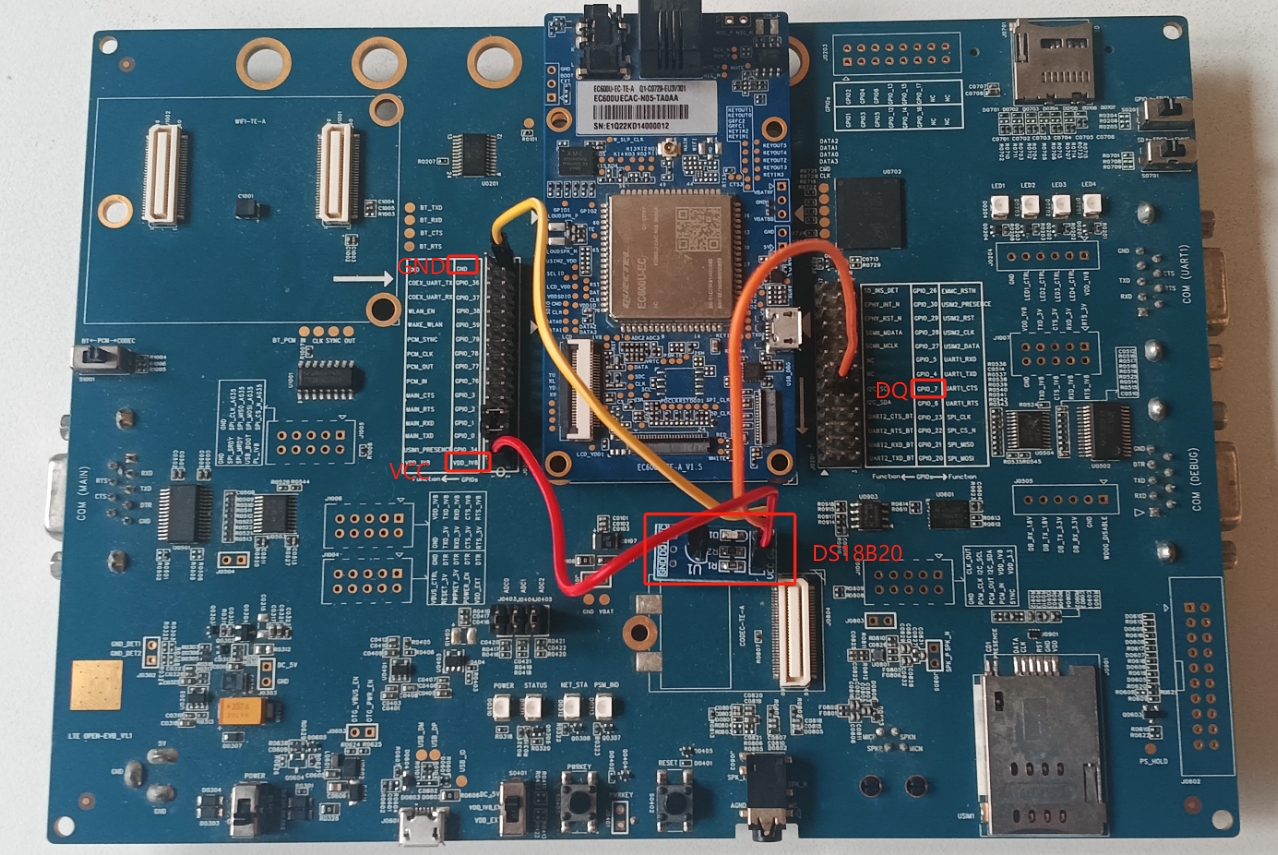

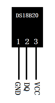

First of all, connect the hardware correctly. DS18B20 has three pins, which are VCC for power supply, DQ single line for data transmission and GND for ground respectively.
Connect the hardware according to the following figure, the DQ is connected to GPIO15 on the EC600U module.
