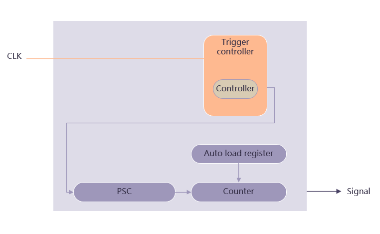

The working principle of hardware timers are shown in the following diagram:
- The CLK clock signal is output to the trigger controller.
- The trigger controller outputs the signal to the prescaler.
- The signal is divided by the prescaler and then output to the counter.
- When the value of the counter reaches the value of the auto-reload register (determined by the timer type), if the interrupt is enabled, the timer generates an overflow interrupt.
The above process is a conceptual overview of the timer principle. The following types of timers are similar.

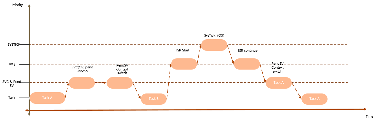

Systick

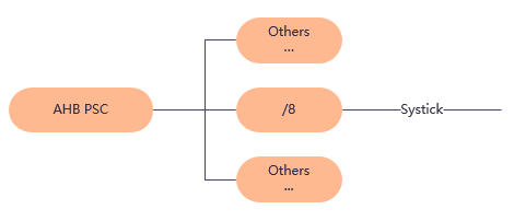

The system tick timer, also known as the heartbeat timer, generates Systick interrupts to switch system tasks. The system uses this timer to allocate time slices to tasks and switch between tasks. The diagram below illustrates the task switching process:
The internal structure diagram is shown below. RCC provides an external clock source by dividing the AHB clock by 8.

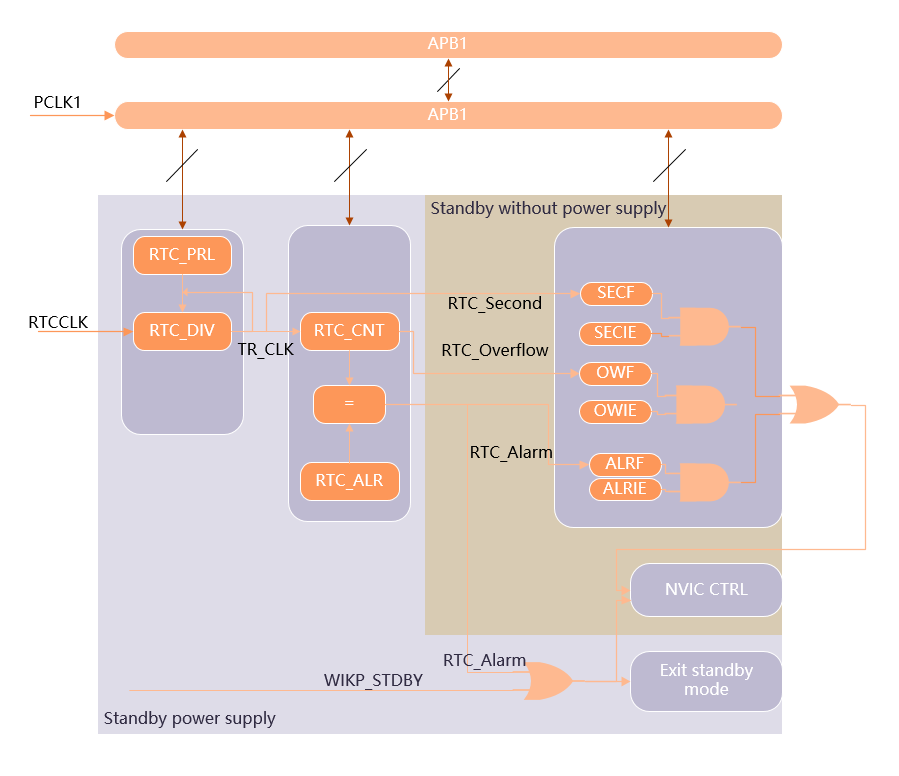

RTC Timer
The Real-Time Clock (RTC) is an independent BCD timer/counter. It can wake up the device from sleep mode to manage the low-power mode of the device. It can provide clock and calendar functions under certain configurations. The RTC time will be reset when the QuecPython module restarts. After successful network registration, the RTC time will be updated. The hardware diagram is shown below:

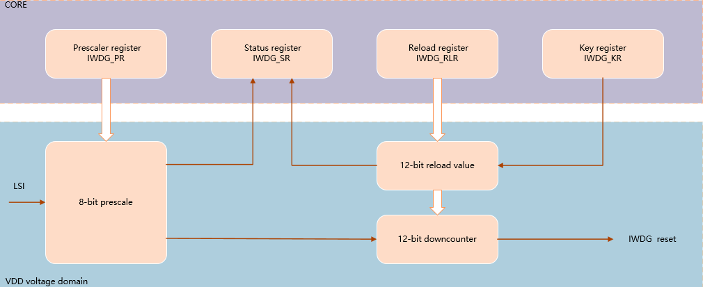

Watchdog Timer
The watchdog timer is used to monitor and resolve failures caused by software errors. When the counter counts down to 0 (or increases to the set count value), it triggers a system reset. It has a dedicated low-speed clock driver, which remains effective even if the main clock fails. The watchdog time can be adjusted by configuring the time window. From the above description, it can be understood that the so-called "feeding the dog" refers to resetting the counter (or clearing the counter). The working principle diagram is shown below:

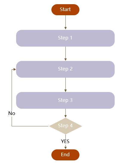

The implementation logic is to establish a linked list (or binary tree or other data structure) and record the expiration time of the newly added software timer. Then, add it to the linked list (or binary tree). Each time, select the nearest expiration time of the software timer and set it in the hardware timer. When the hardware timer interrupt is triggered, the expired hardware timer task can be executed, and the software timer task can be processed in the hardware timer task. Next, select the nearest expiration time of the software timer and set it in the hardware timer again. This cycle allows the software timer to work. From the above principle, it can be seen that software timers cannot achieve the accuracy of hardware timers, but they can overcome the number limitation of the hardware timer. The implementation logic block diagram is as follows:
- Step 1
- Record the expiration time of the currently added software timer and add it to the software timer linked list.
- Step 2
- Traverse and sort the software timer linked list, select the one with the smallest expiration time, and set its expiration time in the hardware timer.
- Step 3
- When the hardware timer expires, traverse the software timer linked list, execute the event registered by this timer, and remove the expired node from the software timer linked list.
- Step 4
- Determine whether the software timer linked list is empty. If it is empty, exit the process.
The above is just a simple way to implement the software timer, not the best way. The implementation of the software timer will vary according to different scenarios and the selection and optimization of data structures. The above is just an introduction to its basic implementation principle.
