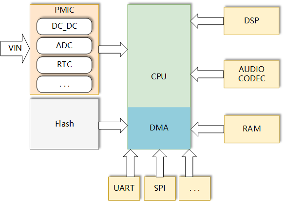

The typical power supply system and internal power management unit of a SOC chip are shown in the following figure:
As shown in the figure, in the typical power supply system of SoC, the PMIC simultaneously supplies power to IP cores with different functionalities and also manages power-on and charging considerations. In addition to the input/output of power supply, the PMIC often integrates clock circuits, RTC circuits, various analog IPs (such as ADC and temperature sensors, and some PMICs integrate audio CODECs). How does the PMIC utilize its various functionalities for power management? In the following sections, we will start with the PMIC and introduce its composition and implementation of power management.

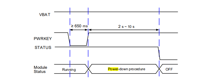

In the power-on state, long pressing the powerkey will trigger a shutdown. At this time, the CPU will receive an interrupt generated by the operation of long press of the powerkey and actively call the shutdown command, operating the PMIC to power off and change the power state of the module.

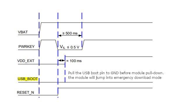

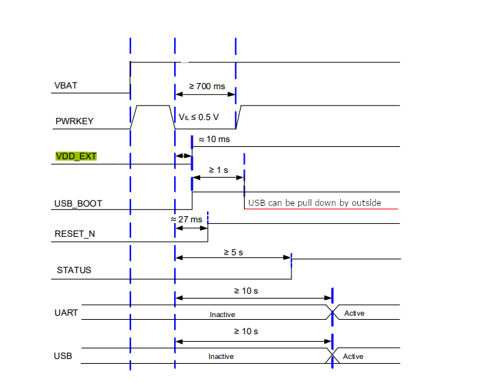

Power-On Timing Diagram:
Power-Off Timing Diagram:

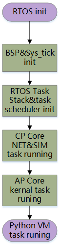

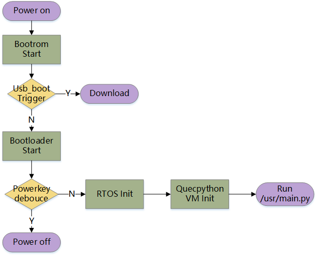

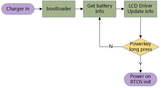

Implementation of Power-On by Long Pressing the Powerkey
Check the powerkey for pin level and debounce in the bootloader. Since ISR cannot be used in the bootloader, most of the debounce is done by polling the powerkey status, and the PMIC is operated to shut down the module if the duration of the low level is less than the debounce time threshold.

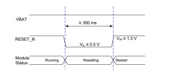

Hardware Connection and Restart Principle of Reset
Unlike the powerkey, RESET is generally directly connected to the CPU, and its triggering does not involve the PMIC. It only resets the CPU, returns the interrupt vector table to bootrom, and then starts execution from bootrom.
Reset Timing Diagram:

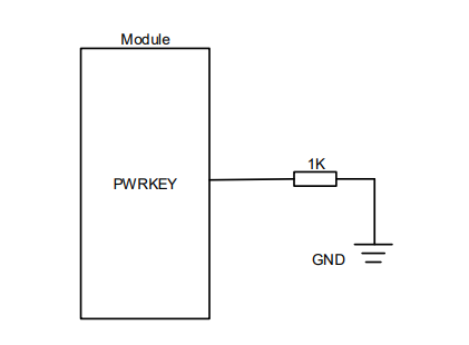

If you need to implement a power-on auto-start function without considering power-off, you can directly pull down the Powerkey to ground, and it is recommended to use a pull-down resistor of not more than 1 kΩ.
Power-on Auto Start Typical Design Circuit:

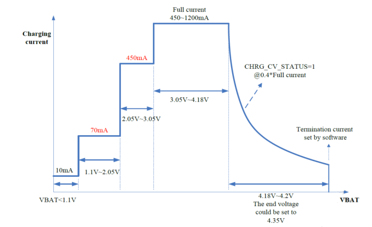

Device Charging:
The charging management unit is a relatively independent unit within the PMIC, including charging circuits, battery sensors, charging status indicator driver circuits, and more.

Charging Stage Control
Based on the VBUS voltage, the PMIC controls the charging management unit to enter different charging management stages. The typical divisions are as follows (different modules may have different names, but the principles are similar):
Trickle mode/activation mode: When the battery voltage is below a certain threshold, the battery management system prohibits charging the battery. At this time, a small current is needed to activate the battery to restore it to a chargeable state.
Pre-charging mode/low current mode: When the battery voltage is low, if full-power charging is performed, it may cause safety hazards such as high temperature and overvoltage to the battery due to the chemical characteristics of the battery. Therefore, when the voltage is lower than the full current charging threshold, the charging management power supply will charge VBAT with a lower current and voltage.
Full current mode/fast charging mode: At this time, the battery has reached a voltage that can be safely fully charged. A large constant current is maintained to quickly charge the battery.
Constant voltage charging mode: The battery is close to full load. At this time, a constant voltage is maintained, and the charging current gradually decreases as the voltage difference between VBAT and the charging unit decreases until it reaches full charge and charging stops.
Recharge: After charging is completed, VBAT voltage is polled. If VBAT drops below the recharge trigger voltage, constant voltage charging is performed.
Typical Charging Current and Voltage Curve:

Shutdown Charging Solution
Overview of Shutdown Charging Solution
Shutdown charging refers to monitoring the charging status while the module is in a shutdown state when the power is plugged in for charging without turning on the module.
Implementation Principle
The charging unit itself contains an FSM that controls the charging stage. It can control the charging behavior when the CPU is not running. Therefore, the implementation is to monitor the charging status (such as VBAT voltage, battery temperature, etc., and may also need to be displayed ) without turning on the device.
At this time, when VBUS is pulled high by the power supply, the CPU is powered on through hardware linkage with the power key (if the PMIC supports triggering power-on by charger insertion, enable charger-triggered power-on instead of triggering the power key).
The logic of shutdown charging is implemented in the bootloader, mainly including polling battery status and LCD display, but it does not jump to the RTOS stage from the bootloader. If the powerkey is detected to be triggered again at this time, the normal boot-up process is entered.

Device Boot-up Process
Overview of Boot-up Process
In general, the boot-up process can be divided into the following four parts:
- Bootrom: It runs immediately after power-on, usually stored in the ROM of the hardware.
- Bootloader: It initializes necessary peripherals and checks the code in the external storage. If the boot-up conditions are met, it jumps to the RTOS startup part.
- RTOS: The initialization of the RTOS is initialized and necessary tasks are started. At the end of this process, the QuecPython virtual machine thread is created.
- Initialization of QuecPython virtual machine: After initializing the communication interface, virtual file system, and network environment, it searches for and executes main.py in the usr partition.
The overall flowchart is as follows:
Bootrom
Bootrom is the code stored in the module hardware and is pointed to by the reset vector code. It is executed immediately when the module is powered on or reset. It generally includes functionalities such as forced download detection and basic initialization. Before the code running completes, it checks and boots the bootloader.
Bootloader
The bootloader is usually stored in the internal storage as the second-level boot. It completes some uncertain, relatively complex functionalities that are not convenient to be completed in the bootrom stage.
The functionalities of the bootloader may vary on different modules. The typical process is described below.
Basic BSP Peripheral Initialization
The bootloader needs to operate some peripherals, such as GPIO and UART. At this time, these peripherals are initialized.
Powerkey Debouncing
The bootloader generally cannot use ISR. Powerkey debouncing refers to polling the pin level of the powerkey within a threshold time. If the pin level is maintained for a time longer than the threshold, the boot process continues. Otherwise, the powerkey triggering is debounced, and operate the PMIC to shut down the module.
Determine Whether to Perform FOTA
Most modules' FOTA relies on the bootloader for redirection. Generally, a register is set as a flag before the last shutdown to indicate the need for FOTA. When the FOTA flag is detected, the bootloader does not jump to the RTOS system but jumps to the updater (generally a piece of code that can run independently, which writes the contents of the FOTA package to the specified flash address to complete firmware upgrade).
Deinitialize Relevant Peripherals and Jump to RTOS System Startup
Deinitialize the peripherals used in the bootloader and restore them to the state before the operation. Verify the integrity of the RTOS code area. If the verification passes, jump to the RTOS entry function. If it fails, it is generally considered that the image is damaged and jump to the download mode.
(EG912N and EG915N series modules support jumping to the LOGO stage, reading image resources from the file system, and initializing the LCD driver to display the boot logo. After the logo is displayed, it jumps to RTOS.)
RTOS Initialization
RTOS is the main program running on the module. Most communication modules initialize two sets of RTOS at this time to handle CP and AP tasks separately. The general initialization process is as follows:
Initializing Clock and Peripherals to Prepare for RTOS Initialization
To obtain an accurate sys_tick, the CPU's tick is reinitialized (i.e., the tick is restored to 0). All peripherals are also set to the initial state after power-on. At this time, the BSP state should be aligned with the default level of the module.
RTOS Initialization
Initialize task stacks and task schedulers. When the task scheduler is initialized, the RTOS takes over the underlying layer, and the functions we call start running in the RTOS tasks.
CP Core Starts Network Search and SIM Card Tasks
The CP starts network search and SIM card tasks. The CP core provided by the manufacturer is generally not open source, so it will not be further described here.
AP Core Starts Necessary Internal Tasks
Start necessary internal tasks such as watchdog, FS, and protocol stack to complete the conditions for running the application.

USB_BOOT
Overview of USB_BOOT
USB_BOOT is a fixed IO pin on the module. During the bootrom stage, if this pin is at a specific pin level, the module will directly enter the forced download/emergency download mode. After booting, it can be used as a normal IO pin.
Implementation Principle of Forced Download
Even if the module firmware is damaged or not programmed, USB_BOOT can still be triggered normally. The pin number, trigger level, and download mode redirection are all sotred and fixed in the ROM of the hardware. The code entry of this ROM is the CPU reset vector, so even if the code in the erasable storage medium is damaged, it does not affect the behavior of USB_BOOT here.
Usage
Scenario: Initial programming, unbricking, scenarios where it is not convenient to enter download mode with software control
Usage: Short the usb_boot pin to ground, and then power on the module. At this time, USB will not enumerate multiple ports, and only one download port will be visible to the host.
Possible download port names:
Quectel Download Port (EG912N and EG915N series modules)
Quectel QDLoader 9008 (BG95 series modules)
SPRD U2S Port (EC200U and EG91xU series modules)
Start flashing the firmware on the host as follows:
QPYCom: After loading the firmware, select the corresponding download port for the module based on the model, and then click "Firmware Download" to start the flashing process.
QFlash: After loading the firmware, select the corresponding download port for the module based on the model, and then click "Start" to start the flashing process.
USB_BOOT Boot Time Sequence Diagram:
Note: When downloading is not expected, make sure to protect the pin level before the end of the boot process to prevent the module from detecting the pin trigger and entering download mode.
