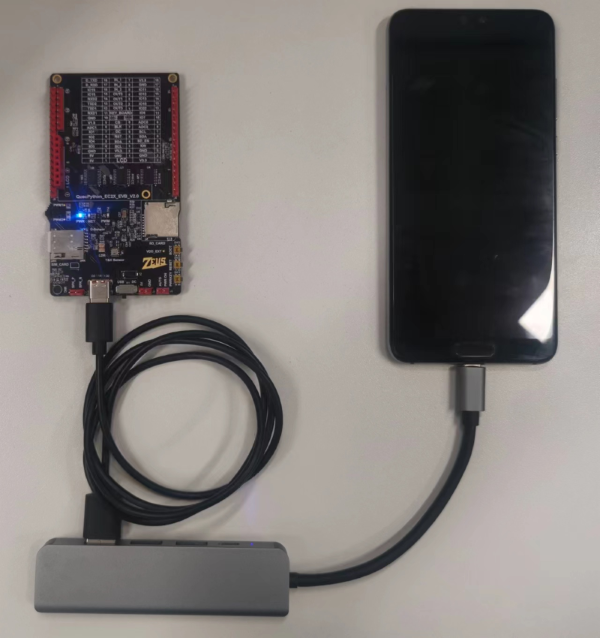

Connect the USB to the phone
After configuring the startup on the computer, connect the USB port to the Type-C port on the phone and power on the module by pressing the PWRKEY button. Please prepare the adapter cable yourself.
Connect to the phone network
Once the module is connected to the phone and powered on, you will see a
<···>icon in the status bar of the phone, indicating that the USB network adapter has been recognized by the phone. You can now open the browser and access the network.
