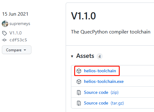

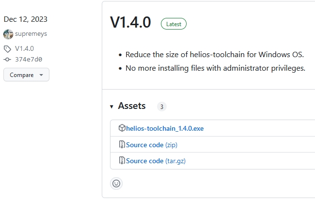

Step 1: Download Toolchain
Download the toolchain installation package helios-toolchain.exe for Windows 10 environment from the QuecPython official website, as shown in the following figure:

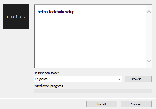

Step 2: Install Toolchain
Run helios-toolchain.exe as an administrator, as shown in the following figure, and click "Install" to install the toolchain.
The target folder must not contain spaces.
Download the toolchain installation package helios-toolchain.linux for Ubuntu 16.04 environment from the QuecPython official website, as shown in the following figure:

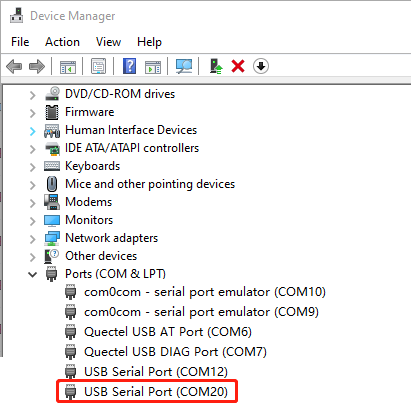

Step 2: Check the Debug serial port number on the PC
Open the Device Manager on the PC. In this example, the Debug serial port number is COM20.

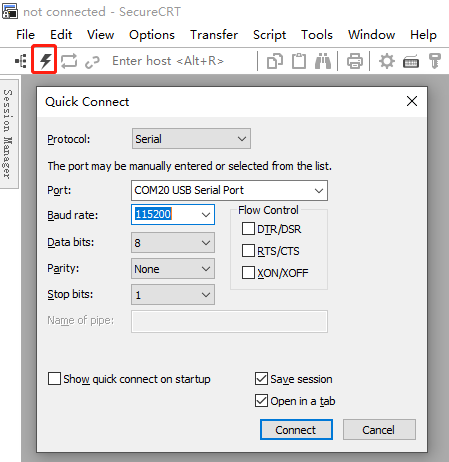

Step 3: Open the serial debugging tool on the PC
Here takes SecureCRT as an example. Click the icon of quick connect button in the following figure to open the "Quick Connect" window.
Click the drop-down menu of the "Port" option and select COM20. Strictly follow the configuration in the figure for other parameters.
Click the "Connect" button in the lower right corner to open the serial port.

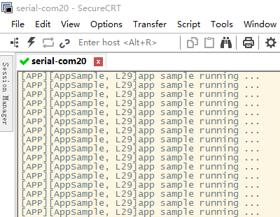

Step 5: Check the module's running log
Check the running log in the serial data reception area of SecureCRT, as shown in the following figure:
From the above figure, we can see that the log output format includes the custom tag APP, the function name AppSample that outputs the log, the file line number L29, and the log content app sample running ....
