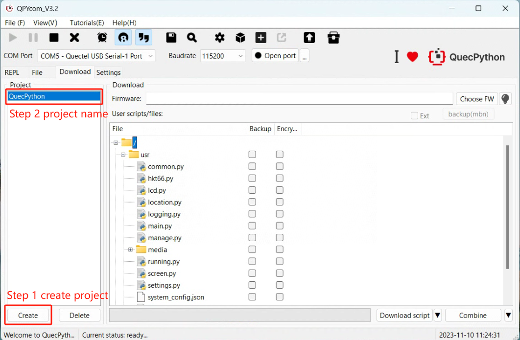

Create a project on the left navigation bar.

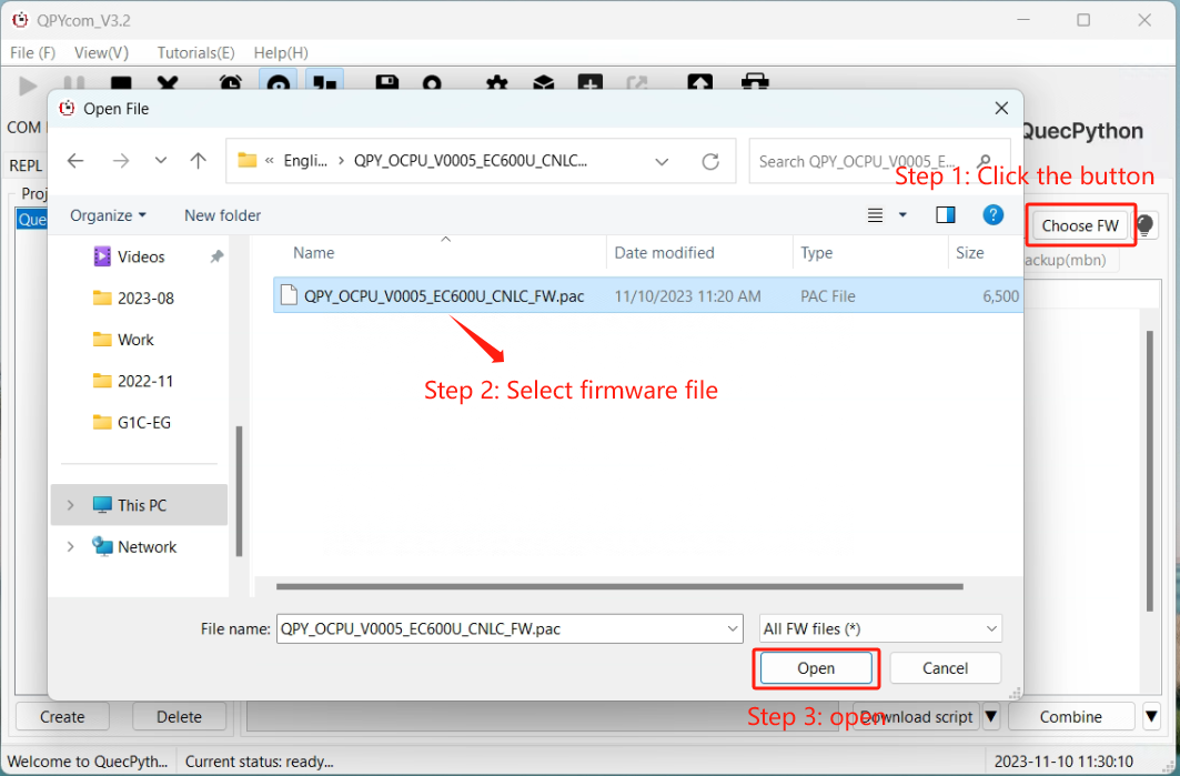

Click "Choose FW" to choose the firmware from the local disk. You can also download the firmware corresponding to the module model from QuecPython official website. Please note that the firmware format can be either .zip or .bin.

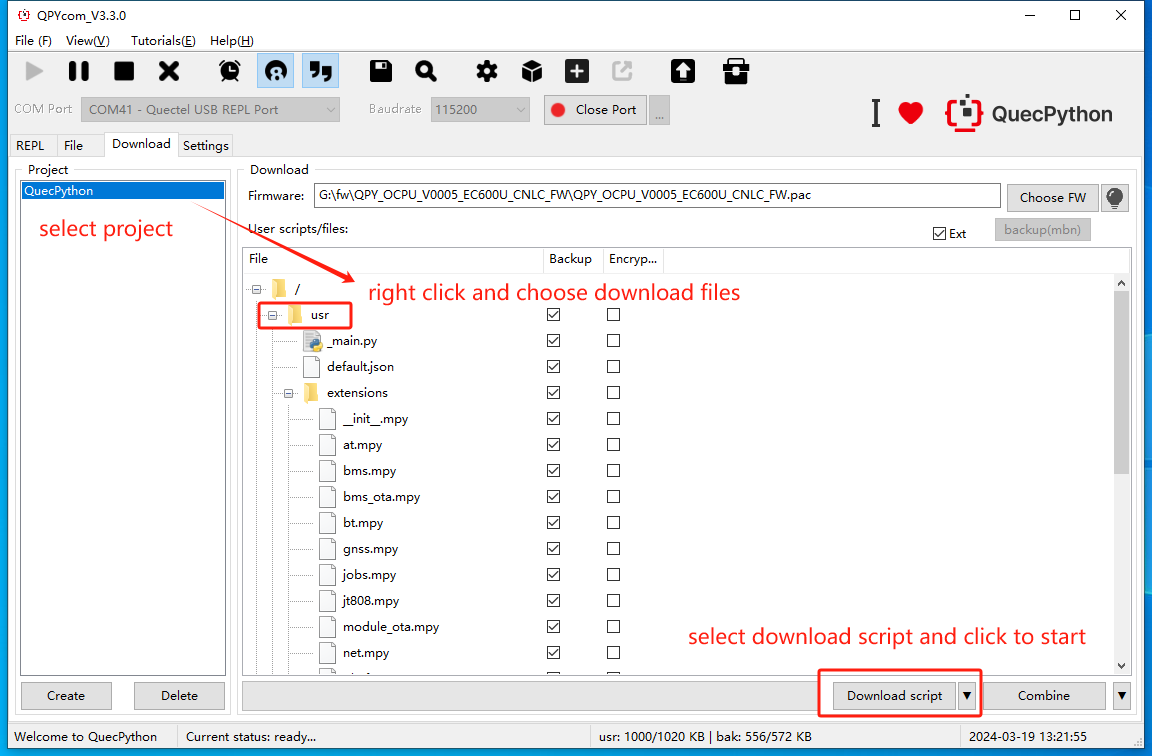

Select the script to download as indicated in the image below. You can also select a script and click "-" in the lower left corner to delete it.

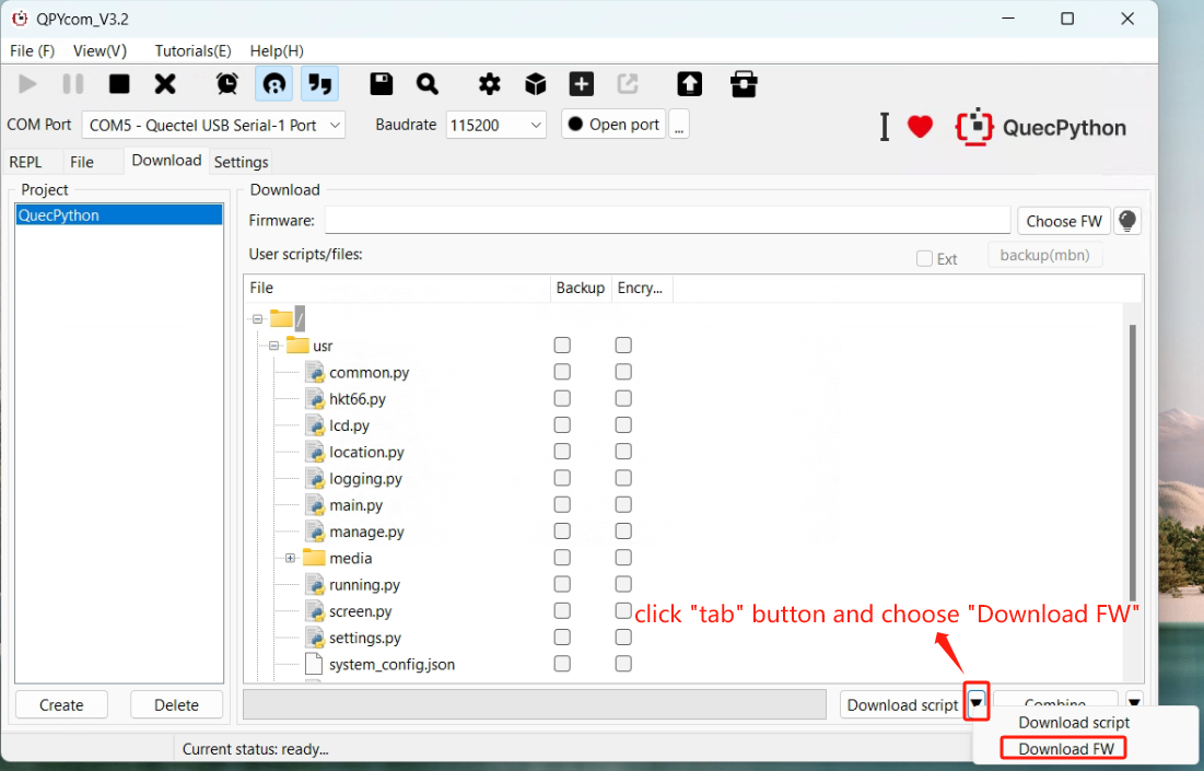

Switch between "Download script" and "Download FW" by clicking the inverted triangle icon in the lower right corner.

- On the "Download" page, click "Create" to create a project for downloading firmware.
- Select the firmware.
- Left-click the inverted triangle and select "Download FW".
- Wait for the progress bar to complete, and a pop-up will appear to notify you of the successful firmware download.

- Step 1: Create Project
Click "Create" to create a project according to your needs.

Select the script to be downloaded to the module (Add the script by right-clicking it in the "User script/files" section).

Left-click the inverted triangle and select "Download script".
- Step 4: Start Downloading Script
Click "Download script" to start downloading the script. The download progress will be displayed in the progress bar.
