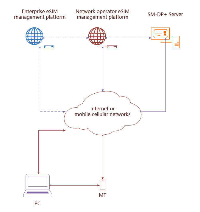

Overall eSIM Business Process
The overall eSIM business process is shown in the following diagram:
Figure 1-1
Explanation:
  • Users access the network through personal computers or mobile devices and purchase eSIM services on the enterprise eSIM management platform or directly on the network operator's eSIM management platform (if available).
  • The network operator stores the corresponding eSIM data in the SM-DP+ server.
  • The enterprise eSIM management platform or the network operator's eSIM management platform (if available) sends the required parameters for downloading the profile to the personal computer or mobile device.
  • The profile data is downloaded from the SM-DP+ server to the user's device through the personal computer or mobile device.
  • The downloaded profile is installed and stored in the eSIM card, and then the successfully installed profile is activated to complete the eSIM card's network access.

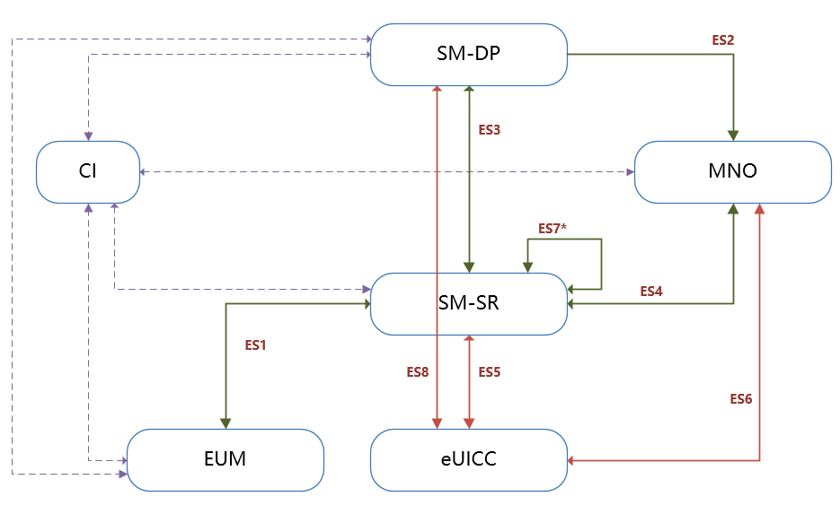

M2M Solution
The M2M solution is the first remote SIM card provisioning solution developed by GSMA. There are two main reasons for this:
  • The M2M solution is simpler and does not require interaction with end users.
  • The immediate commercial need was for technical solutions that supported B2B2C deployments alongside regulatory requirements for the launch of services such as eCall.
Remote SIM Provisioning for M2M utilises a server driven (push model) to provision and remotely manage operator Profiles. This solution is organized around three elements: SM-DP (Subscription Manager-Data Preparation), SM-SR (Subscription Manager-Secure Routing), and eUICC.
The diagram below is the high-level representation of the M2M main system elements. Beyond common SIM functions, such as SIM Toolkit and Bearer Independent Protocol (BIP) support, the M2M solution does not impose additional requirements on M2M devices to enable usage of eUICCs.
Figure 1-2

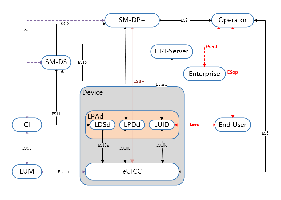

Consumer Solution
The Consumer solution is developed based on the M2M solution, allowing users to control their devices and perform business operations through terminal devices, providing users with greater freedom. As a result, this solution is more complex and requires comprehensive considerations. The GSM remote SIM provisioning consumer solution follows a client-driven(pull model) and enables control over remote provisioning and local management of operator profiles by the end user of the device.
This solution is organized around four elements: SM-DP+ (Subscription Manager-Data Preparation+), SM-DS (Subscription Manager-Discovery Server), LPA (Local Profile Assistant), and eUICC.
The following diagram (Figure 1-3) shows the main system elements and architecture of the Consumer Solution.
Figure 1-3

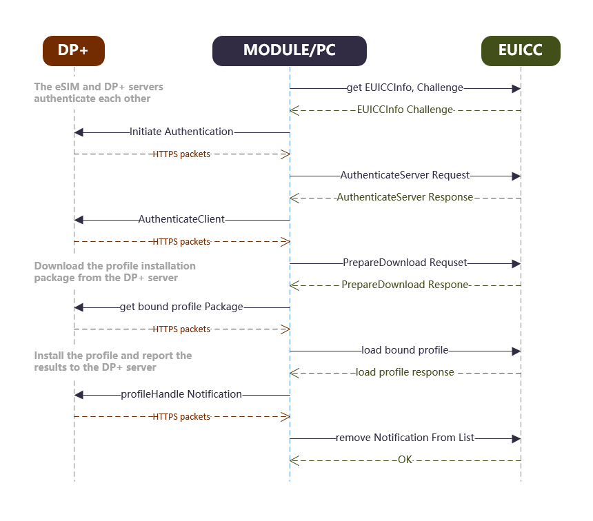

eSIM Profile Download Process
The following diagram shows the interaction process for downloading profiles from SM-DP+.
Figure 1-4

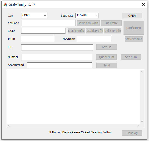

Interface Introduction
The QEsimTool software comes with an application guide document. The following is a brief introduction.
The startup interface of the QEsimTool software is as follows:
Figure 1-5
Port: AT command interaction serial port.
Baud rate: Serial port baud rate.
OPEN: Open the Port with the specified baud rate.
AccCode: AccCode needs to be provided by the operator and filled in QEsimTool as a parameter.
DownloadProfile: Click this button to resolve the AccCode and download the profile through the network.
ListProfile: View the current profile list.
ICCID: ICCID number of the eSIM card.
EnableProfile: Enable the profile corresponding to ICCID.
DisableProfile: Disable the profile corresponding to ICCID.
DeleteProfile: Delete the profile corresponding to ICCID.

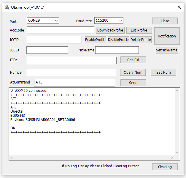

Operation Instruction
Users can follow the steps below:
  • After the module device starts normally, open the QEsimTool software on the personal computer.
  • Check whether the personal computer can access the Internet normally.
  • Select the Port serial port as the AT port, set the baud rate, and click the open button in Figure 1-5.
  • Fill in the AccCode provided by the operator.
After successfully connecting to the device, execute the ATI command. If the version information is correctly displayed as shown in the figure below, you can click the DownloadProfile button to download and install the profile.
Figure 1-6
If any exceptions occur during the use of the software, please provide QuecWinLpa.log to the engineer for analysis.
