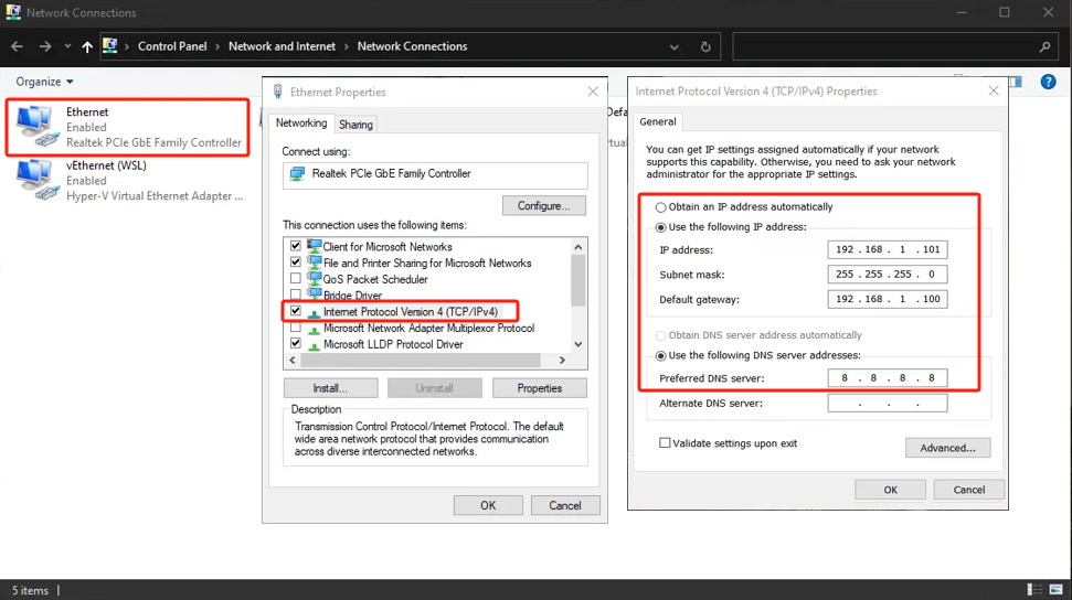

Taking a PC as an example, a PC cannot communicate on the network before an IP address is configured. Only when the PC's static IP address is configured in the same network segment as the module's static IP address can the PC communicate on the network.
Right-click "Ethernet", select "Properties", click "Internet Protocol Version 4 (TCP/IPv4)", de-select "Obtain an IP address automatically" and "Obtain DNS server address automatically", change the settings to the static IP address shown in the following figure and click "OK".
In this case, the PC can also obtain a dynamic IP address. Some modules do not have a built-in DHCP server and need to be configured with a static IP for network configuration.

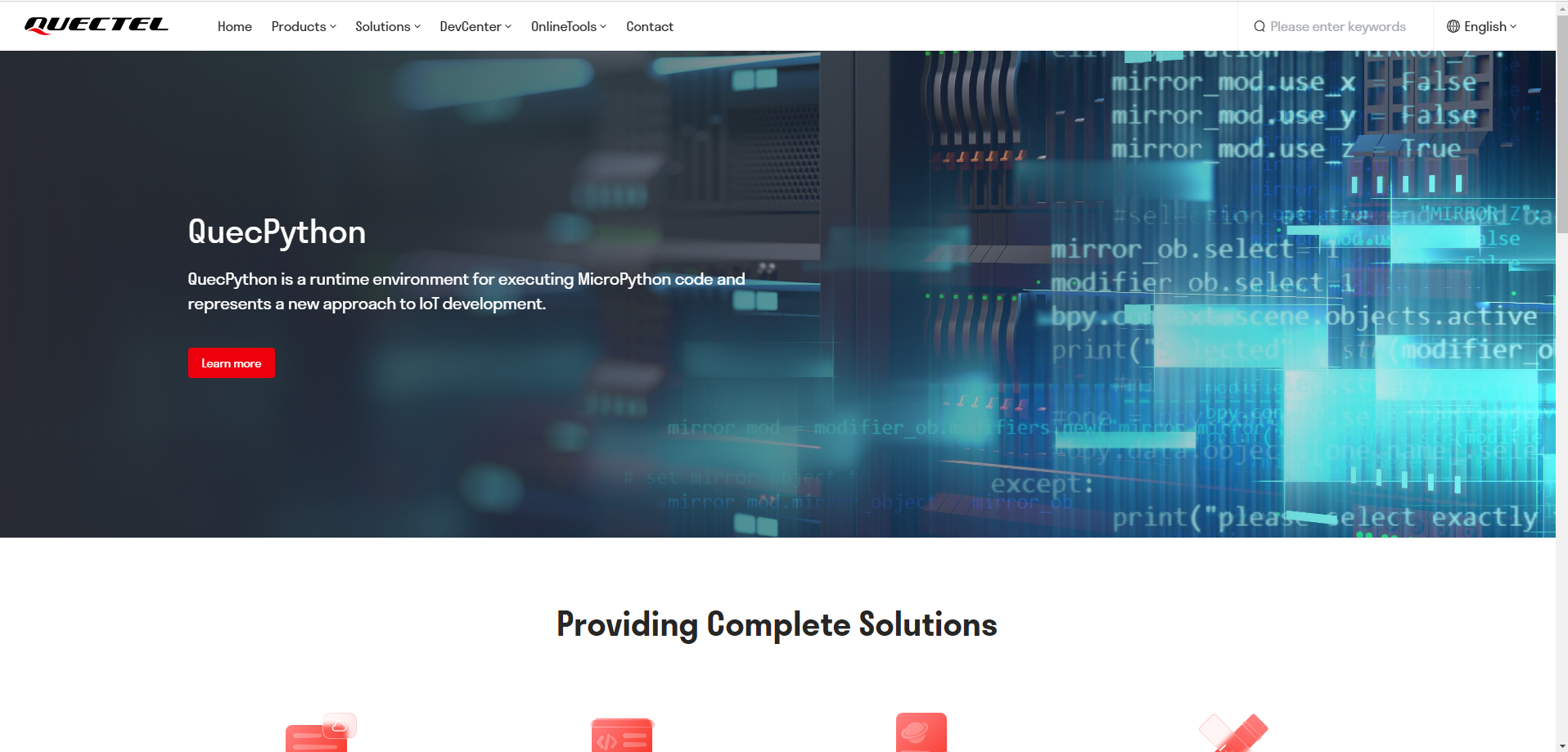

After the PC has connected to the network, you can access the Internet through a computer browser. For example, you can enter https://developer.quectel.com/en/ in the browser to access the official QuecPython website normally.
