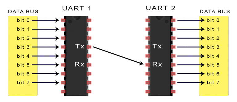

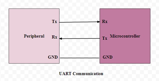

In UART communication, two UARTs communicate directly with each other. The transmitting UART converts parallel data from a controlling device like a CPU into serial form, transmits it in serial to the receiving UART, which then converts the serial data back into parallel data for the receiving device. Only two wires are needed to transmit data between two UARTs. Data flows from the Tx pin of the transmitting UART to the Rx pin of the receiving UART:
UART
UARTs transmit data asynchronously, which means there is no clock signal to synchronize the output of bits from the transmitting UART to the sampling of bits by the receiving UART. Instead of a clock signal, the transmitting UART adds start and stop bits to the data packet being transferred. These bits define the beginning and end of the data packet so the receiving UART knows when to start reading the bits.
When the receiving UART detects a start bit, it starts to read the incoming bits at a specific frequency known as the baud-rate. Baud-rate is a measure of the speed of data transfer, expressed in bits per second (bps). Both UARTs must operate at about the same baud-rate. The baud-rate between the transmitting and receiving UARTs can only differ by about 10% before the timing of bits gets too far off.
Both UARTs must also must be configured to transmit and receive the same data packet structure.
How UART works
Introduction-to-UART-Data-Transmission-Diagram
The UART that is going to transmit data receives the data from a data bus. The data bus is used to send data to the UART by another device like a CPU, memory, or micro-controller. Data is transferred from the data bus to the transmitting UART in parallel form. After the transmitting UART gets the parallel data from the data bus, it adds a start bit, a parity bit, and a stop bit, creating the data packet. Next, the data packet is output serially, bit by bit at the Tx pin. The receiving UART reads the data packet bit by bit at its Rx pin. The receiving UART then converts the data back into parallel form and removes the start bit, parity bit, and stop bits. Finally, the receiving UART transfers the data packet in parallel to the data bus on the receiving end:

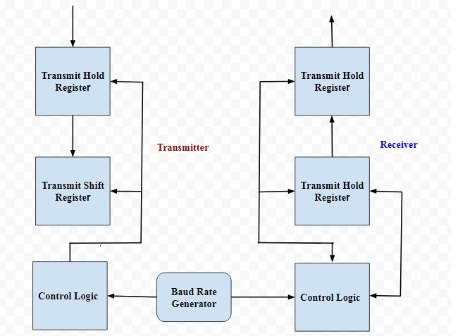

UART Block Diagram
The UART block diagram consists of two components namely the transmitter & receiver that is shown below. The transmitter section includes three blocks namely transmit hold register, shift register and also control logic. Likewise, the receiver section includes a receive hold register, shift register, and control logic. These two sections are commonly provided by a baud-rate-generator. This generator is used for generating the speed when the transmitter section & receiver section has to transmit or receive the data.
The hold register in the transmitter comprises the data-byte to be transmitted. The shift registers in transmitter and receiver move the bits to the right or left till a byte of data is transmitted or received. A read (or) write control logic is used for telling when to read or write.
The baud-rate-generator among the transmitter and the receiver generates the speed that ranges from 110 bps to 230400 bps. Typically, the baud rates of micro-controllers are 9600 to 115200.

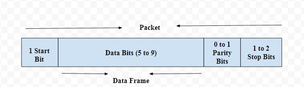

Frame structure
UART transmitted data is organized into packets. Each packet contains 1 start bit, 5 to 9 data bits (depending on the UART), an optional parity bit, and 1 or 2 stop bits:
UART-Communication
IDLE STATUS
High level. Which means there is no data transmission in current path.
START BIT
The UART data transmission line is normally held at a high voltage level when it’s not transmitting data. To start the transfer of data, the transmitting UART pulls the transmission line from high to low for one clock cycle. When the receiving UART detects the high to low voltage transition, it begins reading the bits in the data frame at the frequency of the baud rate.
DATA FRAME
The data frame contains the actual data being transferred. It can be 5 bits up to 8 bits long if a parity bit is used. If no parity bit is used, the data frame can be 9 bits long. In most cases, the data is sent with the least significant bit first.
PARITY
Parity describes the evenness or oddness of a number. The parity bit is a way for the receiving UART to tell if any data has changed during transmission. Bits can be changed by electromagnetic radiation, mismatched baud rates, or long distance data transfers. After the receiving UART reads the data frame, it counts the number of bits with a value of 1 and checks if the total is an even or odd number. If the parity bit is a 0 (even parity), the 1 bits in the data frame should total to an even number. If the parity bit is a 1 (odd parity), the 1 bits in the data frame should total to an odd number. When the parity bit matches the data, the UART knows that the transmission was free of errors. But if the parity bit is a 0, and the total is odd; or the parity bit is a 1, and the total is even, the UART knows that bits in the data frame have changed.
STOP BITS
To signal the end of the data packet, the sending UART drives the data transmission line from a low voltage to a high voltage for at least two bit durations.

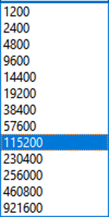

Baud-rate
The frequency modulated in signal in line, expressed in bits per second (bps) or b/s. The clock signal with fixed frequency will vibrate and send one bit data signal each clock period.
band_rate1
It is demanded by UART communication that the both sides should be aligned in baud-rate. However, since the UART is asynchronous, that is to say there is not a clock line to connect each other. As a result, both of them will modulate one equivalent baud-rate according to internal clock theoretically. However, due to the inevitable error in HW itself, the actual baud-rate will not be aligned with theoretical value. While it is demanded that the error in baud-rate of both sides can differ only about 10%, otherwise, the error codes will be read by receiver.

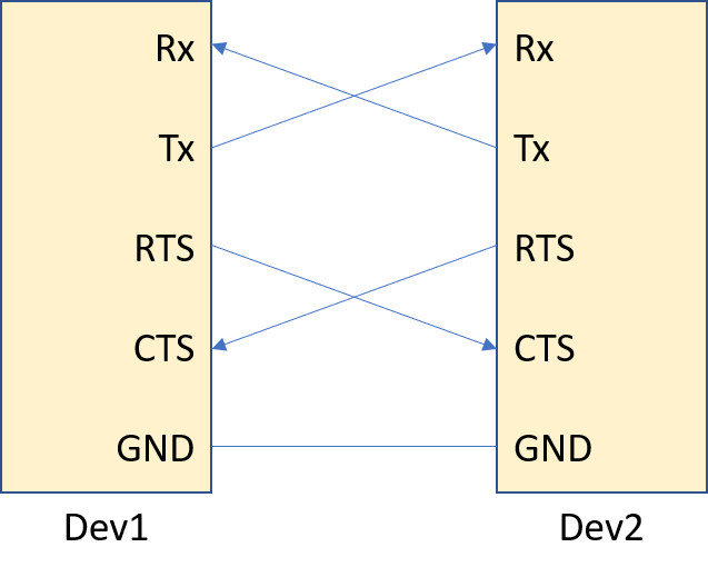

Hardware flow control
Both sides with any communication protocol will be allocated with buffer of limited storage space to receive the data from other side. Once the other party sends data too fast, and processing speed of itself is slow, there may be a serious situation that the buffer is full and cannot be processed, and even data loss.
In this situation, the flow control is extremely important: When the receiver is unable to burden more date, it will notify the transmitter to stop sending data. After that, if it is capable to accept, it will notify transmitter again to transmit data.
uart_control
See above diagram for UART interface of HW flow control pin. Compared with former, two pins namely RTS and CTS are added.
RTS
Output capability, which connects to the CTS of other side. When the RTS of its is pulled high, it will notify the UART of other side to stop transmitting data. Once the RTS goes back to low, it will notify the other side to transmit data again.
CTS
Input capability, which connects to the RTS of other party. When the CTS of its own side detects the high, it will stop transmitting data. Once the low level is detected by CTS of its, it is valid to transmit data.

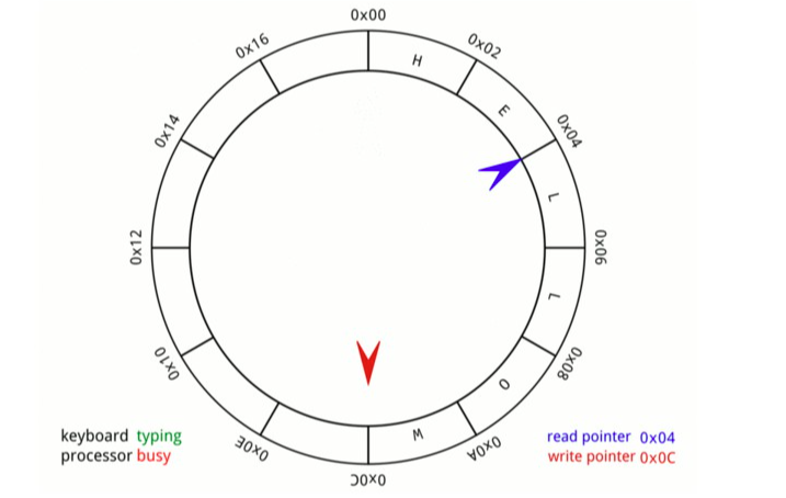

As for SW FIFO, the ringbuffer is widely used.
Compared with linear buffer, there is no need to allocate memory frequently. The repeated usage in memory will allow us to carry out more tasks with fewer memory blocks. Meanwhile, it will be more convenient and safer to manage memory. Normally, the ringbuffer will be used when reading and writing buffer frequently.
ringbuff
The ringbuffer refers to buffer made by a logic ring with head and tail connected instead of that in physical. Since the memory space is made by linear structure, the ringbuffer is still one section of memory with certain length of FIFO actually. Moreover, it has the function of mutually exclusive access of communication processes to the buffer.
Principle
The ringbuffer is endowed with fixed length, as a result, it just needs to adjust the location of head, write pointer and tail pointer that point at this buffer instead of deleting all data when deploying it. The write pointer will point at head pointer first of all (The start location of ringbuffer) and the data will be saved in write pointer. In addition, the location of write pointer will move back for one certain length when one data is stored each time. Once the write pointer points at the tail pointer, it will re-point at head pointer and cover the original location till all data is stored. The benefit of ringbuffer lies in that it will reduce memory allocation, decrease system cost and memory fragment quantity, facilitating long and stable running.
UART-Communication
Generally, one ringbuffer is composed by one consecutive memory space and 4 pointers.
​ head Pointer: Point to the start address of memory
​ tail Pointer: Point to the end address of memory
​ read pointer: Point at the start location where stores data in memory
​ write pointer: Point at the end location where stores data in memory
After applying for memory and pointer definition, see following content on ringbuffer illustration and application.
  • This memory length will be displayed as: Len = tail-head
  • The read pointer refers to the start location of reading data. After reading N data, it is needed to move offset with N length. Also, it is necessary to store the data with addlen into ringbuffer. If it meets addlen + write pointer > tail, the write pointer will store data with len1 = tail - write pointer and go back to head. The remaining data with len2 = addlen - len1 will be stored from head and overwrite the former data.
  • The write pointer refers to the start location of writing data. After storing N data, it is needed to move offset with N length. When it is needed to read data with addlen from ringbuffer, if it meets addlen + read pointer > tail, the read pointer will store data with len1 = tail - read pointer and go back to head. The remaining data with len2 = addlen - len1 will be read from head till the end.

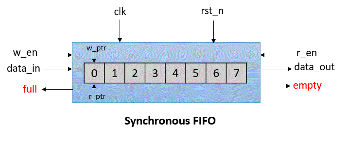

Synchronous FIFO
  • Definition: The read and write of synchronous FIFO are operated in the same clock.
  • Principle: The same clock signal will be used to control the data read and write. Once the new data is written, the write pointer will move; When the data is read, the read pointer will move as well.
  • Application: Commonly used in data flow buffer in the same clock domain.
synchronous-fifo
Write: The FIFO can store or write data in each location of clock according to w_en signal till the data is full. Meanwhile, the write pointer will increment when each data is written into FIFO memory.
Read: It will extract or read data from FIFO in each location of clock according to rd_en signal till the data is empty. Meanwhile, the read pointer will increment when each data is read from FIFO memory.
The read and write pointers will be generated by counting write and read requests in inner FIFO, which indicate the read and write address of memory. To be specific, the write pointer will point at the next address to be written while the read pointer points at the next address to be read. Similarly, the write request will increment write pointer and the read request will increment read pointer.
The module with FIFO will output empty and full signal to indicate its state, which are displayed as fifo_full and fifo_empty. The "fifo_full" means the fifo memory is full and not allowed to write data. While the "fifo_empty" indicates that there is no next valid data could be read in memory.
Reason to generate fifo_full and fifi_empty in synchronous FIFO
When resetting, the read and write pointer in FIFO will turn to zero. In this situation, when pulling up the fifo_empty, it allows to write without reading, once the new data is written, the fifo_empty will be pulled down and allowed to read data. Under the circumstance that the write pointer of fifo points at fifi_depth-1, the write operation will make the write pointer turned to zero and pulled the fifo_full high.
When the write pointer is equivalent to read pointer, the fifo will be either full or empty. Therefore, it is needed to discriminate above two conditions.

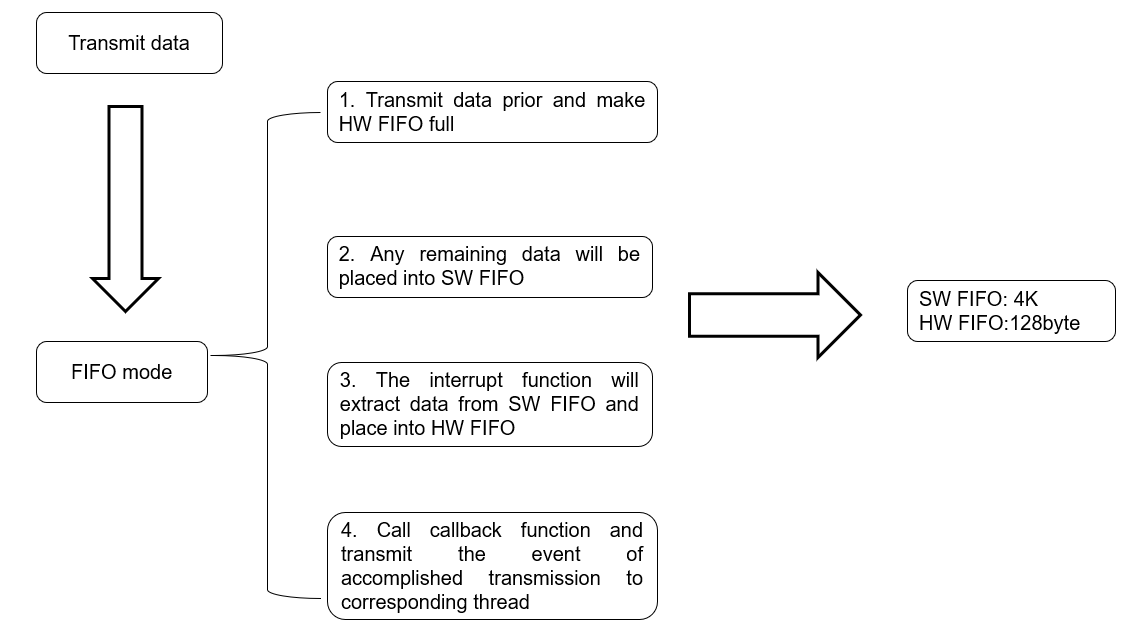

Data flow in Transmitting data
image-20231018145040522
Under the circumstance that the data is invisible in FIFO more than 500ms, the data transmission will be ended.
TX communication: Transmit data -Transmit event once data transmission is complete-trigger interrupt-trigger callback function and transmit event to corresponding thread and process- corresponding thread triggers callback function defined by user.
Only one type can trigger interrupt: TX_COMPLETE.

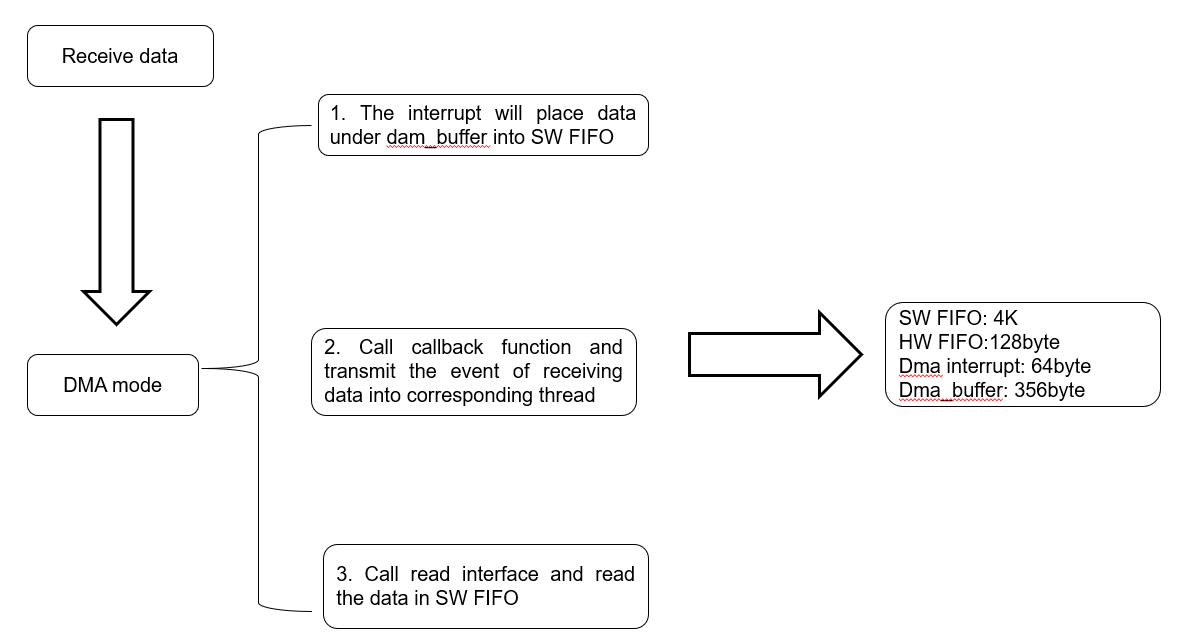

Flow in receiving data
image-20231018144939817
In terms of RX communication, there exist two interrupts -dma (64 bytes are received) OT (In condition that less than 64 bytes are received without triggering dma interrupt for 40ms)
Two kinds will trigger interrupt: RX_ARRIVED and RX_OVERFLOW
In condition that the SW FIFO is full, issues such as data overflow and data loss will occur if it receives more data. Meanwhile, the RX_OVERFLOW event will be reported. Therefore, it is necessary to process the received data, otherwise, it will occur issue such as data loss and incomplete data. For data transmission with large quantity, the HW flow control can be considered.
Rx communication: Receive data for 64 bytes or OT -> trigger interrupt-> trigger callback function and send event to corresponding thread and process-> corresponding thread triggers callback function defined by user.

1. Buffer management: It is vital to manage buffer correctly. If data is not read before being overwritten by new data, there might be a data loss. Therefore, ensure data are read and processed in time before it's overwritten.

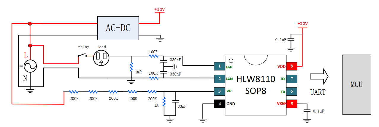

Power meter chip
In this chapter, it will illustrate how to read and write the chip parameters, acquire power data and execute other commands via UART based on HLW8110 Power meter chip.
For specific, please refer to HLW8110 Datasheet.
For raw codes, please refer to hlw8110.py
HLW8110 Description:
  • Targeted to single-phase application, the HLW8110 is a high precision power metering IC with CMOS.
  • It can measure line voltage and current, and calculate active power. Additionally, it can measure apparent power and Power Factor.
  • HLW8110 has three detection channels of ∑-Δ type and one high-precision power meter kernel, including current detection channels A and B, and voltage detection channels. A channel and B channel can be used for current detection at the same time. B-channel can be used for current detection or leakage detection. The individual input channel supports flexible PGA settings. Therefore, the HLW8110 can adapt to different sensors such as CT and Shunt with low resistor.
  • HLW8110 is capable to access to on-chip register via UART interface.
  • HLW8112 contains two configurable pulse output pins, which can be used to acquire over-current, over-voltage, zero-crossing voltage or current detection and leakage detection through INT1 and INT2 pins.
  • HLW8110 power metering IC uses 3.3V or 5.0V power supply with Internal Frequency Oscillator. HLW8110 is encapsulated with SOP8 or SSOP16.
Typical Application
HLW8100_application
Operating procedure
  1. Analog measurement:
    The HLW8110 will connect with external current sensor and voltage sampling circuit to acquire the analog signal of current and voltage.
  2. Analog to Digital channel:
    The analog signal will be converted into digital signal via ADC.
  3. Digital process:
The inner chip will process the digital signal converted by ADC and calculate the active power, reactive power and Power Factor.
  1. Output:
    The HLW8110 will provide pulse output related to measured parameter via specialized output pin. In addition, these pulses can be read by external micro-controller and processed further.

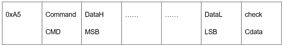

Communication
The UART communication format of HLW8110 is as follows:
HLW8110_communication_format
  • UART command register is the same as SPI, and it's also an 8 bit wide register. For the read-write operation, the command register bit7 is used to determine whether the type of data transmission operation is read operation or write operation. For special command operations, bit7-0 of the command register is fixed to 0xEA.
  • UART data transmission of HLW8110: Read operation is sent by slave and write operation is sent by host. If the register address corresponds to a multi-byte register, the highest valid byte is passed first.
  • UART data verification mode of HLW8110: read operation is sent by slave and write operation is sent by host.
  • Calculating methods of calibration data are as follows: Check data Cdata [7:0] = A5 + CMD [7:0] + DATAn [7:0] +... + DATA1 [7:0], which adds CMD and data, discards carry, and the final result is reversed bit by bit.
Command name Command Register Data Description
Read command {0[bit7],REG_ADR[bit6:bit0]} RDATA Read data from registers with REG_ADR [6:0] The highest bit is 0, which means reading data to registers.
Write command {1[bit7],REG_ADR[bit6:bit0]} WDATA Write data from registers with REG_ADR [6:0] The highest bit is 0, which means writing data to registers
Write enable command 0xEA 0xE5 Enable write operation
Write protection command 0xEA 0xDC Close write operation
Channel A select 0xEA 0x5A Current channel A setting command specifies the current signal used to calculate apparent power, power factor, phase angle, instantaneous apparent power and active power overload as channel A
Channel B select 0xEA 0xA5 Current channel B setting command specifies the current signal used to calculate apparent power, power factor, phase angle, instantaneous apparent power and active power overload as channel B
Reset instruct 0xEA 0x96 Reset instruct, chip reset after receiving instruction
In stage of UART operation, if the Rx keeps LOW or the HIGH surpasses 9.15ms, it is available to reset UART module. Normally, it will not rewrite the register value that has been written into inner chip. When conducting UART communication between MCU and HLW8110/HLW8112, please try reset UART module if it occurs exception in receiving data.
