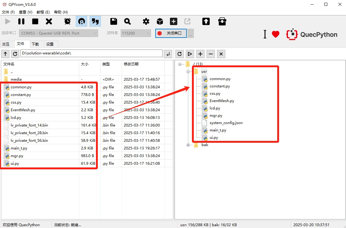

Script import and execution
  1. Refer to this chapter To transfer files between modules, import all files ending in '. py' from the 'code' folder in the source code directory into the module file system, as shown in the following figure:
  2. Refer to this chapter, execute the main program file main_t.py

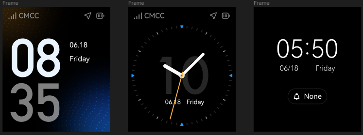

watch dial
component:
  1. Universal Headboard:
  • Signal display.
  • The operator displays.
  • Battery level display.
  • Navigation icon display.
  1. Dial content:
  • Time display: Real time refresh of time.
  • Hour hand/minute hand/second hand: Real time linkage with time.
  • The current time on the background disk is displayed on the clock.
  • Date display: The date is refreshed in real-time.
  1. Interaction Relationship:
  • Swipe left on the digital dial to enter the screen display interface, and swipe right to enter the schedule dial interface.
  • Swipe left on the pointer dial to enter the digital dial interface, swipe right to enter the application list 1 page
  • The device (entered without any operation within 30 seconds) will display an off screen interface. Right swipe to enter the dial interface

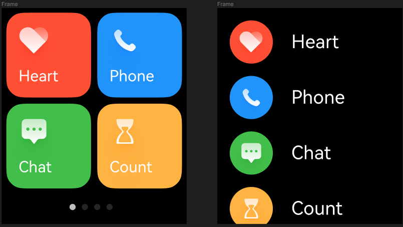

App screens
  1. Heart rate monitoring:
  • Click to jump to the heart rate detection page.
  1. Phone:
  • Click to enter the phone dialing interface.
  1. WeChat:
  • Click to enter the WeChat interface for sending and receiving voice messages.
  1. Countdown interface:
  • Click to enter the countdown interface.
  • Right swipe on the application list interface to enter the application list 2 interface.
  • Swipe left on the application list 2 interface to enter the application list interface, and swipe right to enter the heart rate detection and other interfaces.

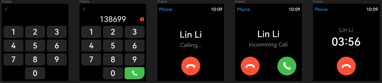

Phone screen
Provides modes and displays for making phone calls, going/calling/calling, etc.

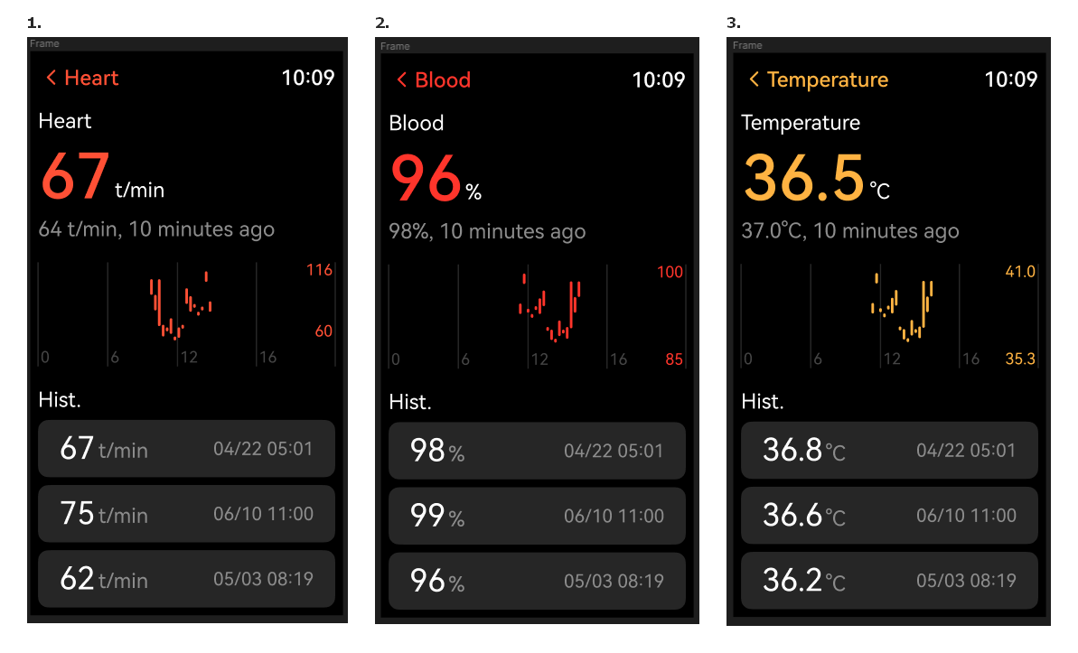

Detection screen
The detection interface includes temperature/blood oxygen/heart rate detection, as well as display of detection status and historical detection.
