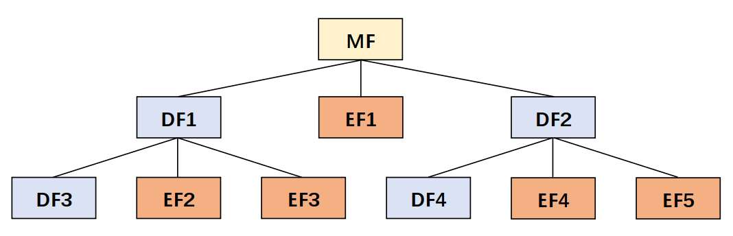

The structure of the SIM card file system is as follows:
As shown, the SIM card file system is a tree structure that includes the following types of files:
MF (Master File): This is the root of the file system and there is only one MF in a SIM card. It contains various DFs and EFs.
DF (Dedicated File): This is the next level in the file system and can be seen as folders. Each DF contains a group of related EFs. For example, there may be a DF for storing the phonebook, which contains EFs for storing individual phone records. Common DFs include DF-GSM, DF-TELECOM, and ADF.
EF (Elementary File): EF is the basic file used to store data. Each EF has a specific format and length for storing specific data. For example, there may be an EF for storing the IMSI (International Mobile Subscriber Identity), which can only be read by the device after selecting this EF.
In the SIM card file system, all files (including folders) have an ID, which is a two-byte hexadecimal number. The file ID is used as a parameter when the device sends a SELECT command to choose a file. To locate a specific file, the MFID, DFID, and EFID need to be determined. Once these IDs are determined, it is equivalent to determining the absolute path of a file.

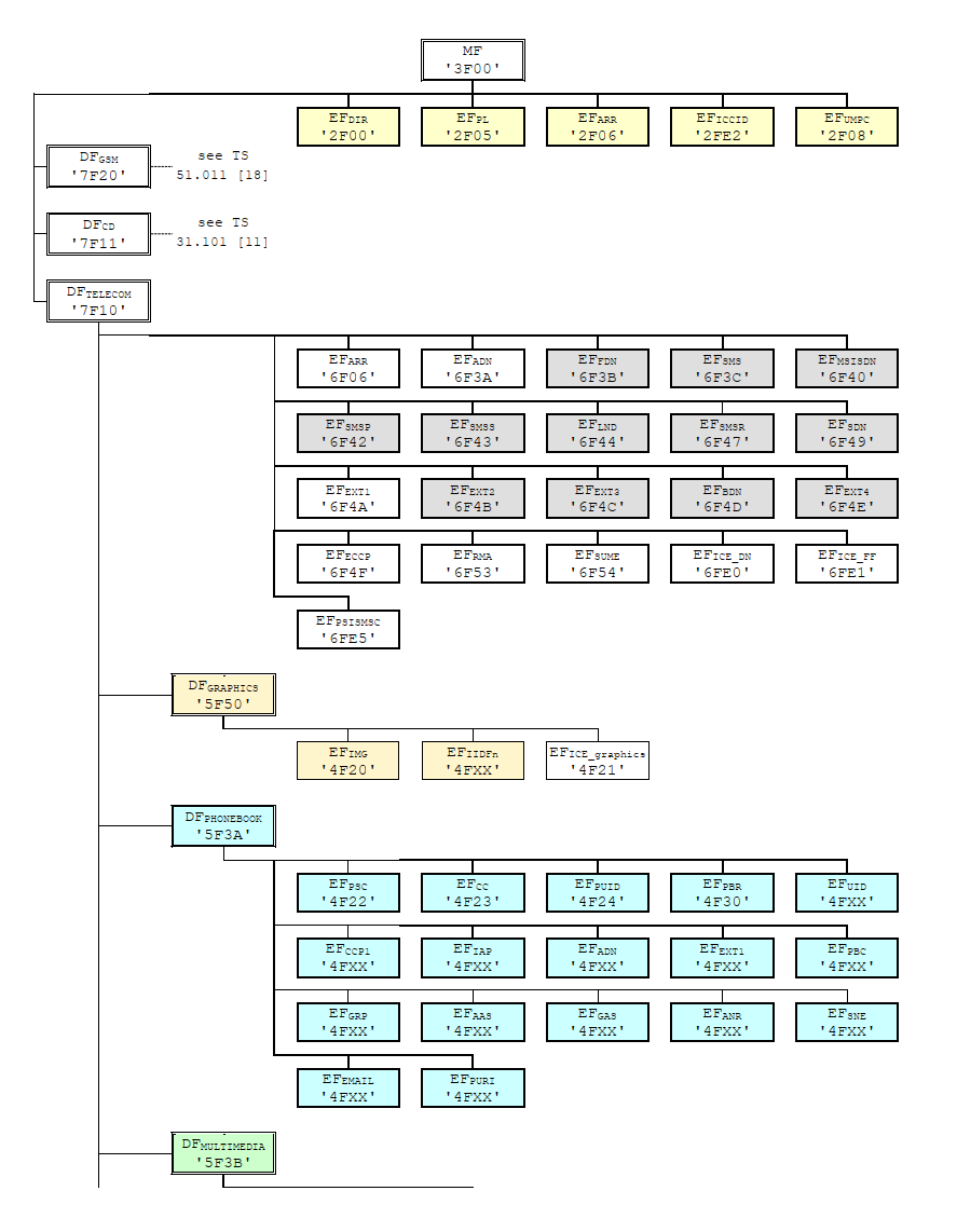

Taking USIM as an example, referring to the 3GPP TS 31.102 protocol document, the USIM file system is defined as follows:
From the above diagram, it can be seen that each file has an ID, and the uniqueness of the file ID depends on its position in the file system tree. The file IDs of all direct child files (DF or EF) under the same parent file (DF or MF) are unique and cannot be repeated. In other words, there cannot be two files with the same file ID under the same DF. However, files with the same file ID can exist in different DFs. Therefore, to uniquely identify a file, it is necessary to specify the path from MF through which DFs can be reached to this file, and this path, along with the file ID, can uniquely determine a file.
