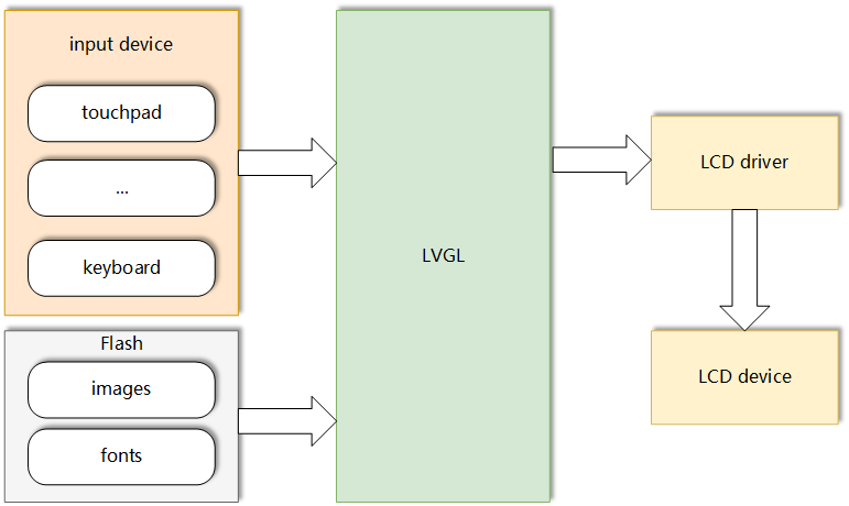

Association of LVGL and Display Device
LVGL refreshes the drawn graphics data to the LCD through the registered LCD driver. The LCD, as the display device, is responsible for displaying the content of the graphical interface on the screen. The LCD driver acts as a bridge between LVGL and the LCD. It receives the graphics data generated by LVGL and efficiently transfers it to the LCD for display. In this way, the LVGL establishes a close connection with the LCD, allowing you to easily create beautiful and highly interactive embedded user interfaces using the functionality and flexibility of LVGL, and display and update the UIs in real time on the LCD.

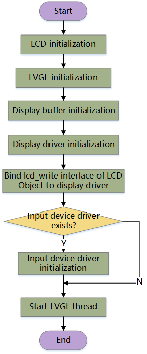

Initialize LVGL
Workflow Description
The LVGL initialization process is as follows:
- Properly initialize the LCD. Please refer to LCD - LCD Driver for details.
- Initialize the display buffer.
- Initialize the display driver and bind the refresh API as the write interface of the LCD.
- If there are input devices such as TP, initialize the TP.
- Initialize the input device driver.
- Start the LVGL thread.
The following diagram shows the LVGL initialization process:

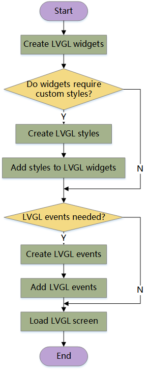

The LVGL drawing process is as follows:
- Create LVGL widgets.
- If custom styles are required, create LVGL styles.
- Add styles to LVGL widgets.
- If custom events are required, create LVGL event callback functions.
- Bind event callback functions to LVGL widgets and specify the triggering event types.
- Load the interface and start the GUI display logic.
The following diagram shows the LVGL drawing process:

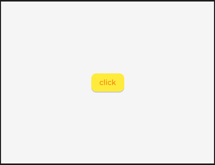

Sample Code
The following is an example in which an interface has been created and a clickable button has been created on the interface.
import lvgl as lv
# LVGL initialization is omitted.
#----------script start----------
# Create an interface.
screen = lv.obj()
# Create a button.
btn1 = lv.btn(screen)
# Set the position of the button.
btn1.center()
# Add text to the button.
label = lv.label(btn1)
label.set_text("click")
# Create a style.
style_btn = lv.style_t()
style_btn.init()
# Set the background color.
style_btn.set_bg_color(lv.palette_main(lv.PALETTE.YELLOW))
# Set the font color.
style_btn.set_text_color(lv.palette_darken(lv.PALETTE.YELLOW, 4))
# Add the style to the button.
btn1.add_style(style_btn, 0)
# Define event callback function.
def event_handler(evt):
code = evt.get_code()
if code == lv.EVENT.CLICKED:
print("Clicked event detected")
# Add the event (triggered when clicked) to the button.
btn1.add_event_cb(event_handler, lv.EVENT.CLICKED, None)
# Load the interface.
lv.scr_load(screen)
Note:
- You can only create an LVGL object after the LVGL thread starts, otherwise, errors may occur.
- LVGL drawing process can be interleaved with the display or can be dynamically drawn and displayed in real time during the display process.
Display Effect
The running result of the above sample code is shown in the following figure.
LVGL Interface Display
