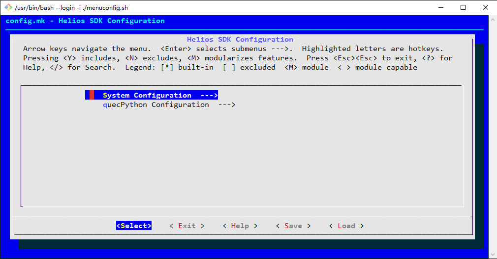

Enter helios menuconfig [module] in the command line to start the configuration menu, as shown in the figure:
module is the current module used, such as EC200UEU_AB. At this time, the configuration command is: helios menuconfig EC200UEU_AB.
As shown in the figure above, menuconfig consists of four parts: Title, Usage Instructions, Menu List, and Operation Keys.
  • Title: The light blue text on the top of the dark blue background in the figure above, saying config.mk - Helios SDK Configuration.
  • Usage Instructions: The three rows of text in the gray background at the top of the figure. It guides users on how to operate menuconfig.
  • Menu List: The two rows of text in the gray background within the recessed frame in the figure above, saying System Configuration ---> and EC200UEU_AB --->.
  • Operation Keys: The bottom row in the figure, enclosed in angle brackets, namely <Select> < Exit > < Help > < Save > < Load >.
The menu list varies depending on the configured module, taking EC200UEU_AB as an example.

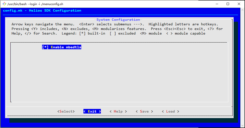

For example, press the " Enter" key to enter System Configuration, and you can see that the mbedtls function is enabled, as shown in the following figure:
In the [*] Enable mbedtls menu, the * in the square brackets indicates that the mbedtls function is enabled. The asterisk * disappears after pressing the "Space" key, indicating that the mbedtls function is disabled.

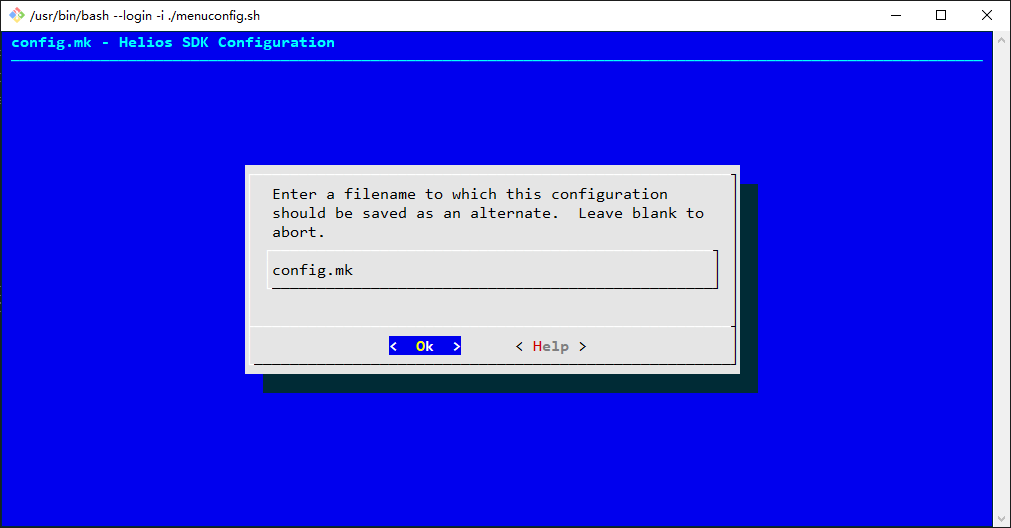

1.1.3 Saving Configuration
After modifying the configuration(s), you can save the configuration(s) in the following three ways.
  • i. In the configuration menu interface, select <Save> at the bottom of the interface with the left and right key, and press the " Enter" key. After the pop-up interface shown in the figure below appears, select <OK> to save the configuration.
The name of the configuration file shall not be modified, because other script files search for the configurations based on this configuration file name. Once the name is modified, the configuration file will not be found.
  • ii. In the configuration menu interface, press the Esc key multiple times until menuconfig exits. When exiting, if there are unsaved configuration items detected, the interface for saving the configurations shown in the figure above will pop up. Follow the operation in *Item i* to save the configuration.
  • iii. In the configuration menu interface, select and execute <Exit> function repeatedly until menuconfig exits. When exiting, if there are unsaved configuration items detected, the interface for saving the configurations shown in the figure above will pop up. Follow the operation in *Item i* to save the configuration.
1.1.4 Canceling Configuration Saving
After entering the interface for saving the configurations shown in *Section 1.1.3, if you need to cancel saving the configuration, double-click the "Esc*" key.

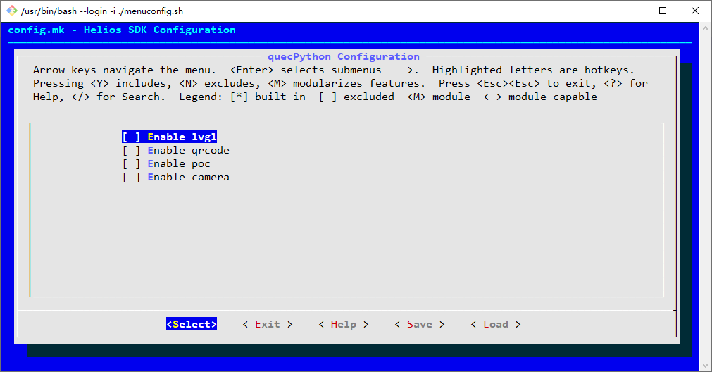

The QuecPython configuration menu is shown in the following figure:
These four types of functional menus are used to configure whether the QuecPython firmware includes the lvgl interface, QR code scanning, intercom, camera and other functions.

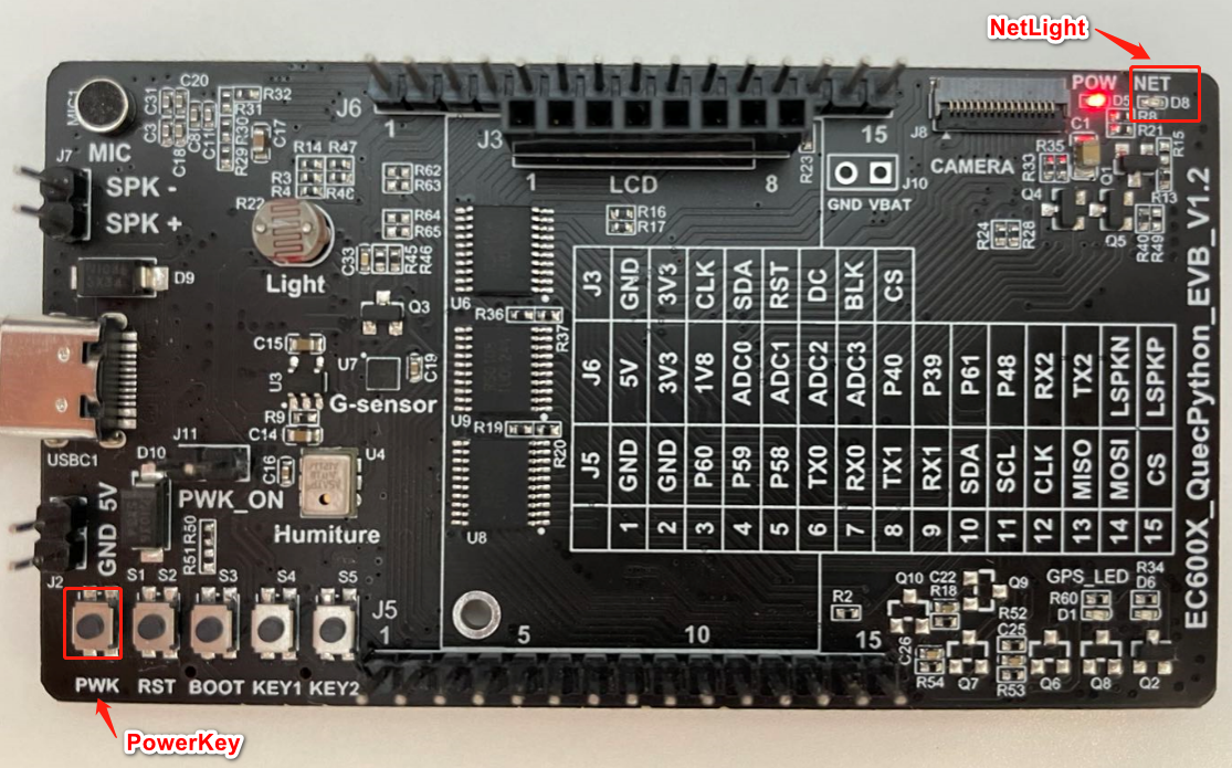

As shown in the figure below, press and hold the PWK button in the lower left corner on the back of the EVB to power on the module and start the program in the EVB.
If the network indicator on the upper right corner on the back of the EVB flashes, it indicate that the module is powered on successfully.
Instructions on buttons of EVB:
PWK: Power button, long press to power on
RST: Reset button, press to reboot the module
BOOT: Press to enter firmware flashing mode
KEY1, KEY2: Buttons provided for user development

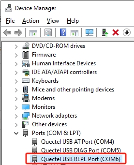

Step 3: Open the Quectel USB REPL Port
Open the Device Manager, expand Ports, and find the Quectel USB REPL Port (COM6). Take note of its serial port number. In this example, it is COM6, as shown in the following image:
Refer to *Section 7* in Helios SDK Quick Start - Getting Started for instructions on how to open COM6.

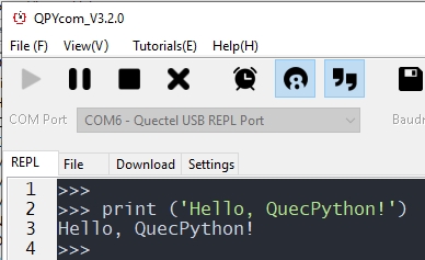

Press the " Enter " key in the REPL window of QPYcom, and the QuecPython command prompt >>> will be displayed on the interface.
Now, let's print through the print function in QuecPython. Type the following code in SecureCRT:
print ('Hello, QuecPython!')
The execution result is shown in the following image:
Now, we have developed our first simple application with QuecPython.
