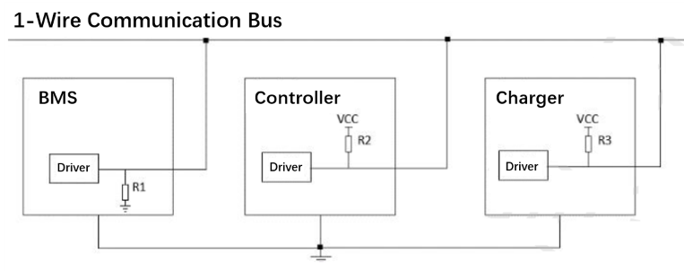

- It's a single-wire, master-slave, one-direction communication protocol. Similar but different from the 1-Wire protocol. One-direction means that a device can either be a sender or a receiver. For example, in the above figure, "BMS" is the sender, "Controller" and "Charger" is the receiver;

Master (BMS) output is pulled-down. Normally there's internal pull-down resistor in the IO or you can add an external one. But the slave (receiving end) should be pulled-up by default. At 5V, the pull-up resistor should be 2.2K. And at 3.3V, the resistor should be 1K.

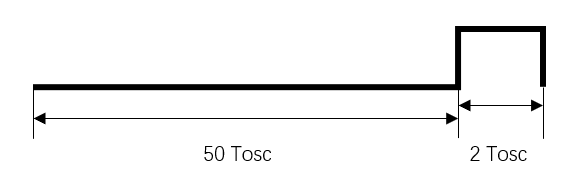

Sync signal:

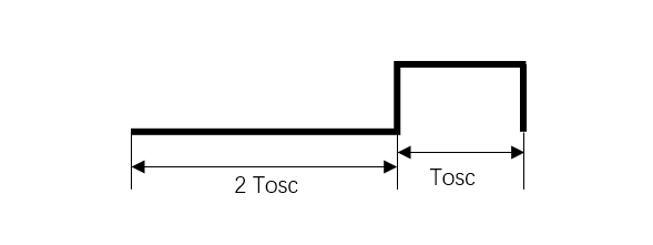

Bit(0):
Bit(1):

- 32Tosc has a range of 0.5ms. It should not exceed 1ms for sake of the response time.
- Sync signal: >992Tosc of LOW + 32Tosc of HIGH. Idle bit time > 15ms (0.5ms*992/32=15ms)
- Data bit logical 1 should meet: HIGH time > LOW time + 0.5ms
- Data bit logical 0 should meet: LOW time > HIGH time + 0.5ms
- The high and low levels will be 0.5ms and 1ms respectively, and the duty cycle is 1:2 (75% is appropriate).

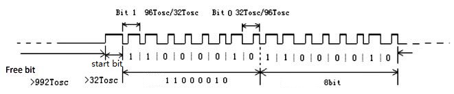

Examples:
Send two bytes of data: 11000010, 11000010 (Binary)

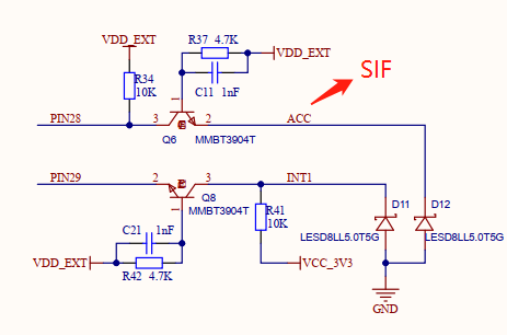

Hardware
For reference only since it shall rely on specific device.
